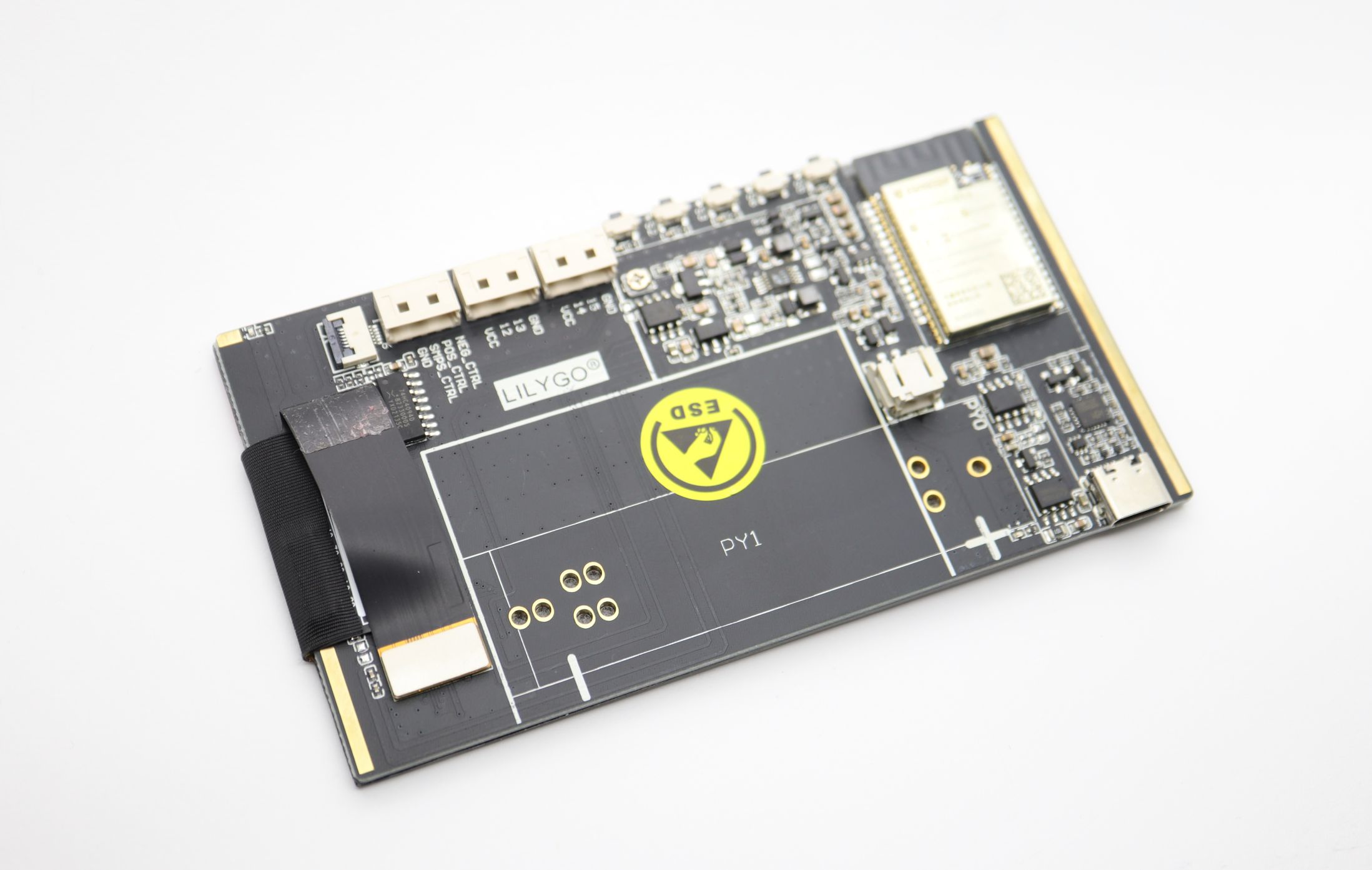

The LILYGO T5 4.7 inch E-Paper ESP32 Development Board is an exciting 4.7" e-paper display integrated with an ESP32 WiFi/Bluetooth module. The board's processor is ESP32-WROVER-E with 16MB of FLASH memory and 8MB of PSRAM.

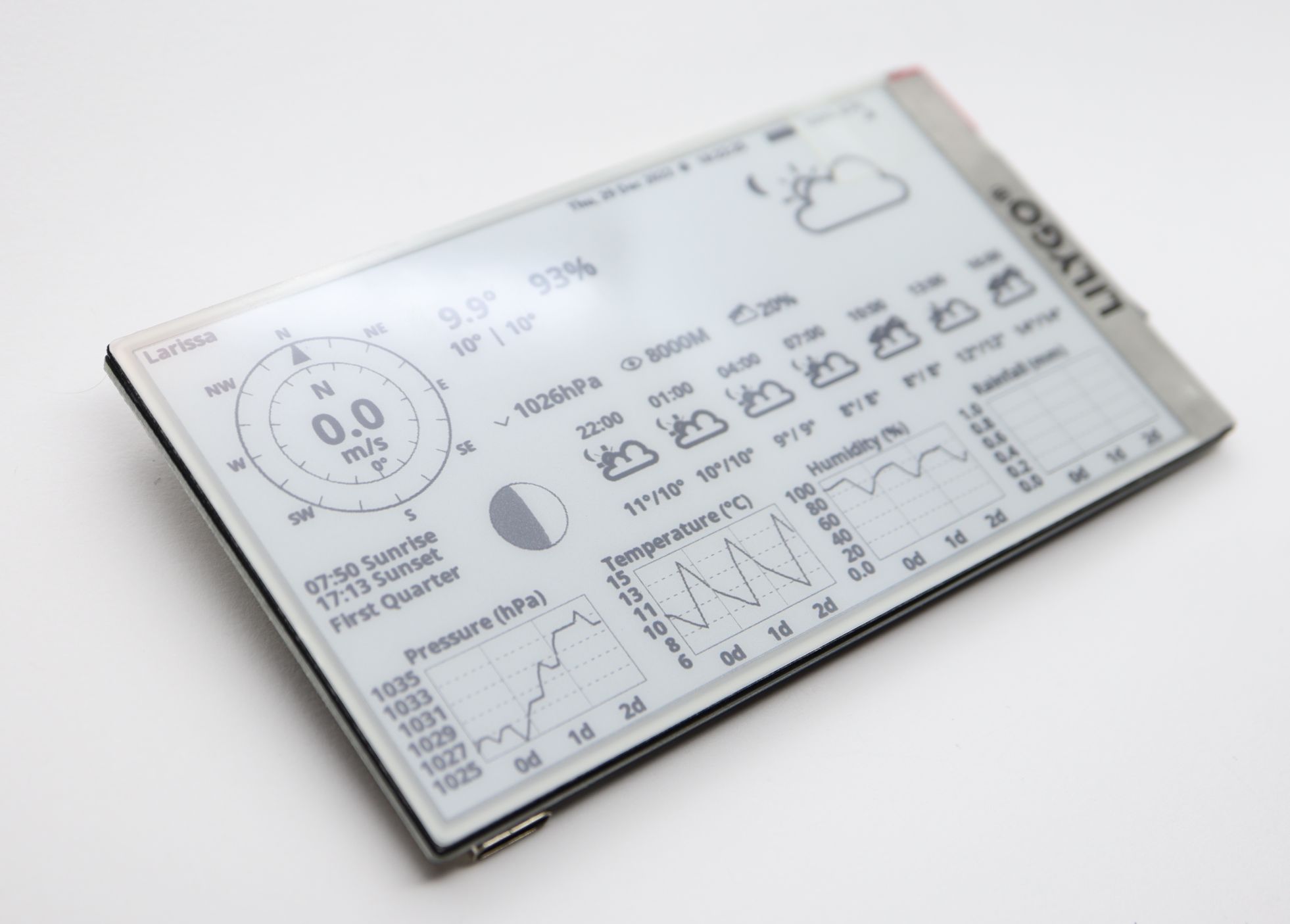

The LILYGO T5 4.7 inch E-Paper ESP32 Development Board is an exciting 4.7″ e-paper display integrated with an ESP32 WiFi/Bluetooth module. The board’s processor is ESP32-WROVER-E with 16MB of FLASH memory and 8MB of PSRAM. The ESP32 module supports Wi-Fi 802.11 b/g/n and Bluetooth V4.2+BLE and can easily be programmed with Arduino IDE, VS Code, or ESP-IDF. The board can be purchased on Aliexpress for 56.65 EUR + shipping or Tindie for 39.40 USD + shipping. This display is ideal for building a weather station that fetches weather data from OpenWeatherMap via simple API usage. So in this tutorial, we will follow the steps to make a weather station like the photo above. We will work on a Windows PC to program the display, but the same can be done in Linux or Mac OS.

  • MCU: ESP32-WROVER-E (ESP32-D0WDQ6 V3)
  • FLASH: 16MB
  • PRAM: 8MB
  • USB to TTL: CP2104
  • Connectivity: Wi-Fi 802.11 b/g/n & Bluetooth V4.2+BLE
  • Onboard functions: Buttons: IO39+IO34+IO35+IO0, Battery Power Detection
  • Power Supply: 18650 Battery or 3.7V lithium Battery (PH 2.0 pitch)
  • Driver IC: GDEH0213B72
  • 4.7 inches, 540(H)X960(V) resolution, , supports partial refresh
  • 6pin FPC touchscreen expansion connector
  • 16 Gray Level ED047C1
  • 4-pin 2.0 Molex 4 p 53015-0410 x 3
  • RST button x 1
  • Custom button x 3
  • USB: TYPE-C
  • Battery charge and discharge protection chip
  • USB input power 5V@1A
  • 4pin expansion interface output is 3.3V
  • Sleep mode current@~170uA

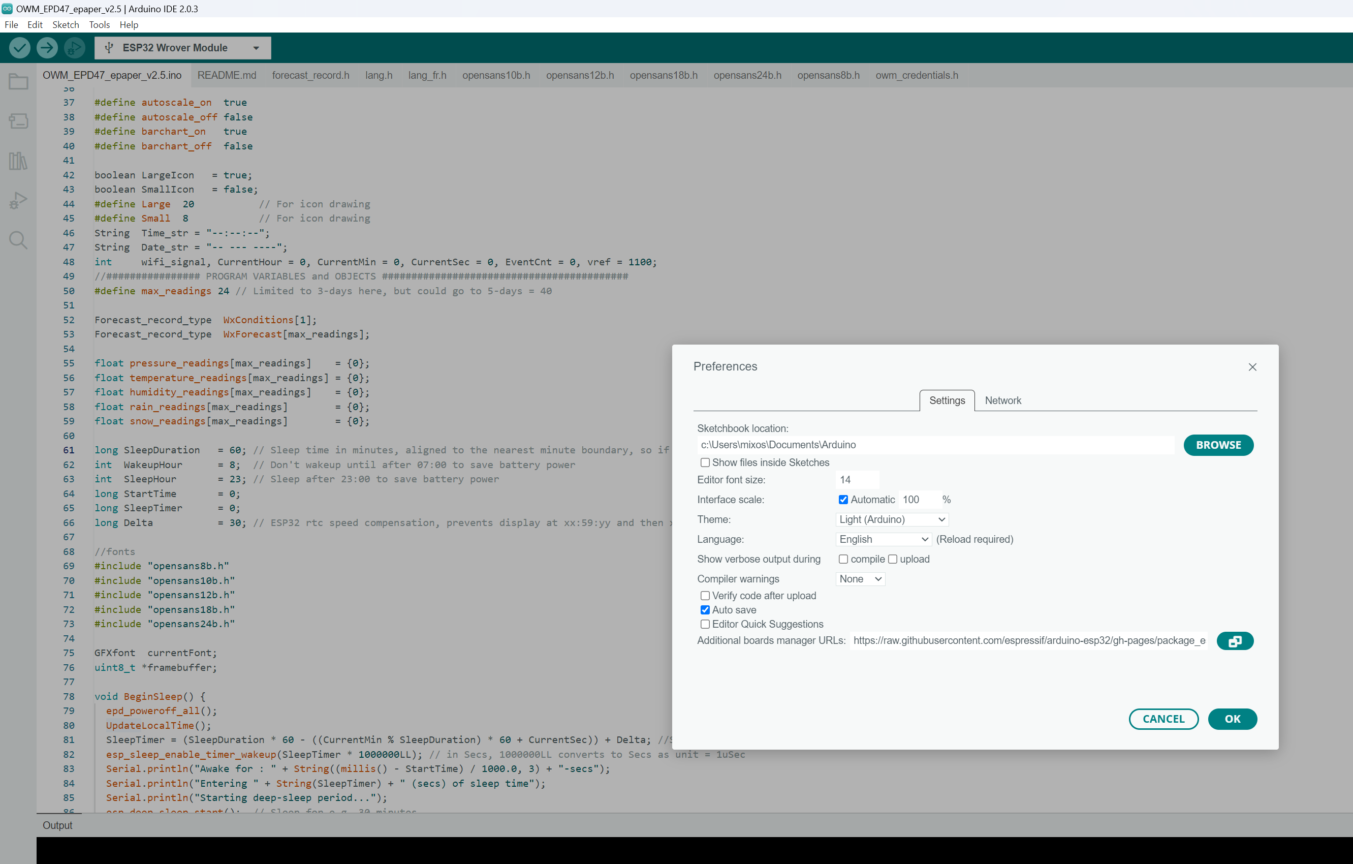

Add ESP32 boards support
Click File, click Preferences, and select the Settings tab. Enter the following URL to Additional boards manager URLs: https://raw.githubusercontent.com/espressif/arduino-esp32/gh-pages/package_esp32_index.json
Click Ok.

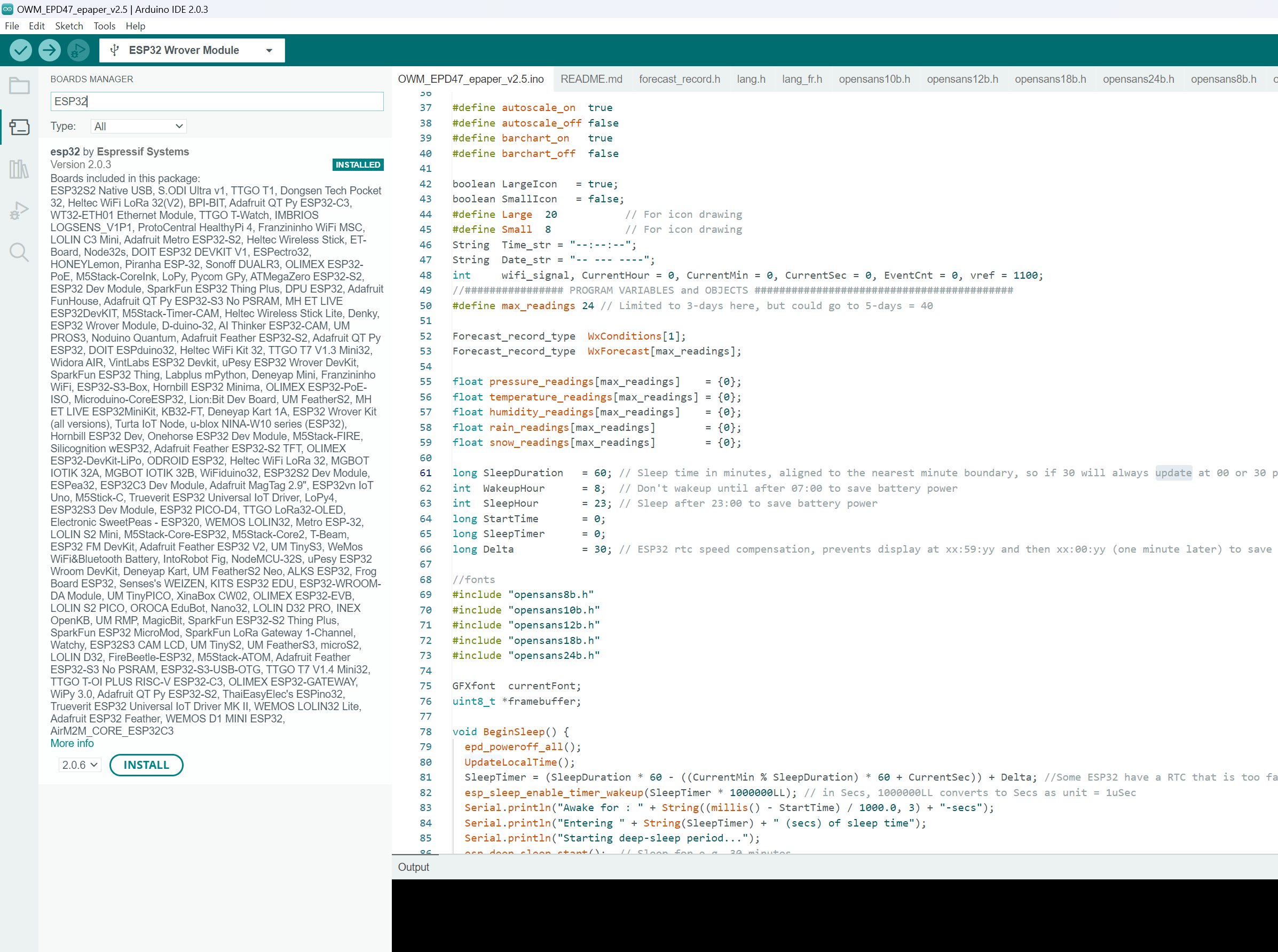

Next click Tools, and select Boards:  -> Boards Manager . It will open the left pane with a list of boards. Type ESP32 into the search field. Find ESP32 by Espressif Systems, and click Install.

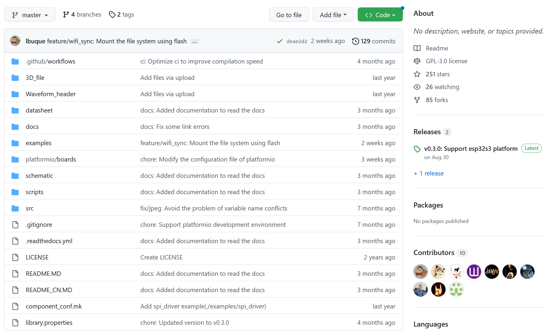

Download LilyGo-EPD47 library to the C:\Users\YOUR_USERNAME\Documents\Arduino\libraries folder on your system:
Download and extract LilyGo-EPD-4-7-OWM-Weather-Display to your directory with Arduino projects. This directory is normally located in C:\Users\YOUR_USERNAME\Documents\Arduino.

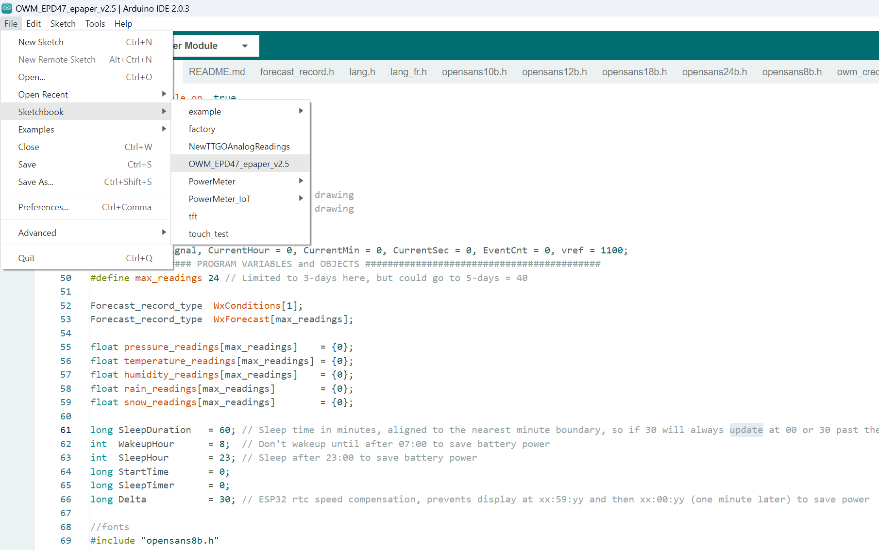

Open Arduino IDE 2.0, click File, -> Sketchbook, -> OWM_EPD47_epaper_v2.5.

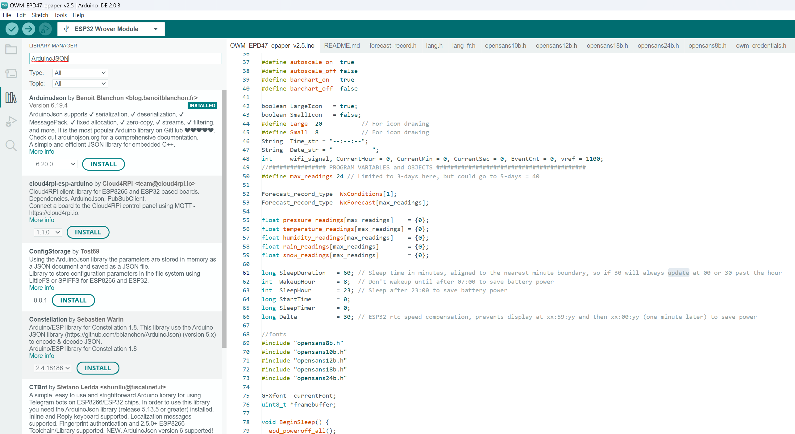

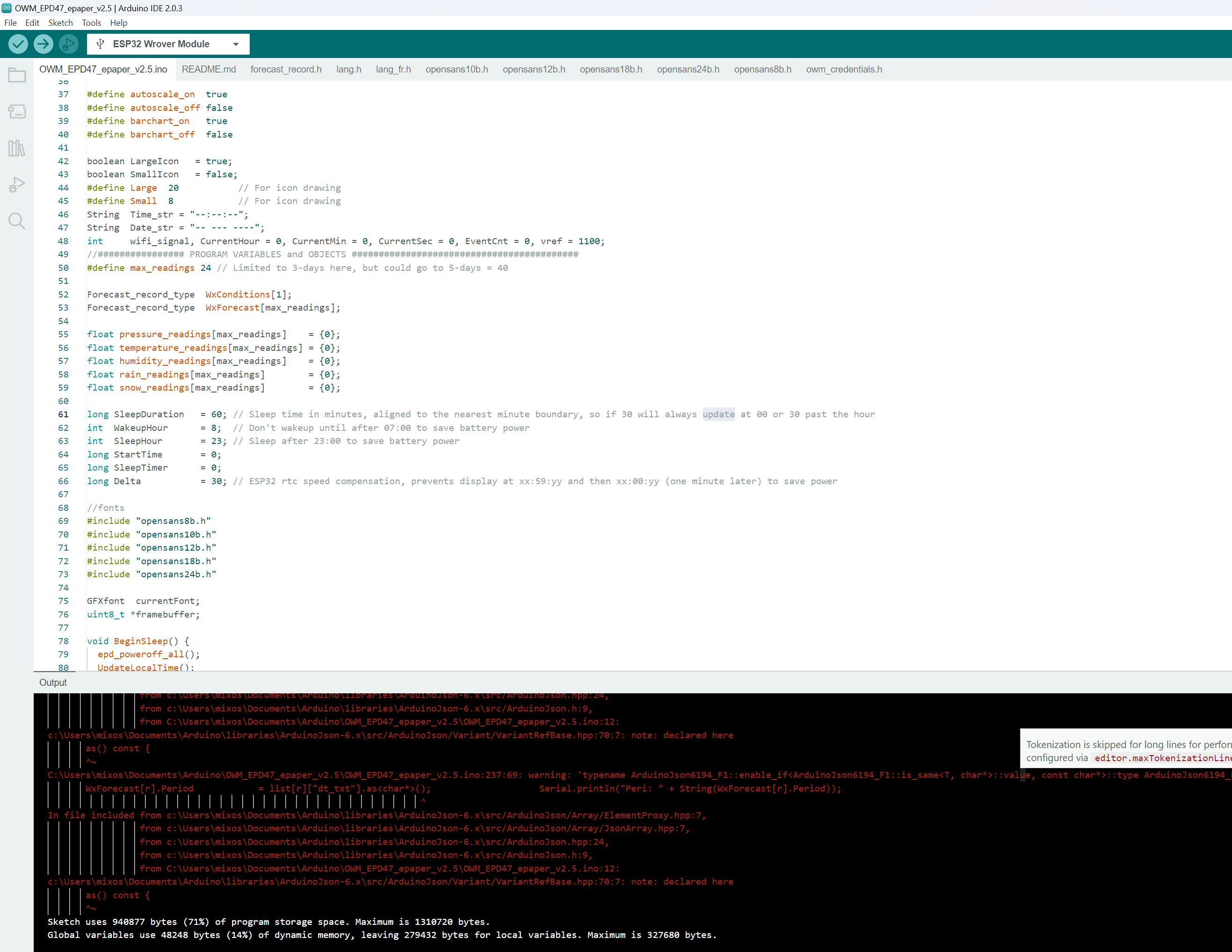

The sketch requires ArduinoJson Library to successfully build.
Click Tools, ->Manage libraries. The pane with Library Manager will open, then type ArduinoJson into the search field. Find ArduinoJson by Benoit Blanchon, click Install.
Then click the tick button on the top menu to compile the code. If everything is successful it should show:

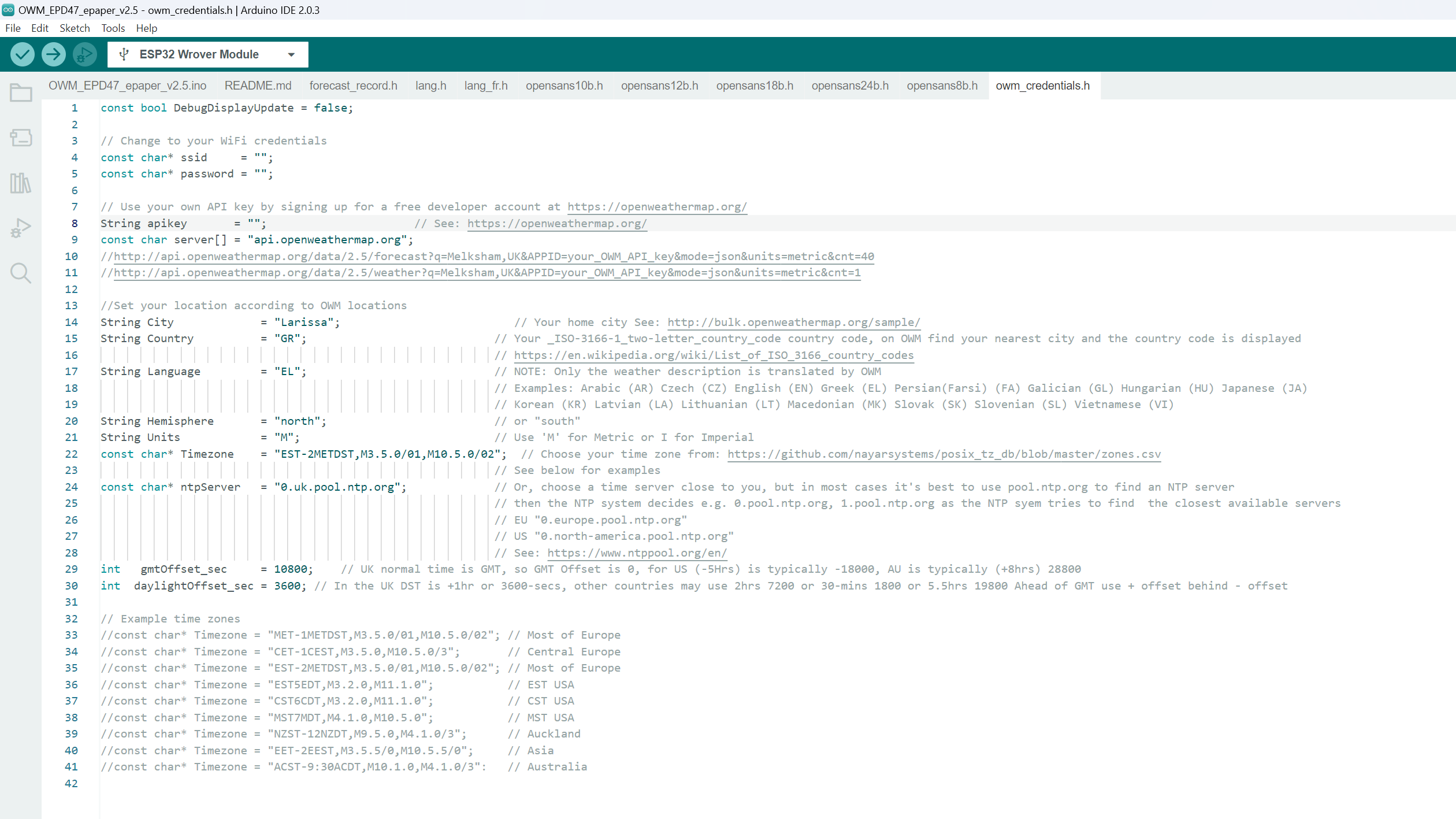

Open the file owm_credentials.h and configure ssid, password, apikey, City, and Country.
The project is fetching data from openweathermap.org so you will need to create a new free account in order to get API key.

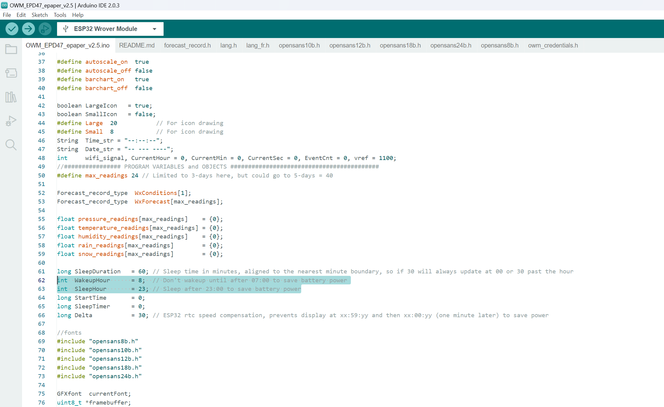

Power Saving
The project code supports power saving, so if you’re flashing in the early before 08.00 or after 23.00, you might notice that nothing appears on the display.

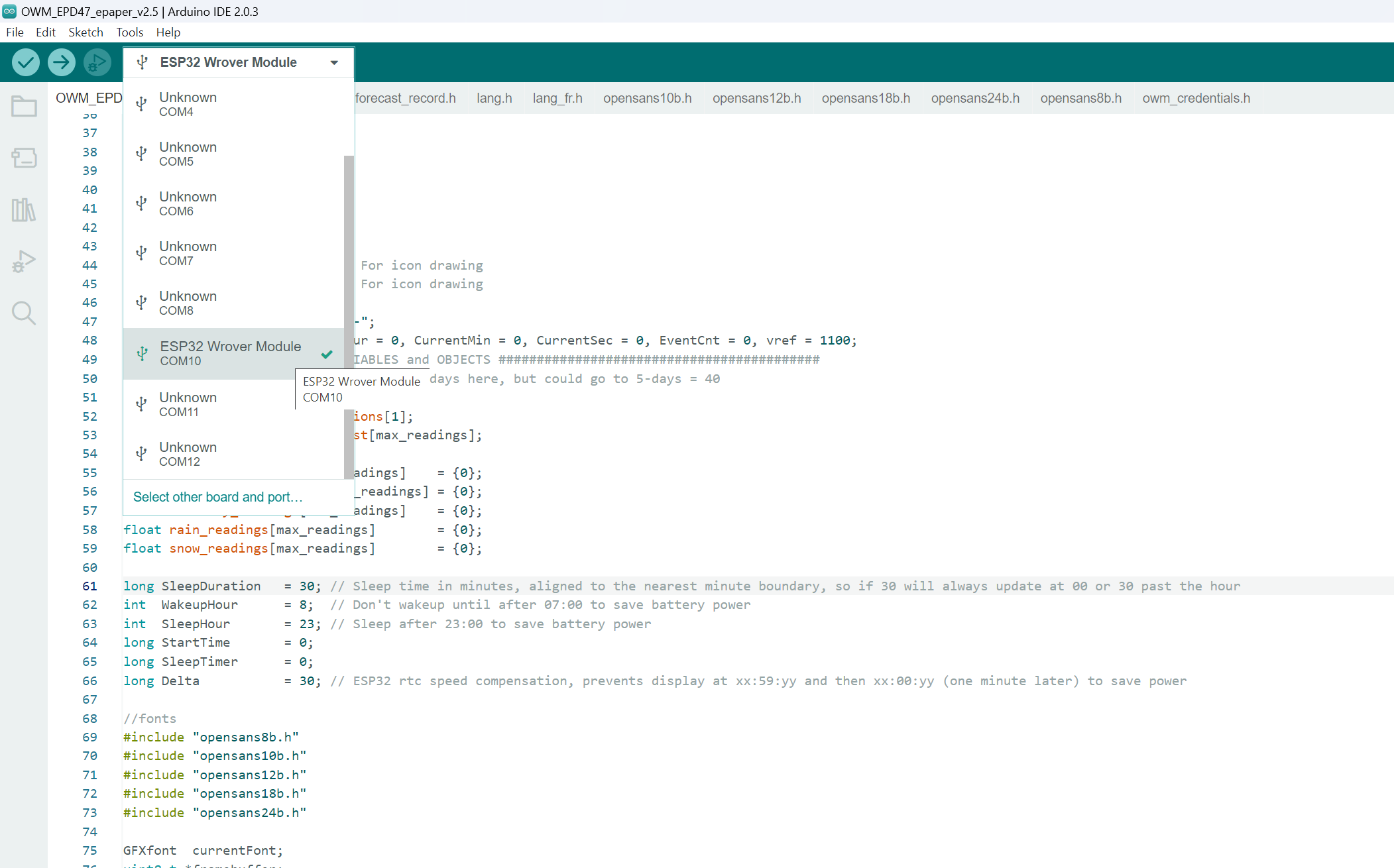

To change the power-saving options open file OWM_EPD47_epaper_v2.5.ino and change WakeupHour and SleepHour to a value that suits your schedule.
Uploading the Code
Connect the LilyGO T5 4.7-inch e-paper display to your PC-> Select the board from the dropdown in the toolbar. Search for the ESP32 Wrover module and click Ok.
Click the Upload button.

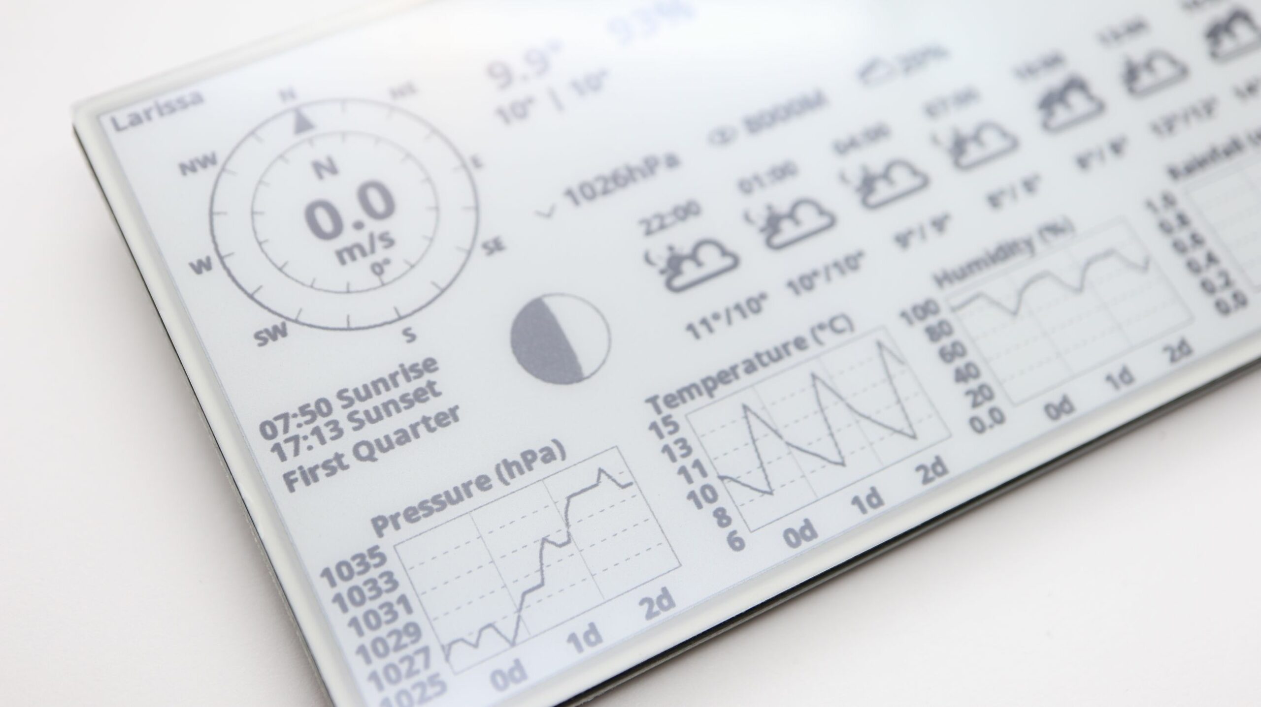

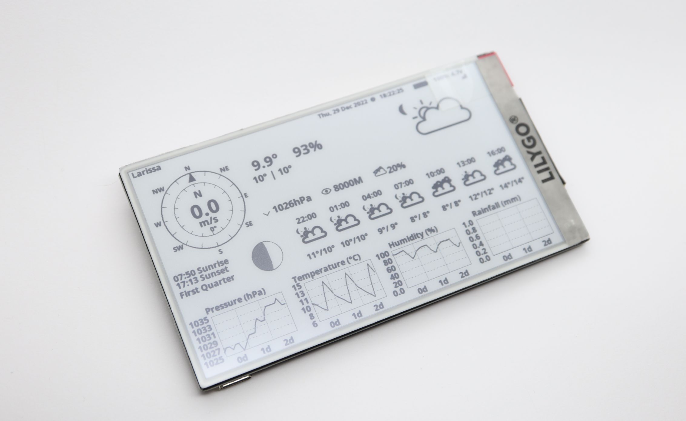

If the flashing is successful, your weather will be displayed on the e-paper like the photos below.

Brad
Only works with ArduinoJson version=6.19.4 and below.

anyone found similar problem while compiling?
Compilation error: ‘class WiFiClass’ has no member named ‘setAutoConnect’; did you mean ‘setAutoReconnect’?
followed strictly your manual and can`t find what is the issue
Mo Wie
Hello, i get the error:
'class WiFiClass' has no member named 'setAutoConnect'; did you mean 'setAutoReconnect'?
Its mentioned here that WiFi.setAutoConnect is depricated and WiFi.Begin() should be useed instead.
Commenting out the line calling WiFi.setAutoConnect lets the compilation continue (not sure if it solves the problem or if WiFi is working. In the thread linked above its mentioned that WiFi is NOT connecting).
Anyway, several other errors pop up:
error: invalid conversion from ‘int*’ to ‘int32_t*’ {aka ‘long int*’} [-fpermissive]
 1037 |  get_text_bounds(&currentFont, data, &xx, &yy, &x1, &y1, &w, &h, NULL);
