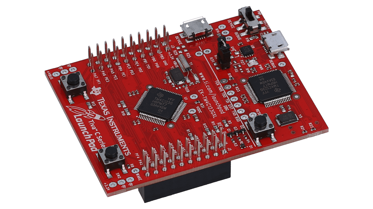

In our case, we’ll be using a basic microcontroller board TM4C123GXL, which has the same properties as an STM Nucleo Board. TI Boards for this series are termed as ‘Launchpad’ due to their ability to support other booster drivers and boards that’ll give extra support to provide more features.
Hardware Section

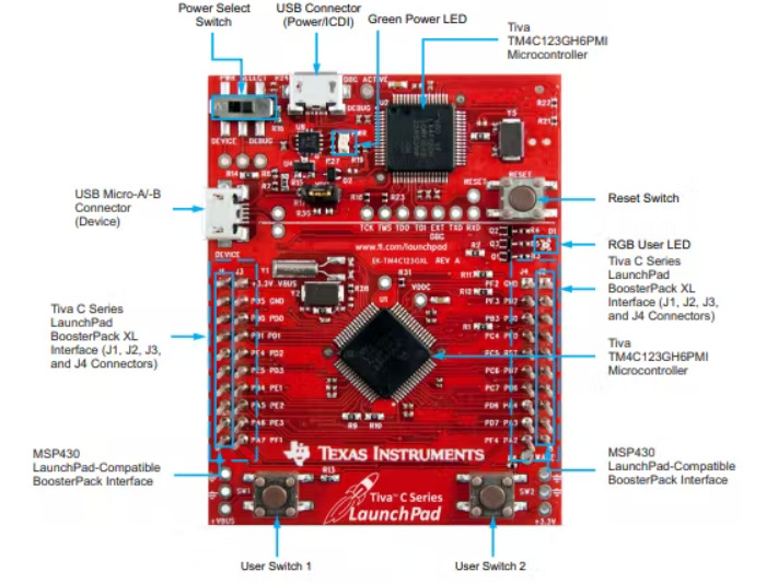

This Tivaware Launchpad (TM4C123GXL) has the following features :
Tiva TM4C123GH6PMI microcontrollerMotion control PWMUSB micro-A and micro-B connectors for USB device, host, and on-the-go (OTG) connectivity RGB user LEDTwo user switches (application/wake)Available I/O brought out to headers on a 0.1-in (2.54-mm) gridOn-board ICDISwitch-selectable power sources: – ICDI – USB device reset switch Preloaded RGB quickstart application.

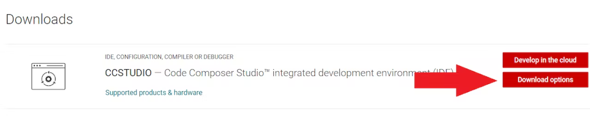

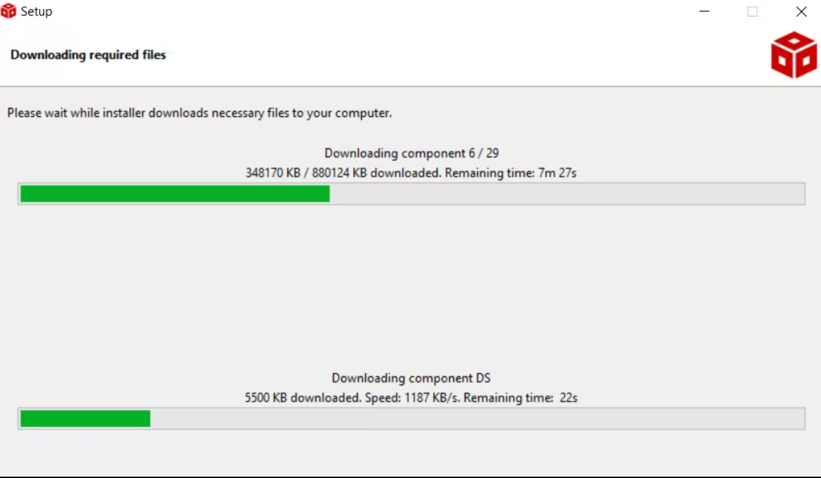

Download and Install Code Composer Studio from here. Then click on ‘Download Options‘ > select ‘Windows single file (offline)‘

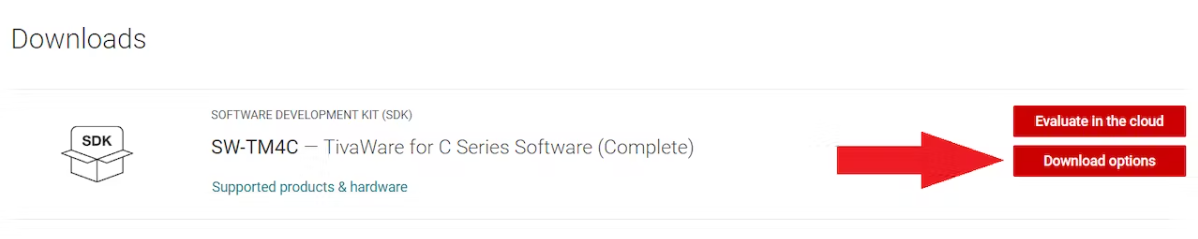

Now, Download the library for TM4Cxx family – SW-TM4C from here. Then click on ‘Download Options‘ > select ‘TivaWare for TM4C Series‘
Move the downloaded library file to a separate folder. It can also be kept inside the Code Composer Studio folder after its installation. Note the location of this file. There are other libraries for the particular board. Even though I used the EK-TM4C123GXL board in this article. You can use any other board, and hence download the whole library, instead of a particular board series.

Run the CCS (Code Composer Studio) setup file. Choose the Location to install the CCS. Tip – All the code files are saved in that location. Choose ‘Custom Installation‘, since we will only be using the TM4C123GXL board, select ‘TM4C12x ARM Cortex M4F core-based MCU‘

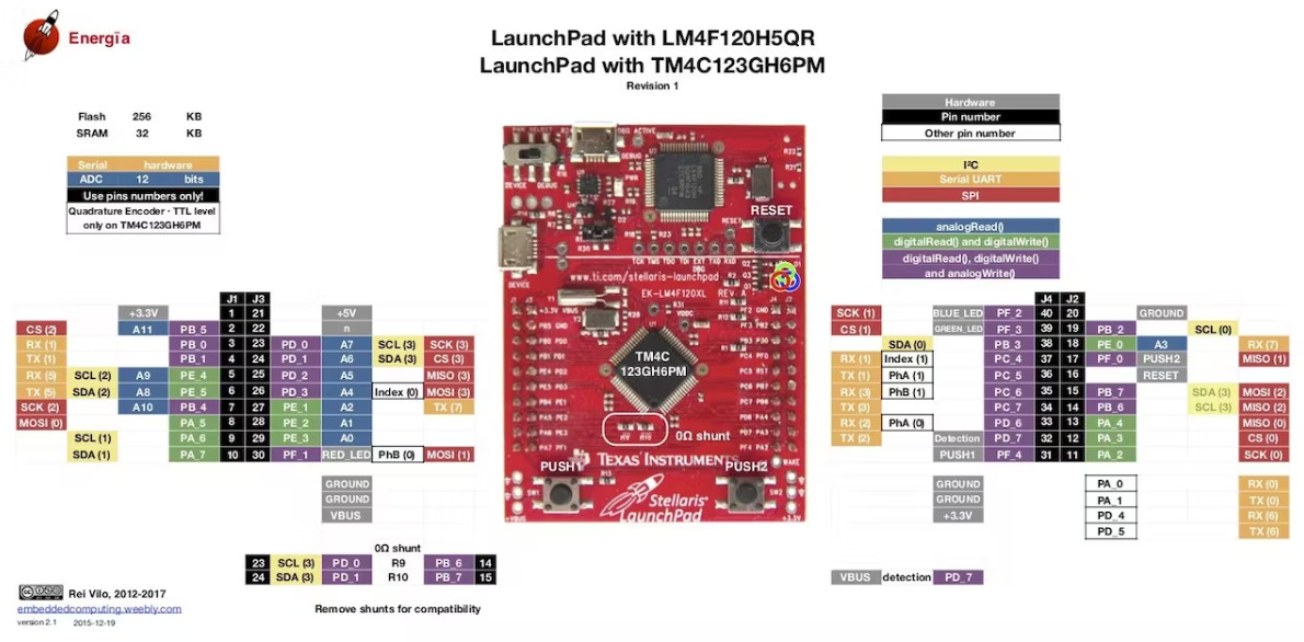

We shall be using the inbuilt RGB LED present on the board itself. The LEDs are internally connected to GPIO 1 on Port F.
We can see from the above diagram, the pin we are trying to control has an inbuilt RED LED. If you look carefully, the pin name is PF_1. Rest PF_2 and PF_3 are Blue and Green LED respectively. You can access the Github Repository of the project from here. Also, we require to set the System Clock Frequency to 40 MHz. Therefore, we’ll use the below parameters (in sequence) — SYSCTL_XTAL_16MHZ – Precise Internal OSC- SYSCTL_USE_OSC – Forwarding the OSC- SYSCTL_USE_PLL – Generates 400 MHz, then divided by 2 = 200 MHz- SYSCTL_SYSDIV_5 – OSC divided by 5 = 40MHzUsing the SysCtlClockSet() function, we can set the clock configuration required – Final Clock frequency = 40 MHz
