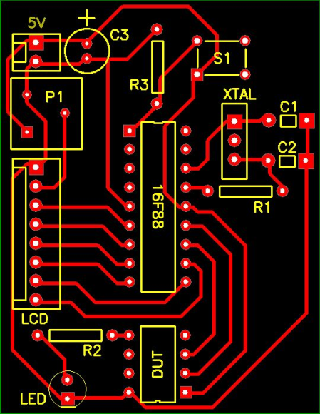

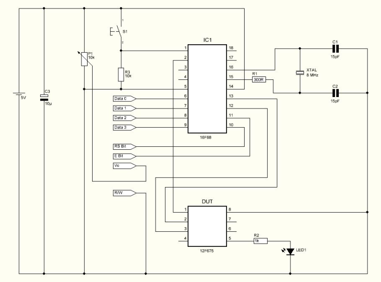

This project has the ability to calculate what is the appropriate osccal value for the 12F675 microcontroller.
Schematic
Schematic
Parts List
R1                   300 ohms resistor
R2                  1K ohms resistor
R3                  10K ohms resistor
P1                   10K Potentiometer
C1                   15pF capacitor
C2                  15pF capacitor
C3                  10uF capacitor
Led1               3mm green led
LCD               8X2 LCD
XTAL            8Mhz cristal
IC1                 16F88 microcontroller from Microchip
S1                   Push button
Others:
Box
8 PIN IC SOCKET
PCB
Hex program for the microcontroller

The program loaded in the 12F675 device which has no osccal value will force a pulse on GPIO.4 and it will make a loop while increasing the osccal value internally.
GPIO.5 will send the current osccal value used for each pulse sent. Because the device has no calibrated osccal value, the pulse will be variable. The circuit will wait until it receives the correct pulse. When the correct pulse is received, it will stop the test and display the osccal value used when the correct pulse was measured.
The value displayed is in Hexadecimal format which means it can be used without conversions directly to the device’s memory.

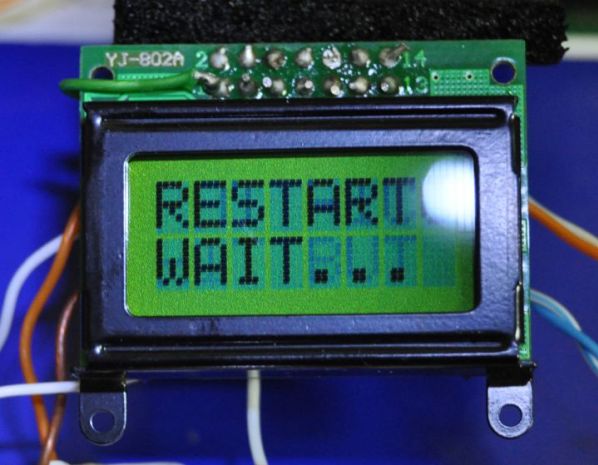

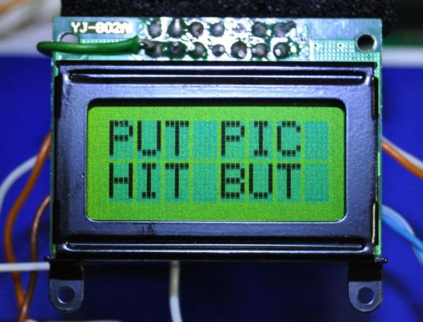

Turning on the circuit, it will display the name of the project and then it will display the message “ Put Pic – Hit But “. At this point it’s possible to place the 12F675 device on the socket and press the push button.

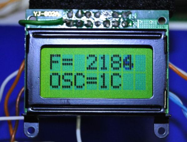

Pressing the push button S1 the circuit will start to measure the signal from the 12F675 device and will count the pulses. The display shows the pulse signal being measured and the current Osccal value.
photo_3

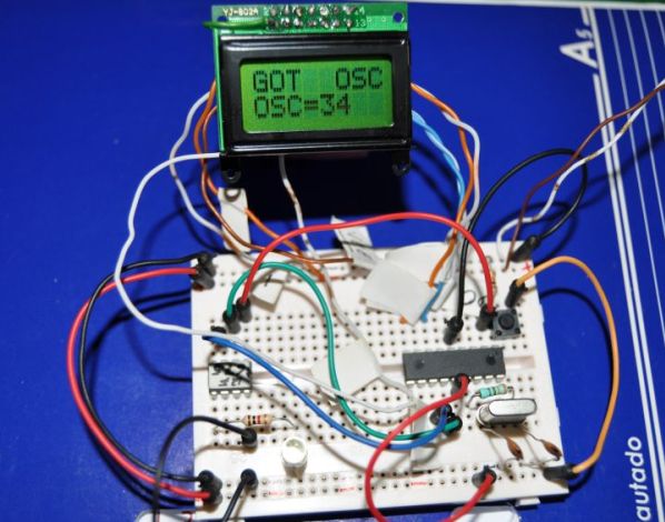

When the pulse sent by the 12F675 device matches the requested pulse length the circuit will stop the device and display the recommended osccal value.
photo_4

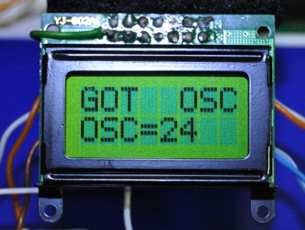

Since the circuit controls the power of the 12F675 device, at this point is possible to remove the device from the socket and place a new one. Pressing S1 the circuit will start a new test.
