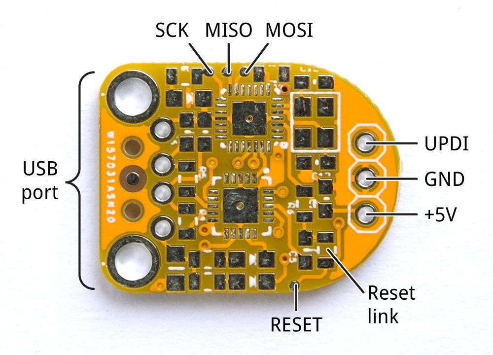

1. Solder a wire link in the position of the 0Ω resistor on the board. This connects the reset line to the microcontroller.
2. Solder wires to the MOSI, MISO, SCK, and RESET pads on the board, and connect these to header sockets that you can connect leads to. I recommend using very fine wires for the connections, so you don’t inadvertently lift the pads off the PCB. The other option is to solder header pins directly to the board.
3. Connect a 3-pin header to the three terminals at the top of the UPDI programmer PCB so you can use this to connect GND and 5V to the board.

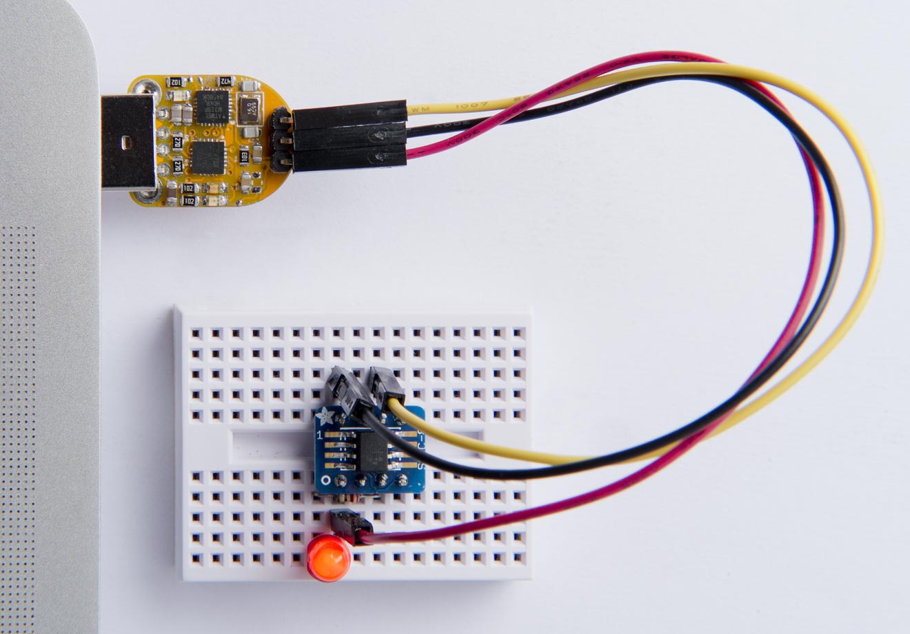

1. Connect the ATtiny to the UPDI Programmer stick as shown in the image below:
The connection is quite straightforward but the pin-pin connection between the Programmer and the Attiny is illustrated below to prevent mistakes:
Programmer – Attiny
GND – GND
5V – VCC
UPDI – UPDI

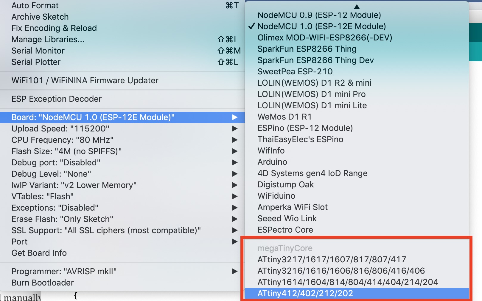

3. Open or write the code you would like to upload. Verify the code to ensure that there is no error, then go to Tools -> Board, and scroll down till you see the ATtiny you are working with on the list and select it. The ATtiny boards will be automatically installed after you install the megaTinyCore.

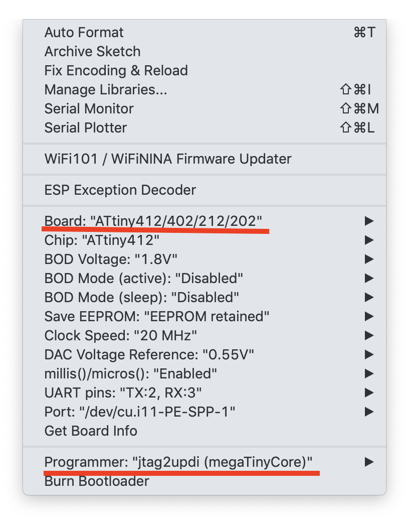

4. This should update the parameters being displayed when you click tools. Now we need to tell the Arduino IDE to use our programmer. To do this, go to Tools->Programmers (towards the end). Scroll down on the pane and select jtag2updi (megaTinycore) as your programmer.
5. With that done, your screen should now look like the image below when you click on tools;
6. This means all lights are green. Now select the port to which the Programmer Stick is connected and hit the upload button on the IDE. You should immediately see the upload process and when complete, the microcontroller should perform as programmed.
