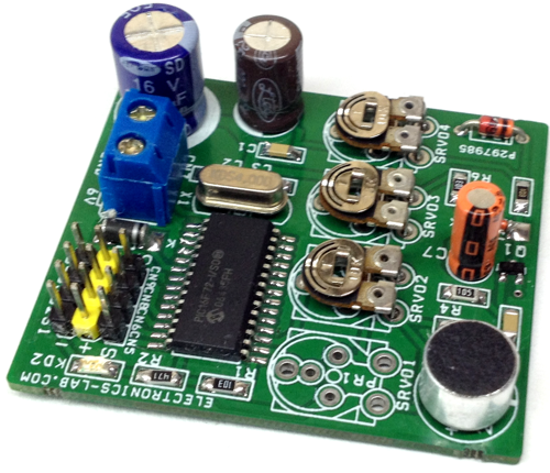

The project moves the RC-servo once receives any kind of sound. The rotation angle depends on the sound level, the more the sound level more the movement. The movement of the servo is proportional to the sound level.
The circuit has 4 channel servo drivers, the First channel is driven by sound, and the rest 3 RC servos are controlled by the onboard trimmer potentiometer, these 3 channels help to drive other movements of the animatronics figure.

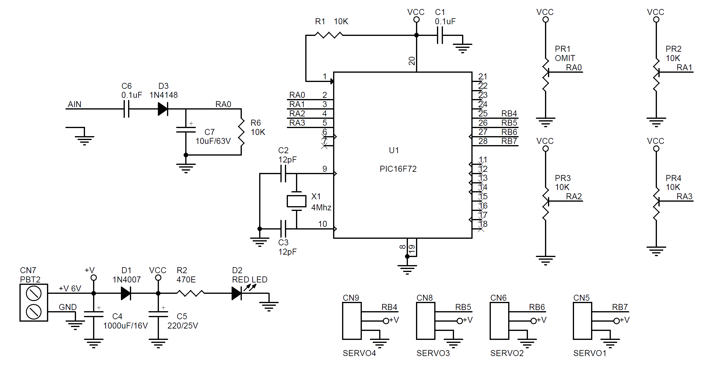

Sound Received by the microphone is converted to DC voltage, PIC16F72 microcontroller converts DC voltage into the RC PWM signal. The circuit works with 5V DC and it is advisable to use a battery for low jitter.

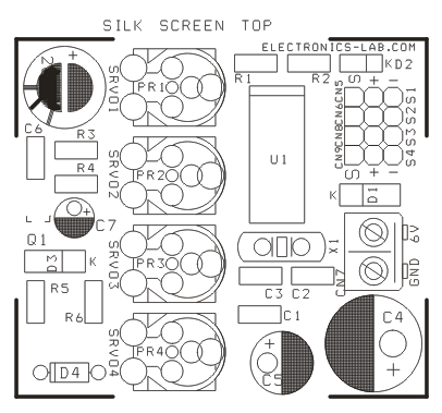

- Trimmer Potentiometer PR2= SERVO 2, PR3=SERVO 3, PR4=SERVO4
- CN5 Connector for RC Servo works with Sound
Schematic with MIC input
Schematic with Analog Audio input

Hi, I just recieved the assembled board. Super fast shipping and it works fantastic with the in-built mic. My final project will need the analog input, and I am not sure on how to do the mod. the info on this page with the schematics is very detailed, but being a complete beginner they don’t really make much sense to me unfortunately. Could you provide more instruction or perhaps a picture of the board in the analog input configuration? Thank you so much in advance.

I’m trying to understand the audio in circuit. It looks like you filter DC, then rectify, then smooth. Is this just to get a smoother version of the input signal? I’m guessing the smoothing capacitor is not large enough to completely smooth things back to DC. Is this right? Thanks.

Hi, I was wondering if your could clarify the steps to remove the mic and attach a direct line to this board.
You have listed:
“if you want to drive the input with a direct audio signal remove R3 (10K) and microphone and feed audio to C6”
Does this mean to unsolder the mic and the chip R3 from the board and solder line in connection to C6 chip?

How can I modify the circuit to install a more powerful servo at 8 or 12 volts?
bought two of these boards from you
everything works well
but there was a need to install a more powerful servo drive
please give advice
Is this possible in principle?
for example, part of the circuit operates at a voltage of 8 volts, and that part of the circuit where the board has a voltage of 6 volts.
will this work?
You may try to power the servo out of the circuit, connecting Vcc of servo pin with 8V, while keeping the PWM signal, and use common ground.
