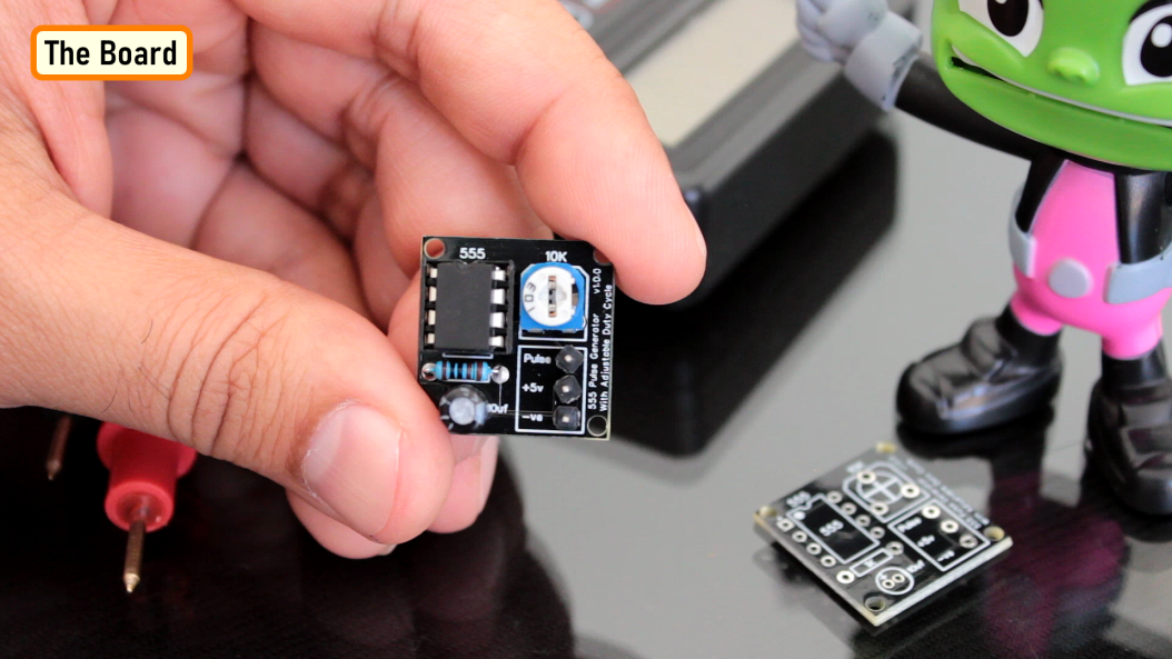

    The Board
    To make it easy for you guys, I have created this tiny little "555 LED Fader Module". After assembling the components, you just need to power this module by providing a voltage between 5v to 15v to fade the LED.
    So, this is how my board looks like in 2D and 3D. There are 16 breakout boards in this 100cm x 100cm assembly. You can download the gerber file from the link provided in the description below and order it from PCBWay.
    Soldering
    Let me quickly show you guys how to assemble the components to this custom made board.
    Let's start by soldering the IC Base to the board.
    Then let's solder the two resistors to the board. Next, lets solder the capacitor followed by the transistor to the board. Then, lets solder a blue LED to the board.
    Once done, let's insert the 555 timer IC to the IC base.
    To conclude the setup, I soldered 2 x Female pin headers to the board. You can either solder a pair of female pin-header or male pin-header or solder a pair of wires directly to the board to power this module.
    Demo
    Cool, so this is how my module finally looks like.

    The Board
    To make it easy for you guys, I have created this tiny little "555 Pulse Generator Module". After assembling the components, you just need to power this module by providing a voltage between 5v to 15v to get an oscillating output at the "Pulse" pin.
    Soldering
    Before moving forward, let me quickly show you guys how to assemble the components to this custom made board.
    Let's start by soldering the IC Base to the board. Then let's solder the potentiometer to the board. After that lets solder the 1kΩ (R1) resistor to the board followed by the 10µF capacitor (C1) to the board. Once done, let's insert the 555 timer IC to the IC base.
    To conclude I have soldered 3 x Male pin headers to the board.

    The Board
    So this is how my board looks like. There are 16 breakout boards in this 100cm  x 100cm assembly. You can download the gerber file from the link below and order it from PCBWay.
    Soldering
    Lets start by soldering the IC Base to the board. Then lets solder the potentiometer to the board. After that lets solder the R1 resistor to the board followed by the C3 capacitor to the circuit board. Once done lets place the 555 timer IC to the IC base.
    Demo
    So, this is the final appearance of the board. I am adjusting the output frequency of pulses using the 10K potentiometer.

    Using IC555 and IC4017
    Lets first create the chaser circuit using the IC4017 decade counter and IC555 timer IC.
    Components Required
    • For the Non-Arduino bit we need:
    • 2 x 4017 Decade Counter IC
    • 1 x 555 Timer IC
    • 1 x 10 K Potentiometer
    • 1 x 1  Kilo Ohm Resistor
    • 1 x 100 Ohm Resistor
    • 1 x 100 MFD Capacitor
    • 20 x Zener Diodes and
    • 10 x Red LEDs
    Circuit Diagram
    1. Forward Chaser
    The circuit is very simple.
    The 555 Timer IC operates as a clock oscillator or clock generator. The output on PIN-3 goes high causing a shift.
    The signal from the 555 IC clocks the 4017 decade counter. Output of 555 timer IC on PIN-3 is given as an input to 4017 IC through PIN-14. Whenever a pulse is received at the input of IC 4017, the counter increments the count and activates the corresponding output PIN. This IC can count upto 10, so we have attached 10 LEDs to the circuit.
    By increasing or decreasing the value of resistance of the 10K pot we can adjust the speed of the chaser circuit.
    Since only one LED will be turned on at a given time, I have attached just one 220ohm current limiting resistor to the cluster of LEDs.
    Demo: So this is how it looks like.
    2. Forward Reverse Chaser using 2 x IC4017
    Now, to give the forward and reverse effect we are attaching another 4017 IC to this circuit. If lets say the 1st IC connects from 1 to 10 (left to right) then the second one should connect from 10 to 1 (right to left). However, now we cannot connect the counter ICs directly to the LEDs as we did before. We have to use Diodes to stop the reverse flow of current to the 2nd IC.
    We have also lowered the value of the current limiting resistor to 100ohms as at a given time 2 LEDs will be on, one running from left and one from the right hand side.
    Demo: Now lets do a quick test. By lowering the speed I can get the desired forward and reverse effect. By removing one of the 4017 ICs we can get the effect that I demonstrated in the previous example.
    3. Forward Reverse Chaser using 1 x IC4017
    To get a forward reverse effect using one 4017 IC we need to connect 8 diodes to the circuit. The 1st and the 6th LED will be directly connected to the IC4017. The LEDs at the far end will get signals from only one pin however the one in the middle will receive signals from 2 x pins and hence we need diodes to stop the reverse flow of the current.
