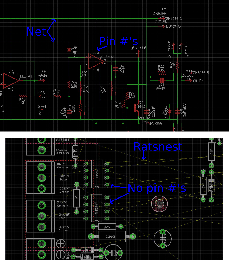

Guest liquibyte Posted September 20, 2014 Report Posted September 20, 2014 In the schematic part of the program, the pins for chips are usually labelled with the pin number and only sometimes the function of the pin. So, yes, this is kind of a engineering thing you have to get used to. I usually have the datasheet close by for whatever part I'm working with at the time. In the board part of the program, pin numbers aren't shown but it's really not necessary because the "ratsnest" shows the connections once the schematic is complete. As for the part not resembling the datasheet, that's fairly usual. For instance, op amps are always show as a triangle on its side. This is the universal symbol for op amps and convention dictates that they are always shown this way on schematics. Once you get to the board side of things, the pin numbers are never shown but the part designator and name usually are. I'm basically not familiar with anything other than Eagle so I can't comment on how the part libraries are for other programs. If at this point, you think this is fun, wait until you run into parts that have the same part numbering but differing pinouts. Transistors can really trip you up there as I learned recently. Slow down and take your time as any program with this kind of complexity can be a real discouragement if you let it. I could get into the programming side of things about how the programs generally work as far as layers go but that'd just bore you and would not be useful as an exercise. Let's just say that by default, the ratsnest is a special signal layer. You need to get your money back on the Livewire thing if you can't do boards with it without paying extra, that's just deceptive in my opinion. It's just not worth it considering you can download free programs that do both. Get a copy of Eagle and try it out. I would bet there are nth more tutorials out there for it too.I can help you with Eagle, I can't with Livewire other than in a general sense. For examples of some of what I've been talking about, see the screenshot of a circuit I'm currently redoing the board on. Quote

Guest liquibyte Posted September 22, 2014 Report Posted September 22, 2014 Just remember to verify the footprints from the parts in the libraries to the datasheet of the part you're going to be using, not only for pin spacing but also pinouts on chips and such. Don't be afraid to try the other programs out too. Sometimes you'll find one that better fits your work flow. Diptrace seems to be popular in that regard. Quote
