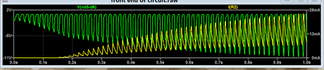

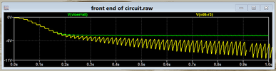

Putting just the front  end into the simulator. The labels in large print map back to the schematic. Using a 4.7 volt zener simulator doesn't have a 5.1 zener.
In these traces the green is the voltage on the negative rail and the yellow is between D6 and R3.
In this one the green trace is between D5 and D6 while the yellow trace is the current through R2.
And this one is with C3 disconnected. voltage  at the negative rail.

I had some time to analyse the simulation, it appears there's a problem of current, the negative rail needs 40 mA but the charge pump can provide no more than 9-10 mA before collapsing (with my 23.4 VAC to start from).
