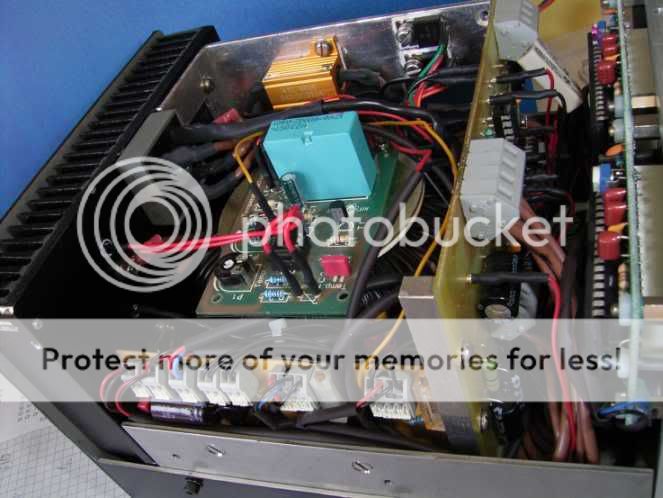

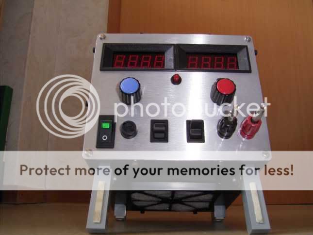

Hello everybody
I finished building my modified project maybe a year ago and promised back then to post some pictures as soon as i could get my hands on a digicam :)
Well, here they are:
Outside:
The output can be shortened and switched off by two flick switches. This allows adjusting of voltage and current limiter before feeding it to the circuit.
In order to prevent heating problems, I used a sandwich design for the bottom of the case. The 92mm fan sits directly behind the filter on the bottom. It blows up to the mounting plate, which has several holes in it to allow fresh air to get to the board, the trafo, and some other places. The rest of the airflow goes to the back and is forced through the heatsink.
Inside:
Looks shocking, but at least there's no space wasting ;)
Both BD 241 and the 0,47R resistor are mounted on the sheet of aluminium bolted to the black heatsink.
The 10.000

Hi Thomas,
Your project looks neat, tidy, compact and very nice.
I am glad to hear that it works perfectly. ;D
