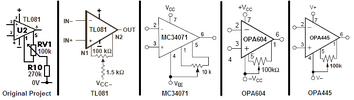

Hi! ,Everybody
I made this 30v lab supply using mc34072 and everything is working fine except the voltage at output is not.going below 15mv as it should go to 0 and the current limit is not working below 36ma as the current limit should work till 2ma as stated, please help.
The voltage at
Voltage pot 1st pin=11.2 v, 3rd pin=0.008
Current pot 1st pin=1.2v, 3rd pin=0.014
Current shunt are two .22ohm resisitors in series which gives me 1.22v voltage drop at 30v 3amp
My concern is that ,1- voltage should go to zero which is not going and is about to 15mv whe voltage pot turned to zero.
2-current limit is working till only 36ma and not below it..
Please i appreciate any help..

Every opamp has an input offset voltage error. Single opamps like the recommended MC34071 and the TLE2141 have input offset voltage adjustment pins. The project uses trimpot RV1 to null the offset voltage but your MC34072 does not have offset adjustment pins. Since your MC34072 has two opamps then it has double the heating and I think it becomes too hot.
The original project used the wrong value for R10 connected to RV1 and R10 was connected to the wrong voltage. Here is how it was and how it should be:
