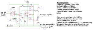

The Chinese meter is messing up the voltage and current of the power supply project.
Try the power supply project without the Chinese meter. Measure the voltage across R7 then calculate the current in it.
The voltage across R7 will never be more than 1.414V when the current in it is 3.0A or less.
Here are my calculations for the current calibration trimpot RV3:

Ok thanks Audioguru for your explanation, I wil take measure but I have one questions :
When you write on shematic +1.41V above R21, it is between Circuit OV, not the output ? I wonder if the ground have to be before or after R7 ? Is there any importance ?

So I make my measure and this is result :
1) If a have no load (D is my ground) :
-UR7 (U_CD )= -12.6mV
-U_AC= 0.745V with RV3 set  to 100K
-U_AC=2.47V with RV3 set to 0K
-U_BD=11.7mV
-U_BC= 24.8mV (11.7-(-12.6))
If I put a 10R load for 5V to output :
-UR7=-115mV, so I=0.115/0.47=245mA
-U_AC = 0.635V with RV3 set to 100K
-U_BD = 11.7mV
-U_BD= 128mV

5V on 10 ohms produces a current of 500mA (0.5A). Then the voltage across R7 is 0.235V.
On your schematic, C is the ground for the current regulator. The output ground is its input signal and the 11.2V is its reference voltage.

Ok finally I test limited current and the voltage above R7  with 500mA is 165mV and 313.8mV with 1A. I measure with milliohmeter and I have 430mR for R7. I don't understand why the voltage drop is not 0.43*0.5=215mV and 0.43*1=430mV ?
So I make some test :
a) For max 3A output with Pot2 max I have to put 1.304V on U3+
b)It's works fine, if a put a 3.01A load (with my electronic load) the Led bright and the current limiter est working.
c) But I test to make a short-circuit I blow up my primary fuse (630mA T, maybe to low).
Why do you think about the voltage drop about R7 and for my 1.3V for 3A max ?
audioguru2
Apr 6, 2004
12,022
Apr 6, 2004
12,022
165mV/500mA= 0.33 ohms that is wrong. 215mV/1A= 0.215 ohms that is also wrong.
1.304V/3A= 0.435 ohms which is close to your measurement of R7. Then trimpot RV3 is set for a max current of 3A or less.
b)It works fine, if a put a 3.01A load (with my electronic load) the Led bright and the current limiter is working.
When the output current is higher than the setting of P2 then the output of U3 goes low which turns on the LED and reduces the voltage at the output amplifier. Then the shorted output should have a current of 3.0A maximum.
The opamp used for U3 and the negative supply voltage must be allow the output of U3 to go low enough so that the input to the output amplifier is shorted to 0V when the output of the project is shorted. Then R7 is the load.

When you turn down P2 to zero then the project's output current should be no more than a few mA. The circuit reduces the output voltage with U3 and D9 to reduce the current. When the current is limited to a few mA then the anode of D9 is 0V and its cathode which is driven from the output of U3 must be about -0.65V. That is why U3 is an opamp that has its input and output able to go close to its negative supply and why it has a negative supply.
When you turn up P2 then the current does not go up, the voltage and the load resistance set the current. The maximum current goes up.
The circuit is designed for a maximum current of 3A so you should set the current calibration trimpot RV3 so that with P2 at maximum and with the output of the project shorted then the current is 3.0A. If RV3 is set to its maximum of 100k then the maximum output current will be 1.33A as I showed in post #?.
