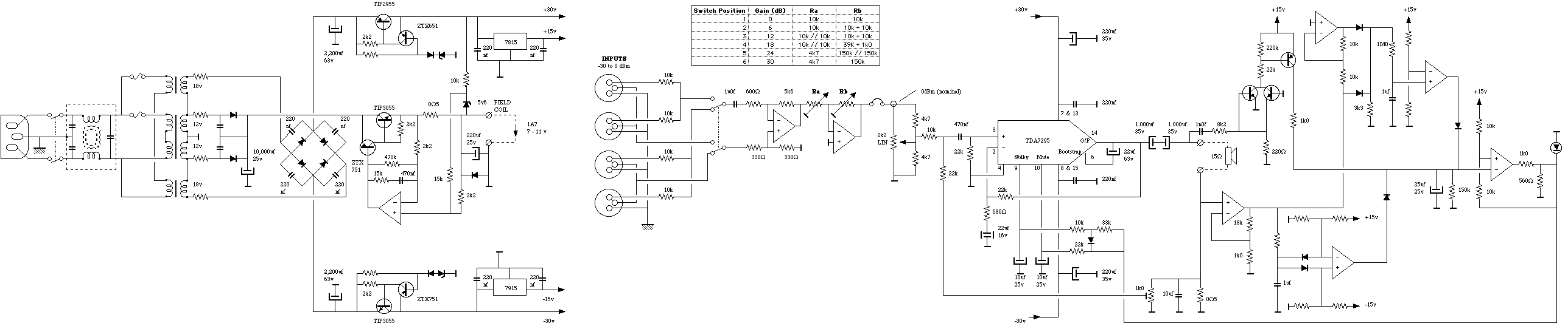

Gerhard Hoffmann
Jan 1, 1970
0
Am 28.01.2013 11:38, schrieb Adrian Tuddenham:
The requirement is to design a specialist one-off audio amplifier to
drive a loudspeaker at the end of a long cable for experimental
purposes. The voice coil is nominally 15 ohms with a pure resistance of
10 ohms. The loop resistance of the cable will be somewhere between 2
and 4 ohms. It would be desirable to have a damping factor of 10 or
better, so I need to reduce the effect of the cable resistance in some
way.
Actively damping the bass chassis by removing all R can
produce a ridiculously low corner frequency for small speakers,
at the cost of efficiency and SPL.
I once have calculated a little bit around such a construction
but gave up when I noticed that the system is not even time-invariant.
I.e. after a drum kick the voice coil is really hot and its resistance
is _much_ higher than b4. A moving target if you want to zero it out,
and the combination of small chassis and low efficiency calls for lots
of power.
IIRC, one Mr. Stal brought the idea up. With a small circle above
the a in Stal.
regards, Gerhard

Gerhard Hoffmann
Jan 1, 1970
0
Am 28.01.2013 19:43, schrieb Adrian Tuddenham:
By using the amplifier in a feedback circuit which makes it appear to
have a controlled degree of negative output impedance which is equal to
the unwanted resistance of the wire, I can reduce the loop resistance of
the whole output circuit loop to just that of the loudspeaker voice
coil.
I am not trying to counteract the loudspeaker resistance, just that of
the unavoidably long wiring.
Is that any different from a Kelvin connection?
Gerhard

http://www.poppyrecords.co.uk/other/images/Circuit1.gif
....but bear in mind that this is the first draft. It is bound to
contain mistakes and quite a few of the component values are still
unspecified.
The link for inserting an equaliser is between Rb and the 2k2 LIN gain
control, there will also be power connections for any op-amps which may
be necessary. The signal level at that point is nominally 0dBu.
