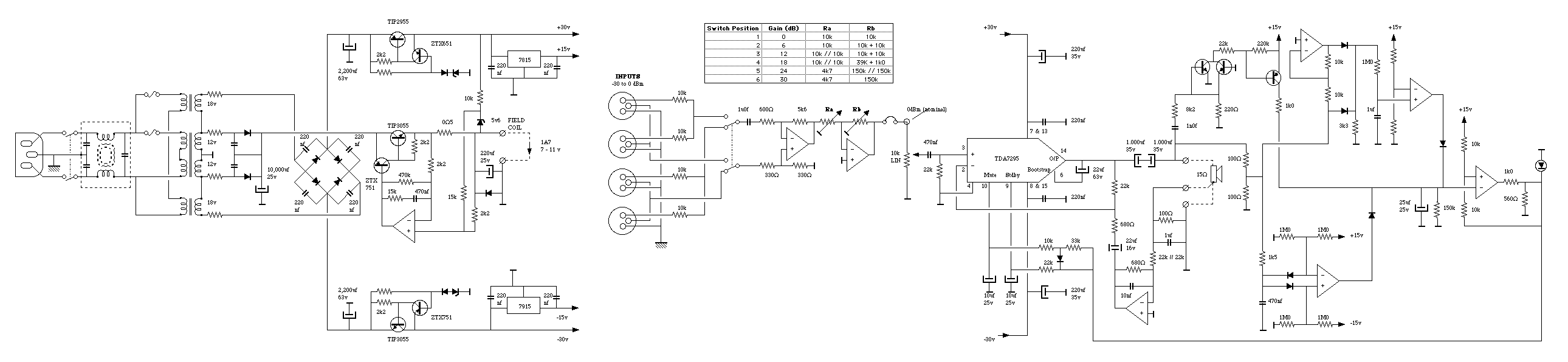

Something like this?
http://www.poppyrecords.co.uk/other/images/Circuit2.gif

The amplifier circuit has now been upgraded:

Jan 1, 1970
0
On Mon, 28 Jan 2013 10:38:23 +0000,
The requirement is to design a specialist one-off audio amplifier to
drive a loudspeaker at the end of a long cable for experimental
purposes. The voice coil is nominally 15 ohms with a pure resistance of
10 ohms. The loop resistance of the cable will be somewhere between 2
and 4 ohms. It would be desirable to have a damping factor of 10 or
better, so I need to reduce the effect of the cable resistance in some
way.
I have considered the use of line transformers or a four-wire feedback
system, but neither of them is practical in this particular case. As
this amplifier will form part of a fixed installation and will only ever
be used to drive the one loudspeaker, I am now looking into the
possibility of giving the amplifier 3 ohms of negative output impedance.
The simple solution is to use an off-the-shelf unit for the power
amplifier, the TDA7295 should be more than adequate. With a 0.5 ohm
resistor in the return loudspeaker wire, I can measure the output
current and derive a suitable voltage for adding to the input signal.
The practical situation generates at least two problems which the simple
theory does not take into account:
1) The capacitance between the conductors of the long loudspeaker
circuit will give the effect of a falling loop impedance as the
frequency increases, leading to ultrasonic instability.
2) The long unscreened run of loudspeaker wire, which might be in close
proximity to mains cables and dimmable lighting circuits, may pick up
interference by capacitive coupling, which will then be injected into
the feedback point and amplified.
Both of these might be overcome by a capacitor across the 0.5 ohm
resistor, the value being chose to only take effect above the highest
wanted audio frequency.
The problem is that I have to construct this equipment without access to
the loudspeaker or wiring, and it then has to be certain of working
correctly the first time it is installed. For this reason I would be
very grateful if anyone has had any practical experience of anything
similar and could let me know of the snags they have encountered and the
solutions which worked.

Jan Panteltje said:
Well, how about a combination of those?
And do not forget the usual mains plugged into it.
Series resistors, limiting diodes?
That is planned, but not drawn yet.
What I expected to see was some relay that only connects the speaker after the
output was found to be OK.
I don't know either, been 14 years, it is a good chip, the TDA7294.
As to 'as cheap as possible'? (was that what you mentioned?) seems to
conflict with 'research project'. Component price usually is not a point
with one of designs, it is the hours.
I tend to get involved in projects where the hours are less important
than getting the job done to my satisfaction - it's called "being self
employed".
Other important thing: I do not see any RF filters in the input.
Very good point, I shall have to add those when I am satisfied that the
circuit does what is required of it. (This drawing is only a prototype
at this stage.)
I had to decouple each and every input including the mains to my mixer in
Amsterdam, as the electric tram drivers radio came right through (AM
detection in input circuit). We had that happen in a hall a couple of
times. Really is a distraction...
I am surprised that you didn't get noises from the traction current too.
If I remember correctly, Amsterdam trams have a carbon strip on their
current colectors, so that probably helps to reduce contact noise. It
is much easier to fit on-board filters to a tram than to a trolleybus,
because the tram has a well-earthed chassis.
The old UK trams used a brass wheel for current collection and had no
suppressors. On rainy days, people at the outer end of a tram route
would switch on their wireless sets to listen for a tram approaching, so
as to avoid standing a long time in the rain waiting for it.
I see you stabilized the + and - 30 to the power amp, loop bandwidth big
enough? Those are slow transistors... Or is it just over-voltage
protection against high mains? Sometimes a simple emitter follower with
cap and zener to ground can function as C multiplier and give extra
filtering over a wide band, and limit voltage at the same time.
The real reason was to give me some control over the peak power of the
amplifier. If I find it is capable of delivering dangerous transients
to the loudspeaker, I can change the zener diodes and bring down the
power rails to a lower value. There are reservoir capacitors on the
pins of the power amplifier chip (as recommended in the data sheet), so
the speed of the regulating device is not important.
