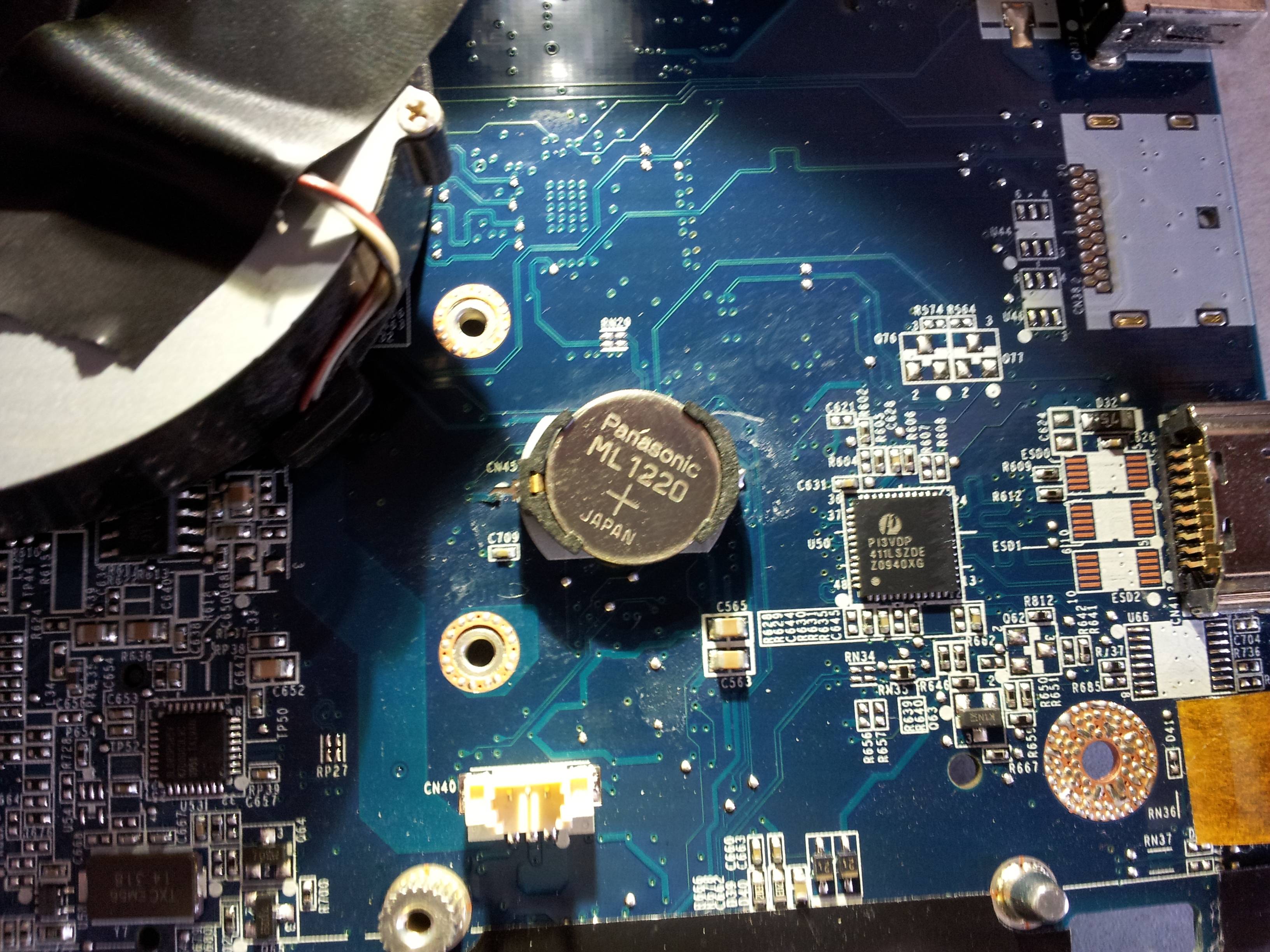

Post some photos. Hopefully there is enough remaining that you can pehaps epoxy the battery holder to the motherboard and run wires, or even mount the battery off-board with wires to it.

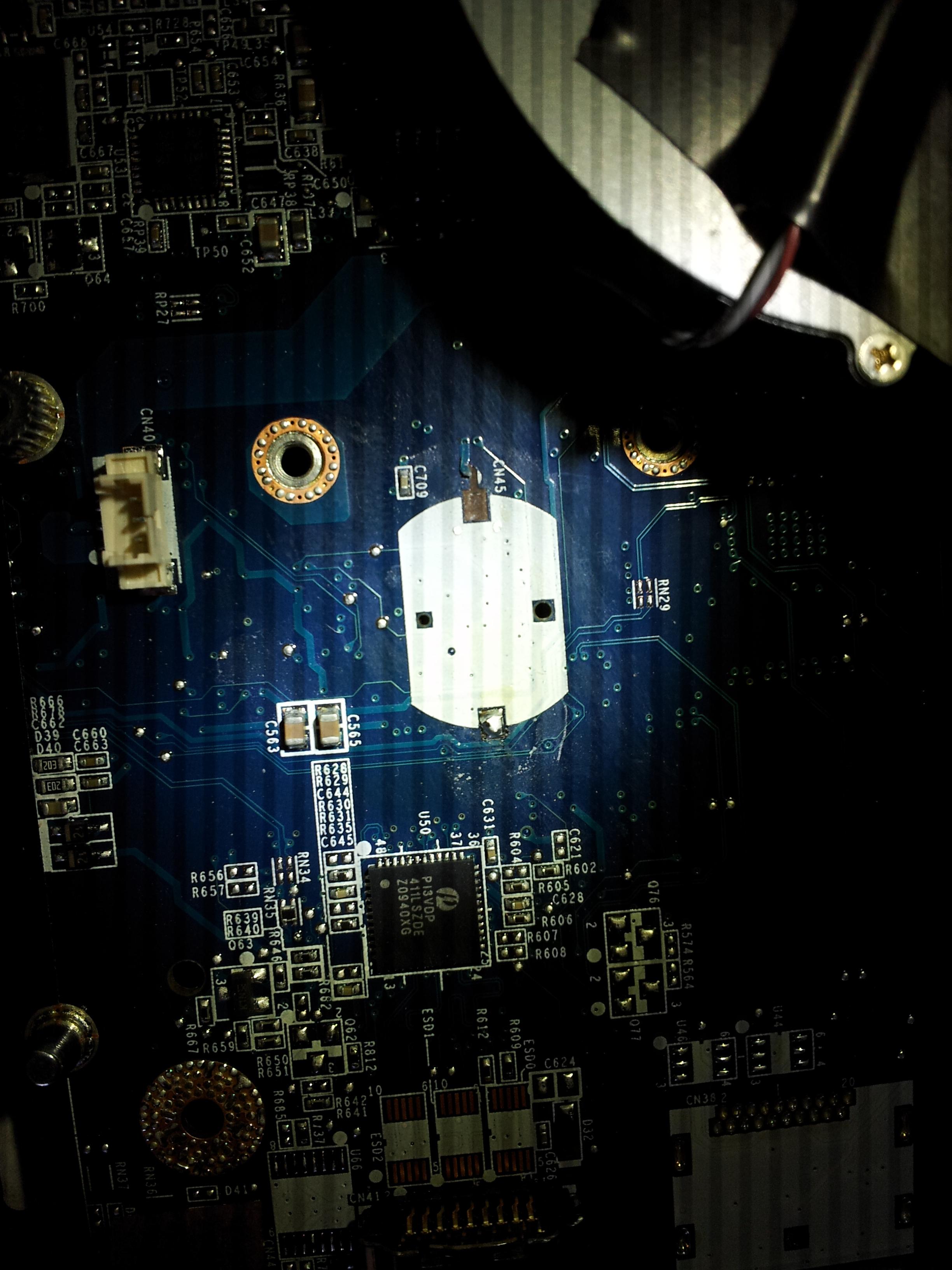

Ok finally got the pictures:

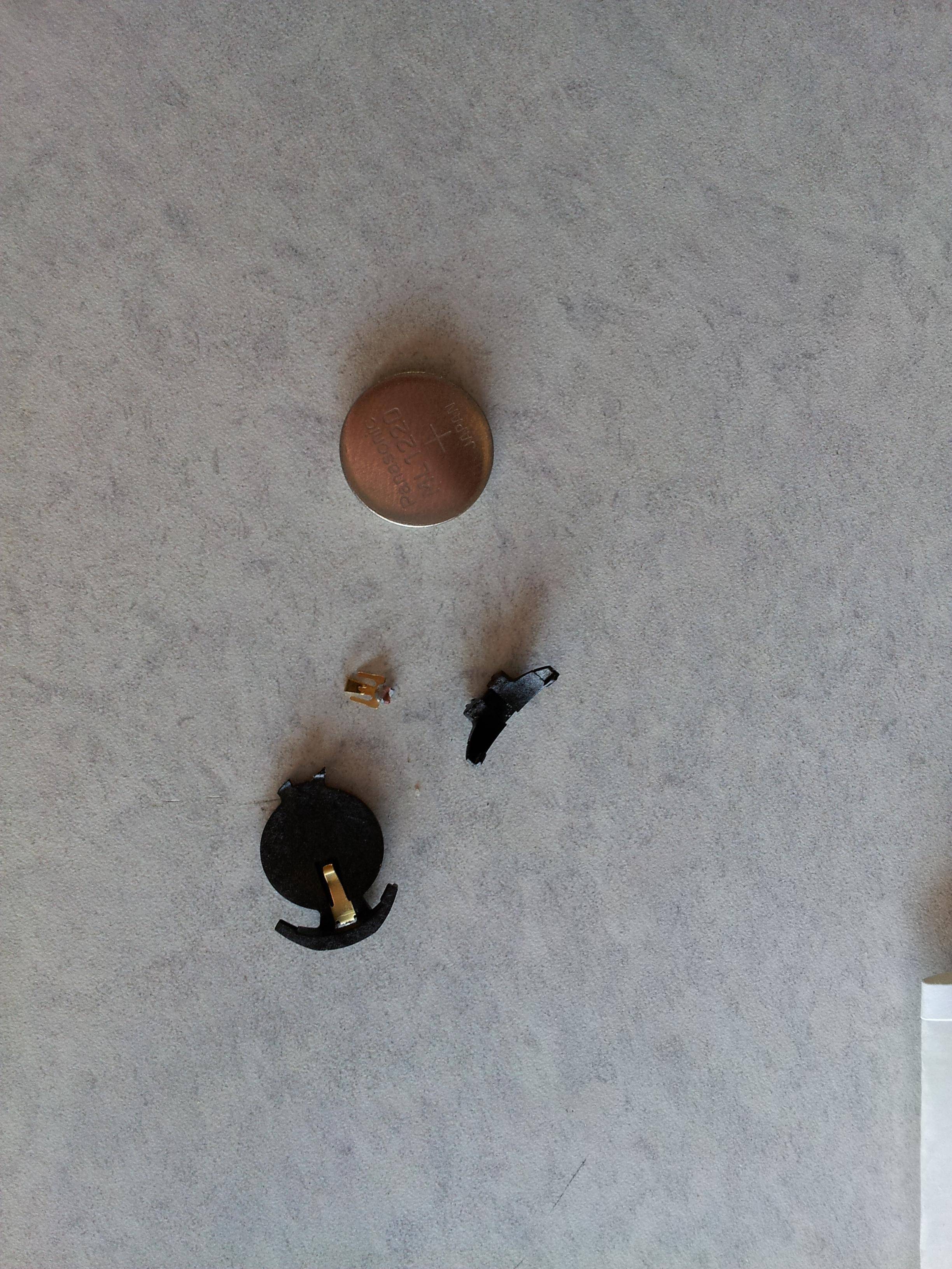

So another update:
In an attempt to remove the battery from the small container, this happened:
Can I just wire the battery directly? I'm a bit confused because when the battery sat in the container, it looked like only the bottom (negative) side was touching the brass contacts.

Yikes, wondering if I should get a pro in this case.
The side with the missing pad just goes in a half an inch of a straight line to a hole. If I did it, would i scrape around there and try to apply solder?
yes and scrape around the via hole and on the other side of the board
get a piece of tinned copper wire as thick as possible that will fit down the hole
Solder it both sides and along the scrapped bit of track
you can buy those battery holders .... it would be the ideal way of insulating the battery from the circuit board
in the holder there will be 2 battery contacts that long one you can see it touches the smaller side of the battery, the negative terminal. And a small edge contact, that touches the large positive terminal, which I think I can see the remains of in your pic

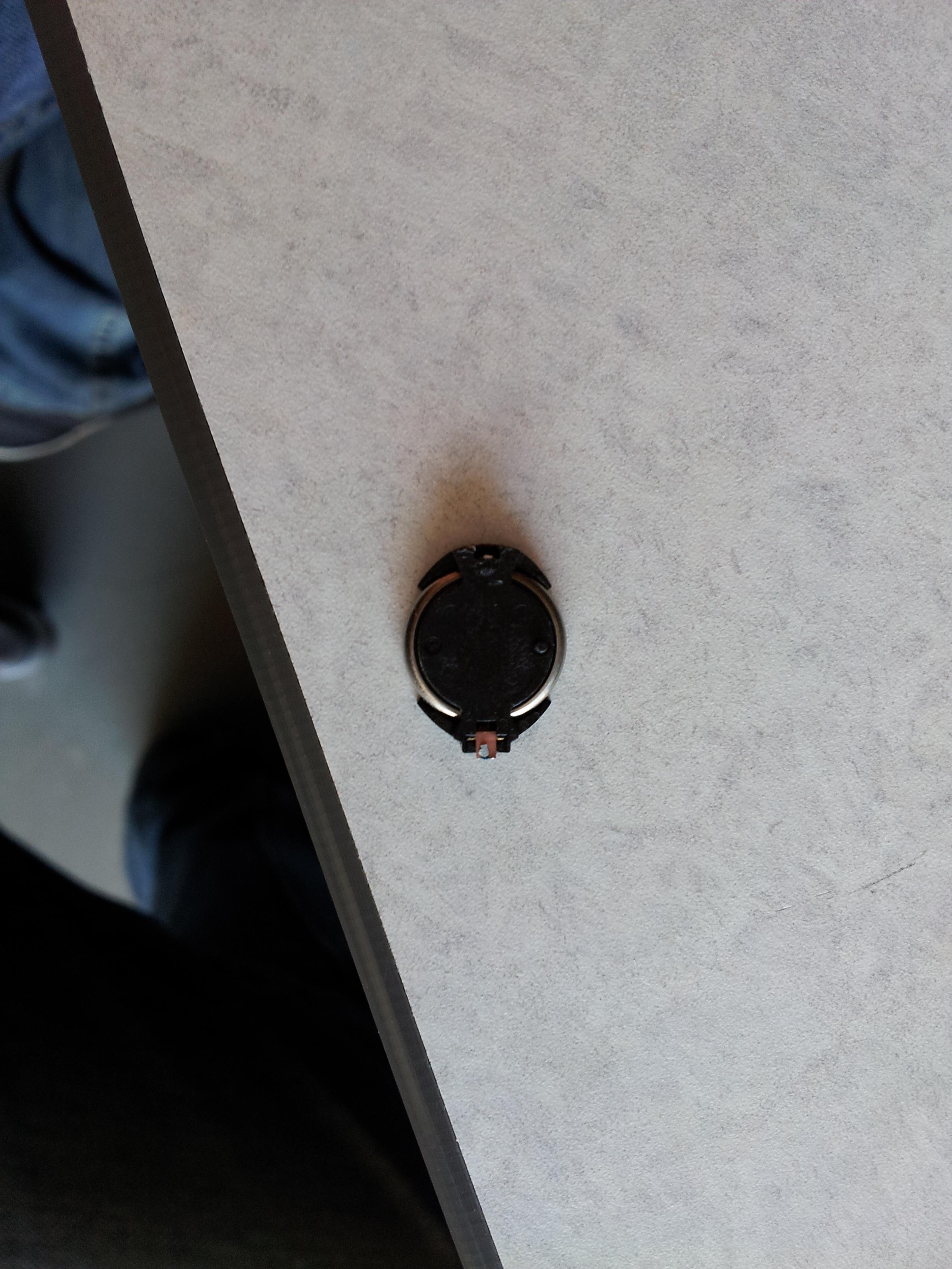

thanks Dave.
I took it down to a family members shop and got some help. About to test it out now. He used a thick type of shrink wrap to cover the battery and two wires to each side
