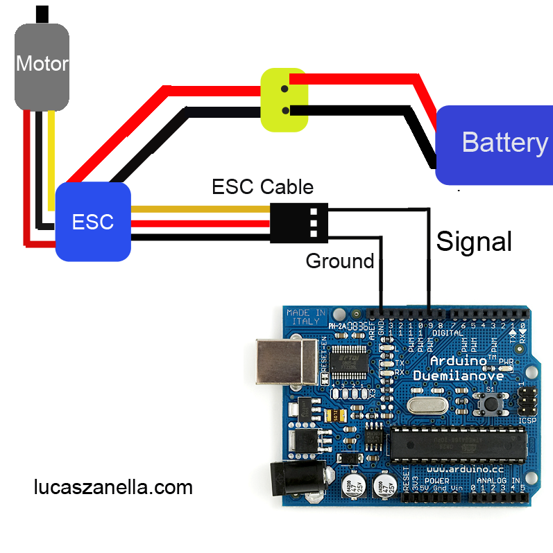

So I have these:
https://hobbyking.com/en_us/zippy-flightmax-5000mah-3s1p-20c.html 2x wired in parallel for 6S
https://hobbyking.com/en_us/turnigy-plush-100a-w-ubec-speed-controller.html
https://hobbyking.com/en_us/turnigy-aerodrive-sk3-5055-280kv-brushless-outrunner-motor.html
And I want to control them with an arduino UNO ( Later on with 433mhz transmitter/receiver https://www.banggood.com/433Mhz-RF-...o-ARM-MCU-Wireless-p-74102.html?rmmds=myorder although might switch to NRF24L01+ 2.4GHz)
After wiring everything up like in the image and using this code, I press 0 in the serial monitor several times till value gets to 60-70 the motor starts jittering back and forth rather than running constantly in one direction.
What is causing this issue and what can I do about it? (I'm proficient in several programming languages though I havent used the arduino api at all)

It might be this bit of code.
Code:
if (Serial.read() == '0')
      value +=2;
    else
      value-=2;
The serial.read() tries to read from the serial port, but returns -1 if no data is available. If you don't send data or send data not fast enough, the else branch will decrement 'value' with every pass of the loop.
I suggest you use two different codes (e.g.0 and 1) to increment or decrement the value, but let value untouched else:

Thats why my while loop has a check if serial is available and if it returns more than zero.
Also when logging, the value doesnt change like you say it will.
What I am unsure about is why the motor jitters rather than spins normally, because comparing my code to others who had success it seems that mine should spin also.
So the issue might be that the motor has a different angle/sec than an endless spinning servo?
Im really stumped by this.

ESC will require a signal from 70 to around 220 for min and max speeds as this is what the tx delivers normally. You may also require an " initialise" signal as most rc esc will not start until throttle is first taken to max then returned to minimum level ( safety aspect so prop dont chop) Plenty of code out there that will do it.

It might be it, I am not arming the escand the esc might not know what I am sending is throttle signals and it makes the motor jitter back and forth.
Will test it out tomorrow morning, though more input is welcome :)

Thanks, I used some of your code and apparently the bullet connectors on my motor to the esc were soldered poorly, hence the jittering, after fixing it and running the code again everything works fine. :)
Also for the A0 pin I used a potentiometer :)
