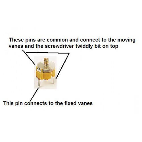

Okay I'll buy that capacitor. I cannot go for a kit now because I already bought other components and I cannot afford another kit now. Since this is a school project, I have very less budget to work with. That's why I preferred not to go with a kit as they are costlier than building from scratch.

@Harald Kapp check out the YouTube video link at 1:07 . I guess you will know how to connect the variable capacitor then. I could not figure out by looking at the video.

I agree that two of the pins might be connected together. You can determine that using any little circuit, like an led and try connecting one side of the battery through any two connections on the capacitor.

if you can't get a meter, you can still get a primitive continuity tester. Get a 12V battery and a wire and short the negative and positive terminals together. It will make a spark when you try to connect the wire from one pole to the other. The spark tells you that the wire is conducting some current. This will also work with a 9V battery but the spark will be really small. Or with a li-ion battery but the spark will be really BIG so you must use a REALLY small wire.
So now if you have a 3-terminal cap, then you use the same method to see if two of the terminals are connected together. They will pass current from one to the other. It won't damage the cap.
But if the 3rd lead is just an anchor lead and is not connected to either side of the cap, then you have a problem.
of course you could also look for the data sheet for the cap in question. if you know the make of the part.

I got this from some website. Can someone figure out what it says? I guess it should say that two collinear pins are short together . Can someone confirm?

Yes, the two pins at the sides are common (connected together). The pin at the front is the other connection to this variable capacitor.

The reason for the two pins connected together and to the adjuster of your variable capacitor is to ground the adjuster - those two pins should be the ground connections - this prevent the tool you are using to turn the vanes affecting the capacitance.
Also foil wound fixed capacitors often have a line around one end which signifies which lead is connected to the very outside bit of foil so that you can join this end to ground so as to act as a screen around the inside foil.
