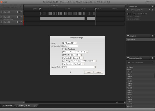

I have a bad Linksys wireless router, and during my attempt to repair it, I found its serial debug port. I hooked up my logic analyzer to it and found valid baud, and other settings. I am able to view ASCII characters in the captured data.
However, I keep getting garbage characters when I try connecting to it from an actual DE-9 serial port using the configuration detected in the data capture. I've tried dozens of various baud/data bit size/stop bits/parity/terminal type (VT102/ANSI) and other settings, but I haven't been able to find a compatible combination. I don't know what's wrong.

Here is a picture of my capture. Click on it to see the full size.

Thanks for your prompt reply. I'll check the voltage later this morning when I can. But the logic analyzer was able to decode the characters. If you look at the lower right of the picture, you can see them, along with their ASCII values in hexadecimal. It's just a small portion that's visible in the picture, but it shows that it's able to detect and decode them. "Wireless router" is spelled out in a vertical column. Toward the end of the capture, it says to hit the space bar three times to enter a command. However, when I tried that on a terminal, nothing happened that I could see visually; no messed up characters appeared to change as a result of pressing it.

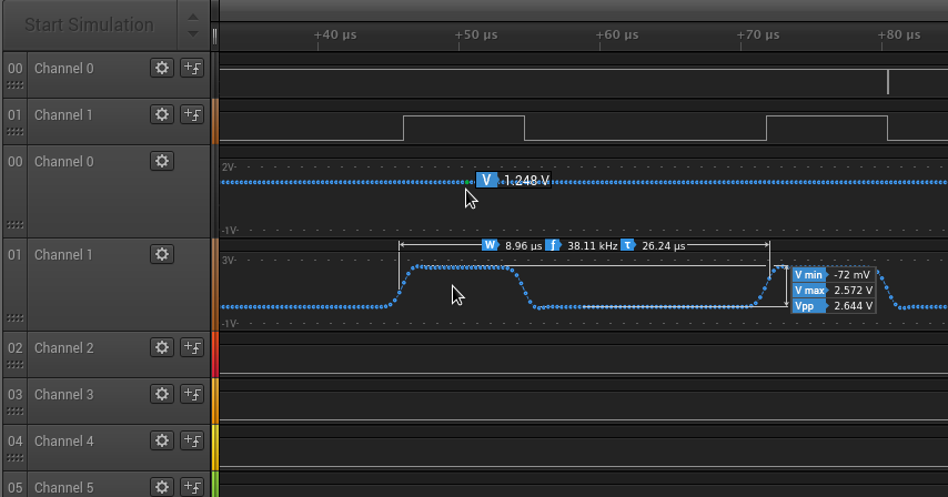

When you are able to decode the signal using a logic analyzer, I guess the signal levels are TTL (0 V ... 5 V) or even less (0 V ... 3.3 V). This port may be a UART port providing all the logic for serial communication but not the signal levels for true RS232 signals (< -3 V ... > + 3 V). The necessary level shifter (e.g. MAX232) is probably not on the router's PCB to save a few cents as it is usually not required.
In that case you'll need an RS232 level shifter (e.g. this one or a similar one) to connect a PC to this port.

I've dealt with serial stuff before, but not a lot, so thanks for that link. I'll probably buy it. Here are the voltages my logic analyzer detected.
