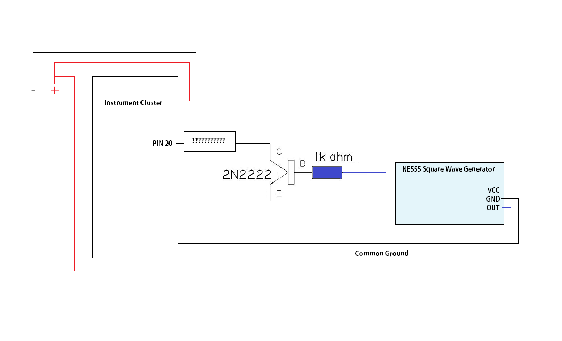

I have a speedometer/instrument cluster from a car that I am doing some bench tests on. I've got the cluster powered up by referring to the pinout diagram. I've got turn signals emulated too. However, I want to emulate speed and according to the pinout diagram, there are two speed related pins and the pins are described as:
Speed signal (Output) - Pulse generation (Waveform 1 Diagram below)
Speed signal (Input) - Pulse generation (Waveform 1 Diagram below)
I've attached the waveform diagram below. Can anyone tell me if there is a easy and cheap way to emulate this so that I can simulate speed and send this data to the cluster? I'm not sure what the difference between input and output on the cluster pins are either.

So I received the NE555 adjustable module from here: https://www.ebay.co.uk/itm/262841412289
Pin 19 and 20 on the cluster are related to speed signal. Pin 19 is speed output and Pin 20 is speed input. It seems like the output provides speed information to other ECU's that need the speed information. According to the manufacturers documentation it says:
  1. The instrument cluster meter CPU receives vehicle speed signals.
  2. The vehicle speed sensor detects the voltage that varies according to the vehicle speed.
  3. The ABS & traction actuator assembly supplies power to the vehicle speed sensor.
  4. The ABS & traction actuator assembly detects vehicle speed signals based on the pulses of the voltage.
  5. The ABS & traction actuator assembly transmits vehicle speed signals as pulses to the instrument cluster meter CPU.
  6. The instrument cluster meter CPU calculates the vehicle speed converting 4 pulses to 1 revolution.
However, when I connect a multimeter's positive probe to pin 20 and negative probe to the instrument clusters metal body, I get a voltage reading. So I'm a little confused, if this is giving a voltage then I dont think i can supply a pulse votage to it can i? There are a few other pins on the cluster that provide a voltage and when you ground those wires with certain resistors they perform a task on the cluster.
Any ideas?

What are you using to measure the voltage? A DMM with an input impedance of 10Mohms or more? The voltage that you read on pin 20 may be going through a high-ish value resistor to maybe the base of a transistor so you would expect a voltage there - how many volts are you getting? Section 3 says - The ABS & traction actuator assembly supplies power to the vehicle speed sensor - so the wheel speed sensor is not just a simple coil and magnet - it could well be a hall effect device in which case it needs some DC power to work - the sensor output pin is often the collector of the hall effect device..

I'm using one of those yellow digital multimeters. it's reading about 10volts. I have a small LED prewired with a resistor and if connect it to that pin 20 and ground body of the cluster the LED lights up. So means power is coming out. So if power is coming out, how do I send pulses to it to get it to calculate speed?

You need a simple interface from the pulse generator to the instrument cluster. Keep your resistor and LED connected to pin 20 but disconnect the other end from ground and connect it to the collector of a 2N2222 transistor. Connect the emitter of the transistor to ground and the base to a 1kohm resistor - join the other end of the resistor to the pulse gen output. Job done. The LED should pulse showing the thing is working - if not, remove the LED and your resistor and connect the collector of the 2N2222 directly to pin 20. I'm trying to avoid shorting pin 20 to ground by drawing too much current from it. The 2N2222 is taking the place of the hall effect sensor.

Thank you @majoco I've tried to understand your diagram by re-drawing it to match what I know. Below is a pic of my drawing. But only thing I am a little confused about is the section where I put ????? Do I just put my LED inline on that wire? So, the positive of the LED wire on pin 20 and negative of the LED on the same wire? You mention a resistor too. But the resistor is it only after the transistor?

Oh I see, does that mean in the diagram that @majoco drew, the output from pin 20 is going to a resistor then a LED? But my LED is pre-wired with a resistor already to accept 12v. So I would just connect it inline to the pin 20 output where i drew a box with ????

Do you have specifications what signal is expecpted at pin 20 of the instrument cluster?
Bertus

Hello,
What voltage did you get on pin 20?
Is it about the supply voltage?
It can be there is a pull-up resistor inside the unit.
