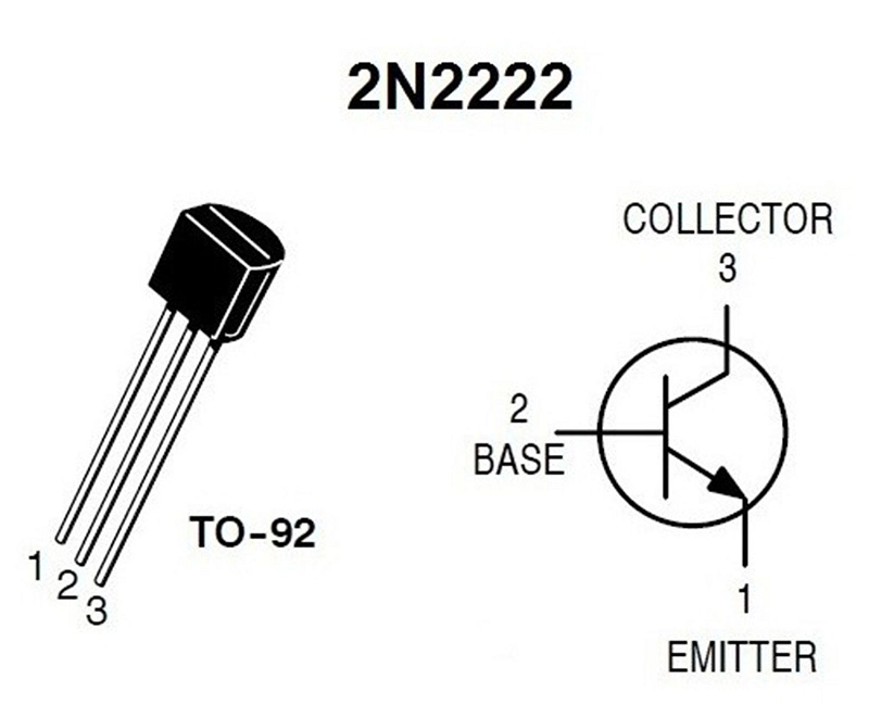

So I received the 2N2222 and will try it out later today. The drawing supplied by the supplier is below. So based on this. am I correct in understanding that the middle pin is base. With the transistor with the flat side facing me the left pin is emitter and the right is collector. So with the flat bit down the emitter and collector will be reversed

That is correct. Flat side facing you and legs pointing at the floor.
Flat side down? Would depend on leg direction.
Flat side down and legs pointing to the floor, then yes.
Martin
