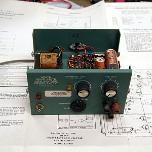

My ancient Heathkit bench supply died a while ago so I bought one of the 30V 3A variable power supply kits like the link below that are all over eBay to replace/upgrade the insides of it with.

3 years have gone by and I have finally come back to this project.
The first thing I did was look up how to test whether or not the 3 batches of "TL081" ICs that I bought have the offset circuitry; You simply measure the resistance between pin 1 and pin 5, looking for something in the 2K ohm range.
One batch came loose in a little ziplock bag, the 2nd batch with their pins pushed into a piece of pink foam (also in a ziplock) and the 3rd batch are in an IC tube. It was not very surprising that the only ones that passed were the ones in the tube.
I had installed IC sockets in place of the original ICs before I put the project aside so I plugged 3 new chips into them, turned it on and attempted to adjust the offset null. Turning R7 had very little effect. And when I turned the voltage pot up the voltage didn't increase.
I suspect that when the 2nd fake TL081 failed it took something else with it.
I couldn't see anything obvious but I will take another look at it this afternoon.
BUT I recently found this video about building a variable bench power supply with a commonly available LTC3780 buck/boost module. This looks like it might produce a better supply than the "red kit" could. And he used a switching power supply very similar to the one I am trying to use.
I have almost convinced myself to scrap the kit and order an LTC3780 module.
What do you think?

My big doubt about using an LTC3780 was that all of the bench power supply builds I could find that used it are from 6-8 years ago with nothing recent, which means that either all that needed to be said had been or something better came long that everyone started using (& talking about) instead.
I did more research today and figured out that they started using buck/boost converter modules that are designed to be variable power supplies.
So I shopped around and ordered an SK60 module for about what the LTC3780 and the linear pots would have cost.
https://www.aliexpress.com/item/1005007309288430.html
In my particular case (changing in mid project), using an LTC3780 would have meant that the front panel layout could stay the same.
With the SK60 I won't need the holes for the voltage and current controls or the overcurrent light and I'll probably have to enlarge the hole for the volt & amp meter to fit the new module but I'll figure it out and the end result will be a lot simpler.
