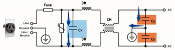

This type of capacitor is typically used to suppress noise and it is constructed to go "open circuit" in case of a defect. In that case the rest of the circuit usually continues to operate, only noise suppression is reduced.
You can even remove it completely and the unit will still work. Note, however, that you should re-insert or replace it to keep the unit within specs with regard to noise suppression - not only with respect to the unit but also wit respect to emission of noise which may disturb other nearby units.

: X capacitors (blue) are designed to filter (noise) specifically EMI (Electromagnetic Interference) as you can see since the capacitor is in parallel as stated before" it can be removed" your particular capacitor has failed (shorted) from line-to-line . Potentially that is why your unit is not working. It is inferred that you know how to solder hence desolder.
Provide me the lead spacing and dimensions and I'll supply you with three separate distributors to choose from on your new capacitor. Y capacitors (orange) filter line-to-ground interference. (Image source: KEMET
