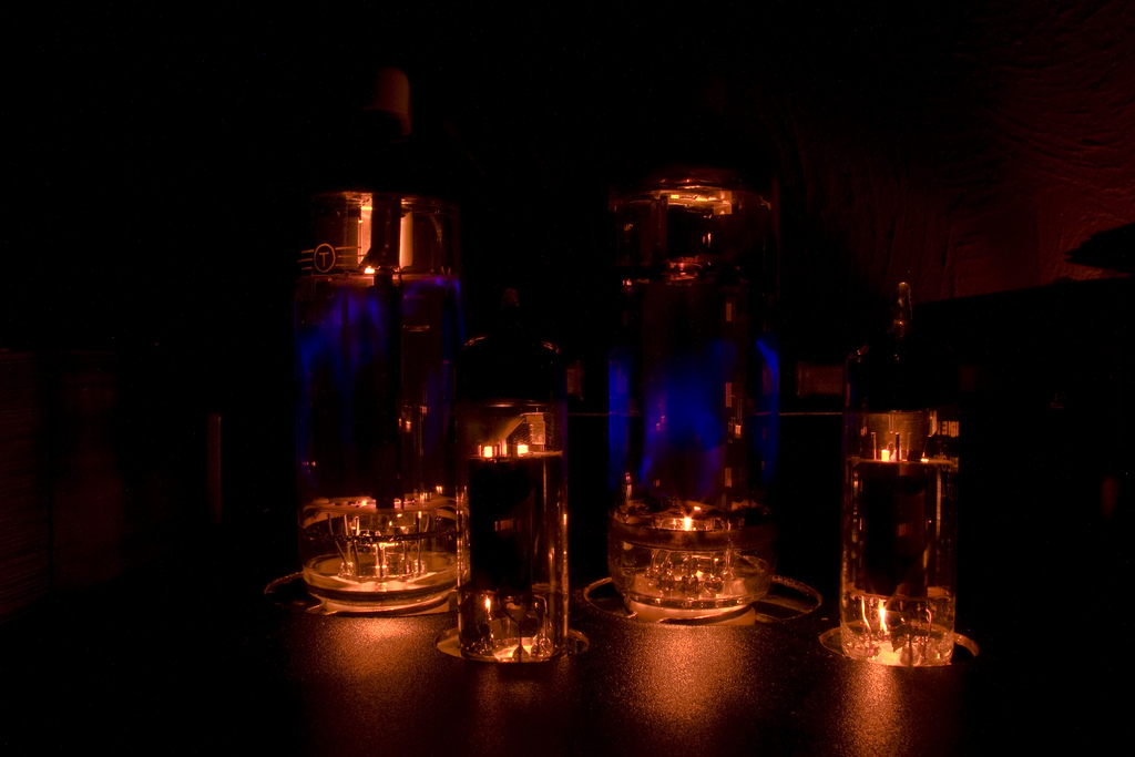

Sir Flybacks . . . . .
there is a blue little ? spark ? inside the crt glass
Its REALLY a BLUE GLOW . . . . that's been around for multi . . . . . D . .E . .C. . A . . D . . E . . S
In case you are not familiar with any tubes that have a vacuum PULLED on them . . . . this can occasionally occur . . . .
DA'BLUETUBEINNERGLOWPHENOMENON . . . . . . DONTWORRYBOUDIT !
https://blog.thetubestore.com/understanding-blue-glow-in-your-amp-tubes/
