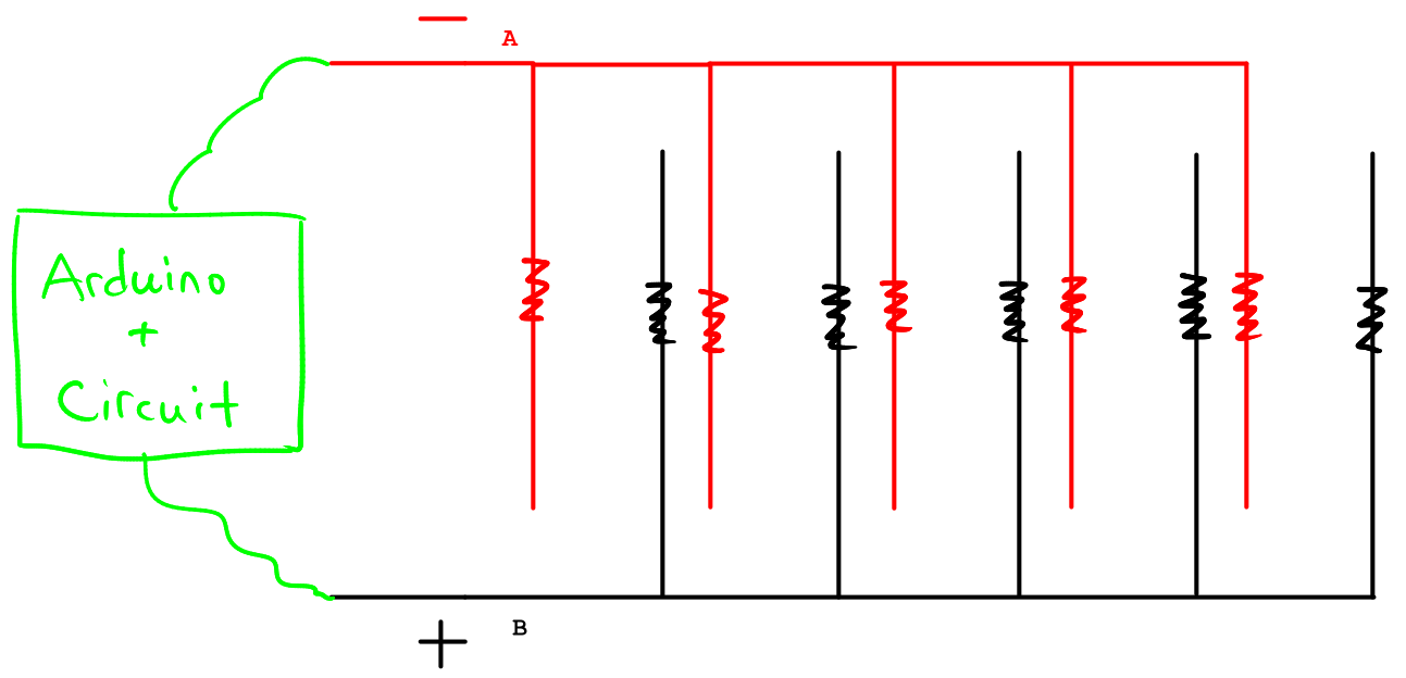

Thanks. Yesterday I have studied series-parallel and shortcut circuits. I have learnt a method by using letters. And I draw this below schematic on a web-based simulation software, but It says 18 bad connections. Does It look OK?

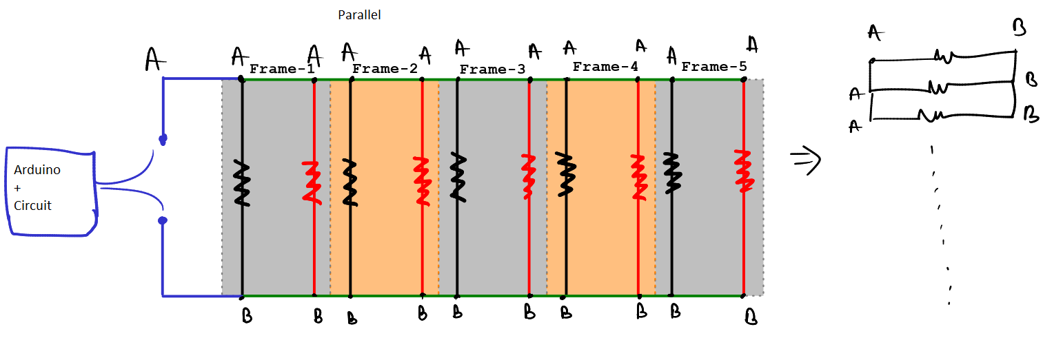

@Harald Kapp I think I figured out the problem with the frames. Please let me know If the logic is possible. I will explain it in 2 schematics. In the first one there will be no current flow as you pointed out.
BUT If there are bees on it and they touch the red and black wires at the same time, as in schematic below, wouldn't they get shocked? And I think this might help with the heating, preventing current flow when not touching. + It also looks parallel.
I indicated their touch with green lines on 2nd schematic.
Possibly. I don't know whether 24 V is enough to shock a bee. Nor would I know how much resistance a bee presents to the circuit. Definitely nota short circuit, so current will be less than you expect.
Can you estimate how low would it be? They basicly will swarm all over the frame once a single drop of venom is dropped. I will try the setup on Tuesday or Wednesday (depending on the weather) and will post the results.

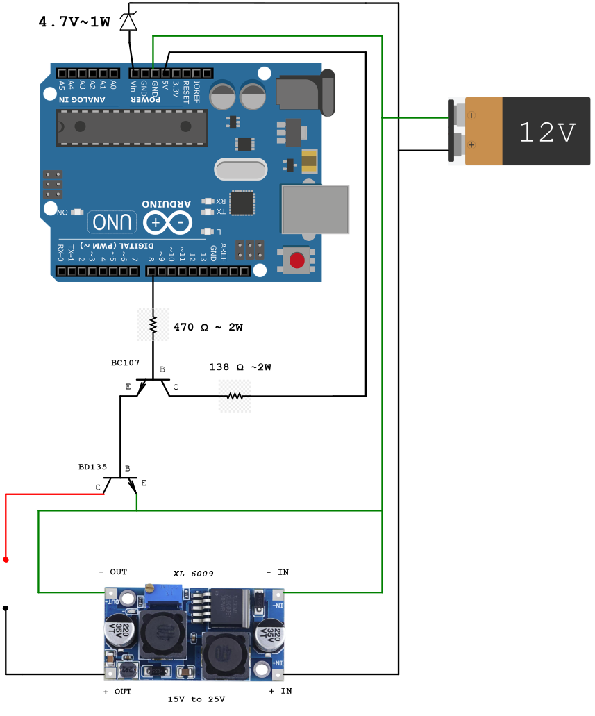

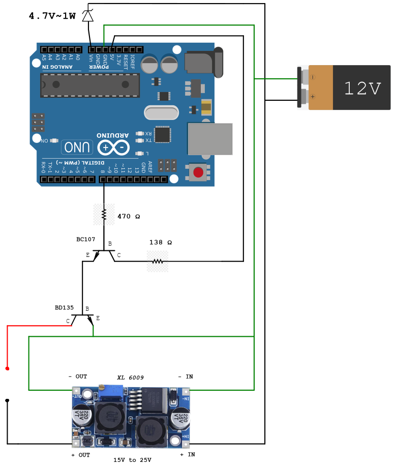

What should be the 138Ω resistance's W value? I have 138Ω ~ 2W.
(5V/138Ω = 0.036A ; P = 0.036^2*138 = 0.18W looks OK, I guess.)
If you see any error on the final schematic please let me know:

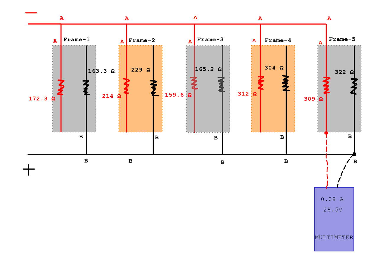

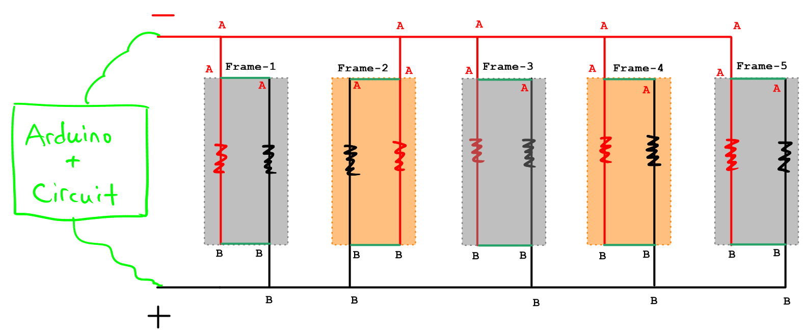

@Harald Kapp I have stabled the system in a plastic box and measured the voltage and amps only on 1 resistance wire (0.08A - 28.5V) as in schematic below. Because I haven't build the terminals for connecting the + and - yet and I want to try as in post #83 first.
(Also Frame_1 red wire: 0.17A and 28.5V)
At below schematic it is connected as parallel, where R_eq = 46 Ω. In that case, can I assume the current on the 309Ω wire (i_9) would be around 0.6A and If I want to decrease this current, can I do it with a potentiometer? I feel like this assumption is wrong because i_1 on schematic below would be more than 1A in that case.
Tomorrow I will try as in the first schematic which will require lots of bees to touch + and - at the same time and then later I am planning to try as in 2nd schematic.

No, potentiometers are niot made for that high current.
Hello. I have tested it on the hive. I think I need less current. ( I probably need those thick copper resistors.) I want to see the current on each frame before getting a resistor conencted. Can I connect one of these (English schematic is at the middle of the page) on each frame?

My BD135 is also dead. (It died before Arduino.) I measured arduino's pin_8's voltage as 6V whereas it should be 5V. This might be the cause of BD135's failure or just a faulty unit?
Harald Kapp
Nov 17, 2011
14,317
Nov 17, 2011
14,317
It is possible that you accidentally applied a voltage > 5 V to the output pin of the Arduino, thus destroying the Arduino. The transistor could be dead due to overcurrent that occurred when you experimented with your setup.
Is the Arduino completely dead or only the output pin you used? If the Arduino per se is still working, you can simply use another output pin.

This time bd135 is dead again (I think it started to melt). I adjusted the voltage regulator to 29V. It run 75min without any issue. I re-run the system on another unit. This time gray smoke came out from BD135 after 5min. I don't understand what would be the problem. (I measure 5.5V on Arduino's output pins without conencting anything.)
Harald Kapp
Nov 17, 2011
14,317
Nov 17, 2011
14,317
You may cretae short circuits (or may have created short circuits) between the "+" and"-" wires in your grid somewhere. place a series resistor between the collector of the BD135 and the grid, e.g. 100 Ω to protect the transistor from overcurrent. Also check your wiring and make sure the "+" and "-" wires do not touch.
