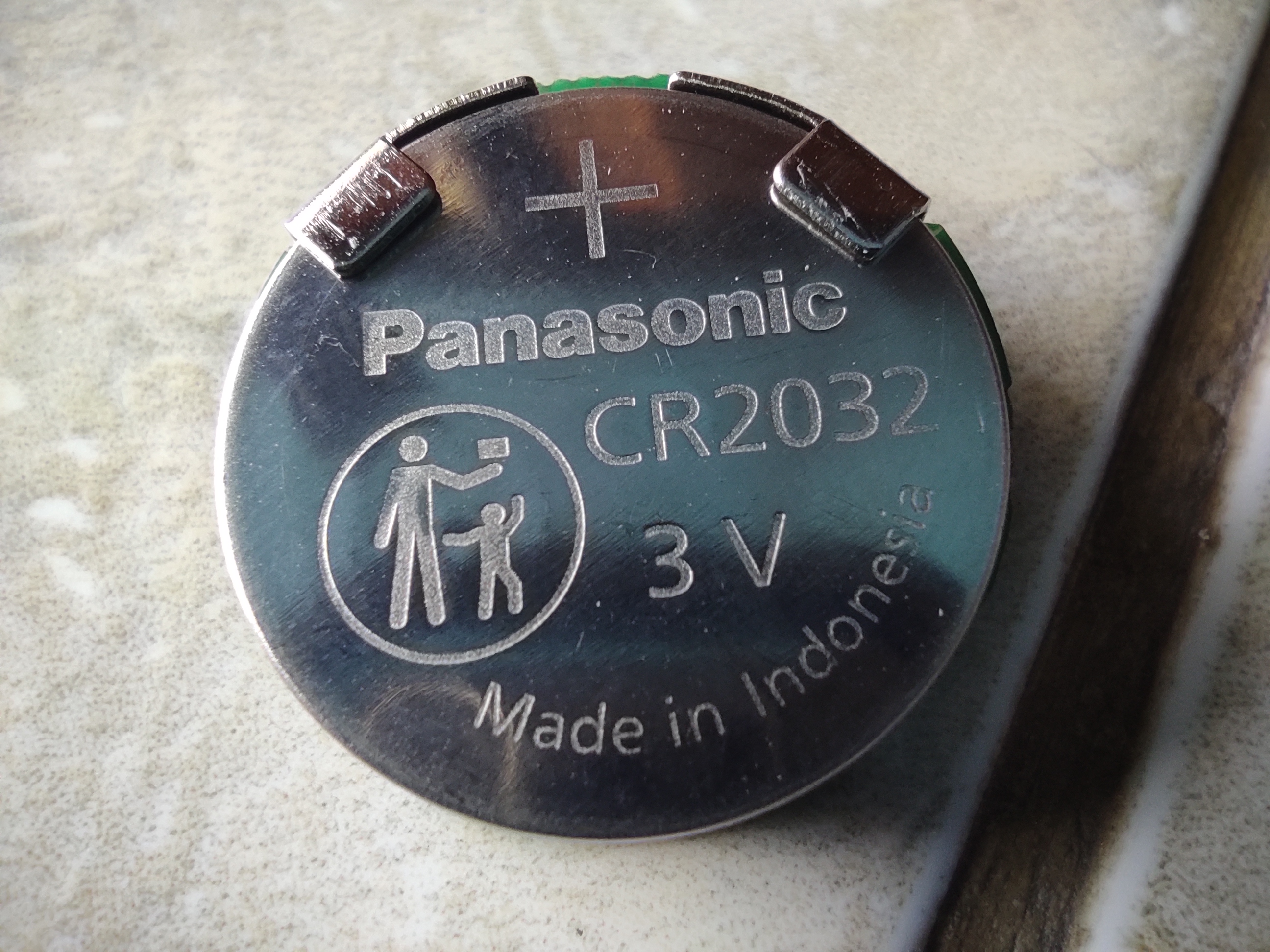

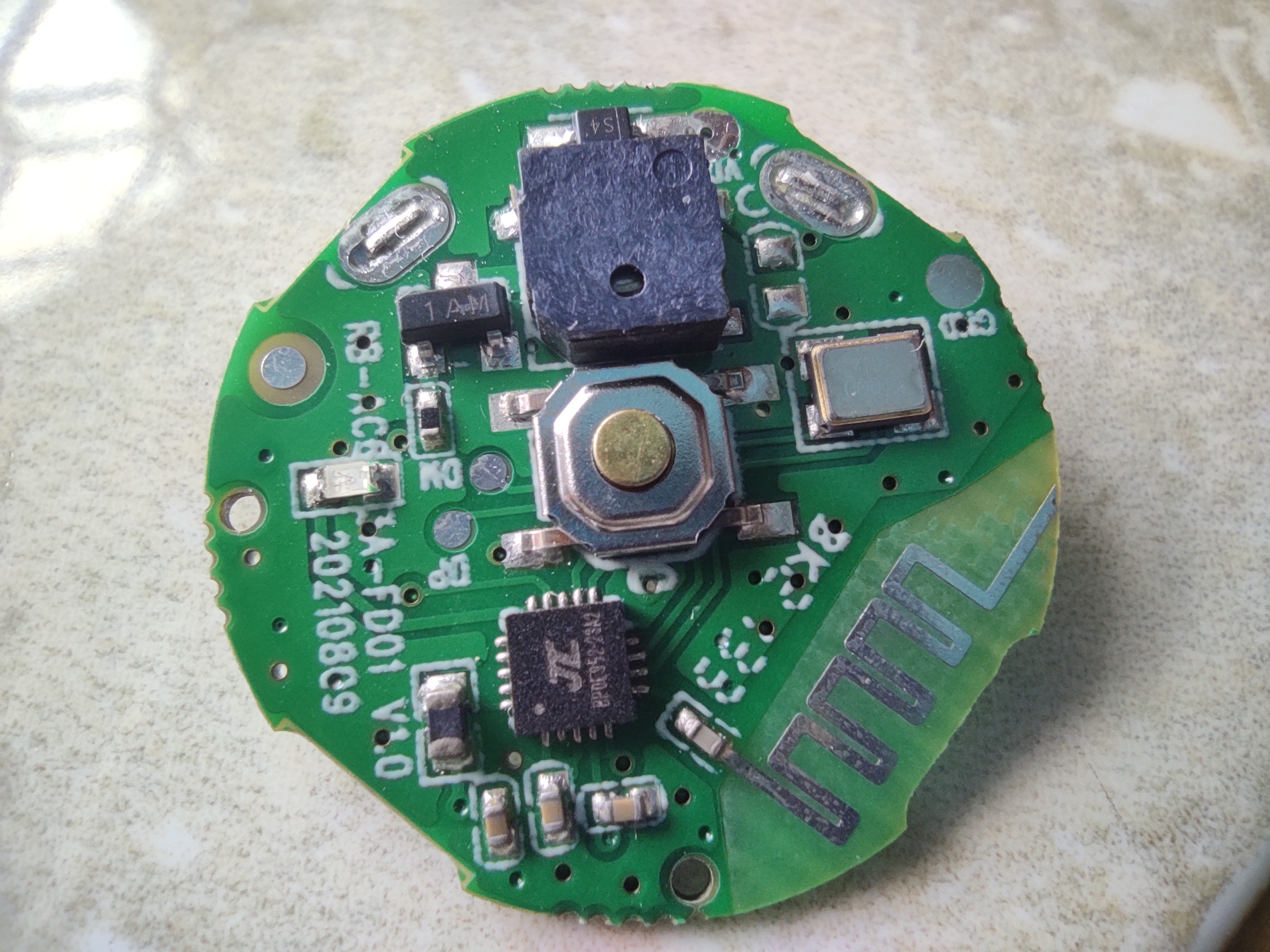

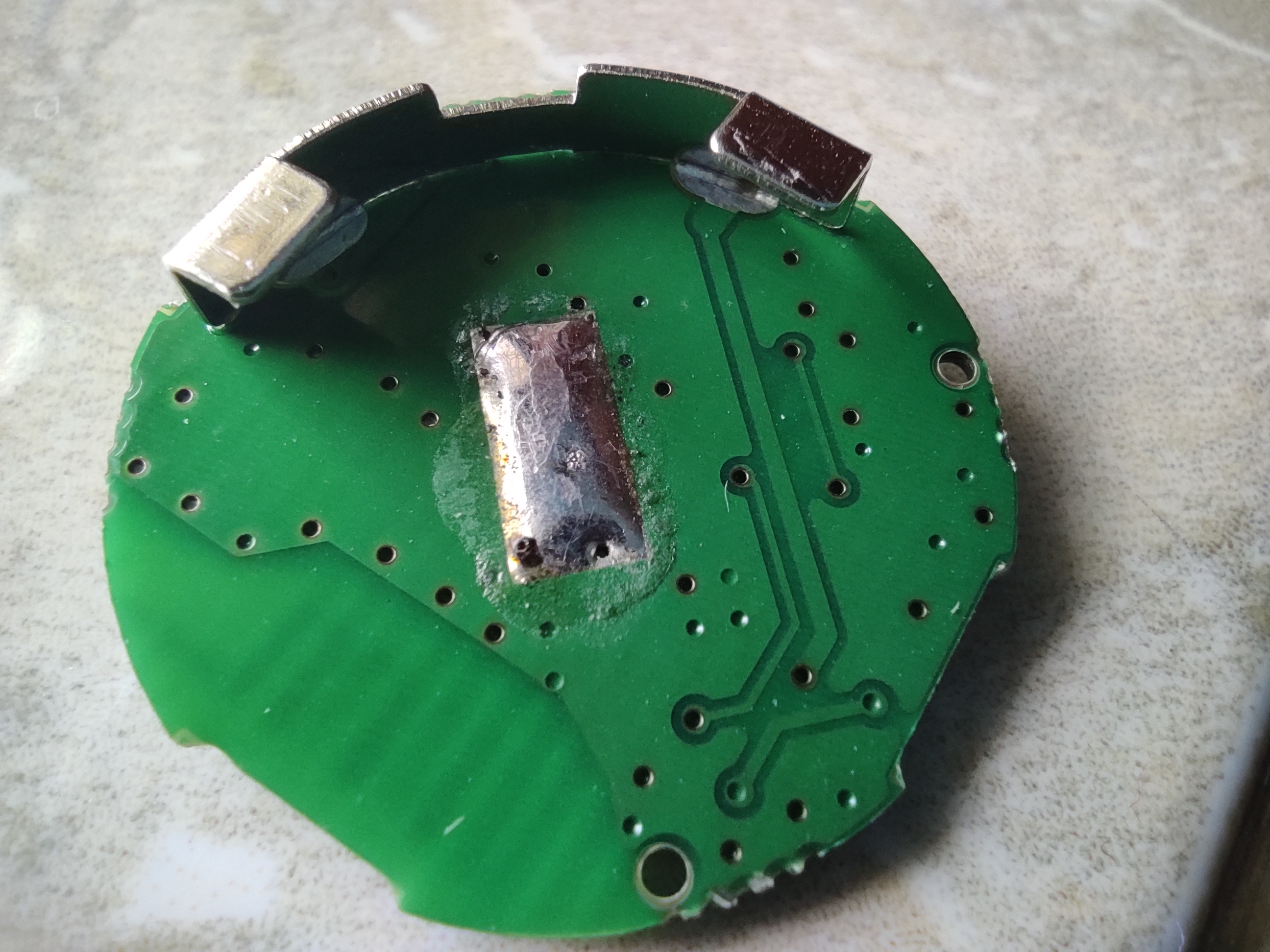

So I have a tuya smart key finder that using Bluetooth technologies, and they claim it can last up 6 month 1 battery, but when I use it, only lasted 1.5 months and it self shutdown.
I'm fed up changing 2032 cells, now I got a thinking.. Can I instead keep using 2032,i wired this device to a single lithium battery (18650 or 14500).
But I'm afraid damaging the circuit, I heard 2032 is 3.2V max, meanwhile li ion has max voltage 4.2V.
Probably second alternatives is putting 3 AAA rechargeable energizer battery it would result 3.6V... What u guys think? I don't mind it getting a bit bigger-atleast it lasting a lot longer.
Here is the device pics :

Changing the voltage or battery shouldn’t cause any issues providing the new voltage is stepped down to 3.2V.

I'd tend to try using quality CR2032 cells first.
This panasonic is the most high quality ones sold in my country.. Got other brands like maxell but fake maxell is everywhere in stores like a plague.
Maybe tell me some brand of 2032 that u think is high quality, and I'll try to look up. The brand I familiar is only panasonic tho. Is panasonic not good?
Martin
That's the problem, I dunno how to step down that small fraction from 4.2v to 3.2v...most step downs here draws current even at idle (60mA) and it's quite larger than the tuya key fob itself

Two alkaline AA or AAA cells will give you ~3V. Non-rechargeable, but should give far longer life than a CR2032.
yeah i was thinking about this, its okay its disposable battery atleast lasted far more longer though. Will try it.

may i know why use 2 diodes ?
To drop the voltage by 1V or 1.2V. Each diode has a voltage drop between 0.3V to 0.7V (approx) depending on the diode type. It’s just a crude way rather than dividers or regulators for such a small amount.
