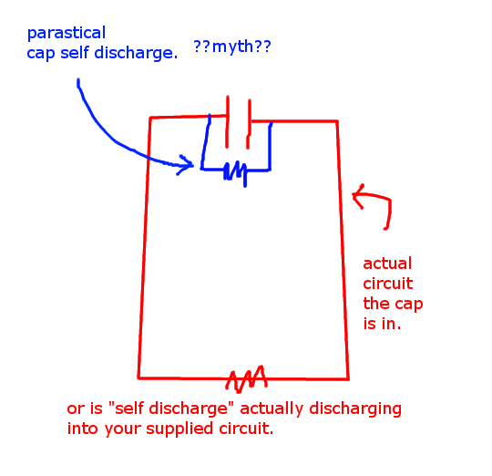

Ok. So myth busters time.
When people show cap self discharge, you may get a mental picture like this.
The blue circuit, is it false or factual - it means the energy has bypassed the circuit to the other side of the capacitor without touching the circuit - or does self discharge mean the capacitors are constantly letting go but its actually into your provided circuit.
It makes a big difference, if its at least making it to the circuit you might still be able to use the energy, otherwise its a useless waste completely.
But I just thought of something, it means that if a capacitor isnt in a loop, it'll never leak current - and that might not be true!

Self discharge happens internally to the capacitor (blue resistor).
If the capacitor were to discharge into the red circuit, this wouldn't be called self-discharge.

Martin, I think @ratstar wasn't referring to physical external bleeder capacitors. Self discharge happens when the unbalanced charge distribution (charged capacitor) between the two electrodes of a capacitor equalizes with time due to leakage through the non-ideal isolating material separating the two electrodes.

Ah yes, good point.
In that case a simple experiment can provide the required answer.
Charge a cap out of circuit. Measure it’s voltage. Let it sit all alone on the bench for 10 minutes, measure the voltage again. Keep doing this and you’ll see that it’s self discharging over time.
Obviously the time to self discharge will depend on the cap value.

Yep thanks for that, I understand now. So theres energy being lost that you cant get back, I wonder how much of the battery even enters the circuit, theres 25% just disappears without a trace, maybe more...
Not as self discharge within capacitors. That rate is typically rather small.
But if you wait long enough the loss will be 100 %.
