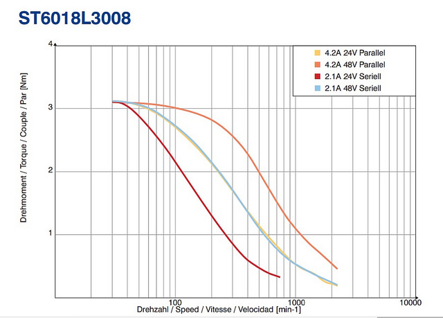

Lets now go on by looking at a diagram that shows the torque of a certain stepper motor against the stepping frequency:
The 4 curves in this diagram are to my personal opinion a good orientation to address the aspects of a stepper motor I would like to address in this chat, again welcoming critics, questions and additional inputs!

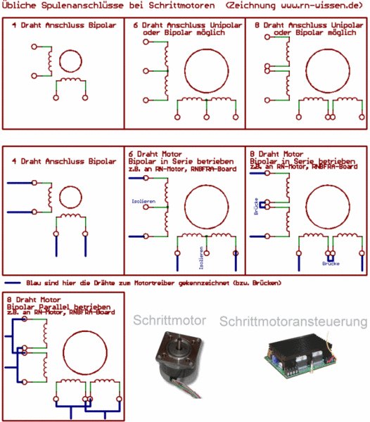

Lets go by parts! A simple bipolar stepper motor has its 2 phases and just 1 coil per phase. But if you take the third picture to the right of the first row and you compare it with the second picture on that same row you can see that the second picture is just a motor where the 2 coils in series are connected in series and that point brought out of the motor as a "center point" connection. To explain the meaning of the 4 curves never the less the third picture is more useful! If you now look on the third picture of the second row you can see that the 2 coils have been connected in series, while on the single image in the third row the two coils of a phase have been connected parallel! So 2 of the curves display information about the technical data of the same motor with the coils of a single phase connected parallel, while the other 2 show the information regarding with the coils connected in series. The diagram looks at the data connecting the motor once to 24 VDC and once to 48 VDC!
The diagram shows the torque available at the stepper motor for all 4 configurations and at both voltages against speed, which is equivalent to frequency of stepping of the stepper motor! Again risking to be seen as condescending and by no means being this my intention here my second question:
1. Why is the torque available from the motor getting smaller while the stepping frequency is increased?
2. Why are the 4 curves showing different behaviour and why are the torque over speed variation of the same stepper motor nearly identical when comparing the first curve with 4.2 A at 24 VDC identical to the curve of this same motor but with only half the current but at 48 VDC?

Question 1
The torque drops off as speed rises due to the inductance limiting the rate of rise of the current.
Question 2
If you have a motor with one turn on each pole, it will need a certain voltage and current to give a certain torque and will dissipate a certain amount of heat.
If you take the same basic motor but wind it with two turns per pole with wire of half the area and drive it with double the voltage, you will get the same current, double the torque and double the dissipation. The inductance will be four times the single turned motor.
It seems to me to be logical that the motor is run on a voltage less than the specified maximum. In the graphs you show, the torque never exceeds 3Nm presumably due to iron saturation so blasting a 4V motor with 12V is not likely to help you much.

Hi Minder, let me start explaining the responses to my questions.Every time the control circuit changes the inputs to the motor to have it step to the next step, yo may have on both, or on just one of the phases a change of polarity when dealing with full step motion. This change of motion represents a change of the flow of current through the coil and so an tension of opposed voltage is generated by induction. The faster this changes of polarity happens, as you increase the step frequency, the higher is the induced tension of opposite polarity. Those two tension, the one applied to the phase and the induced tension of opposite polarity add to a smaller resulting effective tension. So there will be a frequency, were the induced opposite polarity tension equals the one you apply to the motor. As the torque is proportional to the effective tension to the phases moves towards a value closer to "0 VDC", so does the available torque move towards "0" too as the diagram displays.
Now that explains why applying a higher tension to the stepper motor it will take a higher step frequency until the induced tension reduces the effective tension to the same value. So a right possible answer to question 1 is making the reference to the induced tension in the coils!
So a possible answer to question 2 is that doubling the applied tension makes serially connected coils in a phase generate the same torque at any frequency as having the coils connected in parallel, as the current splits in 2 equal paths flowing through the parallel connected coils! So if you want to achieve the highest possible torque, connect the 2 coils of a phase in parallel. The reason is that the full applied tension is effective over each of the coils, that means 2 torque generators adding their torque. Do you put the 2 coils serially that at the same speed on each of the coils you have only 50% of the tension!

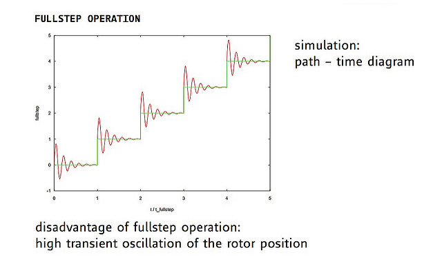

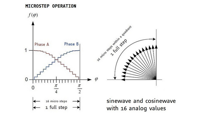

Another interesting aspect is the benefit of using microstepping opposed to full or half steps. let me share with you a story from the early days I did deal with stepper motors! I did use a stepper motor which I operated using a controller with the L297/L298 components applying 12 VDC. If I properly remember the nominal voltage of the stepper motor was 4 VDC. All I got experimenting with this setup was a stepper motor vibrating but not stepping at being noisy! Much later I got my hands on a controller board from the company Trinamic called "stepRocker" and found out that having 16 or more microsteps per full step made the stepper motor do its steps as desired. Why is this?
In full step operation each step represents a mayor change of the applied voltage level. Now in real life the voltage does swing and so might look like the red curve and not like the green one desired. The faster and the higher the change of the voltage level applied to the coils of a stepper motor is the stronger the amplitude of the swings becomes. Together with it, as far as I understand it, there are other parasitic effects which result in that at a certain frequency the stepper motor can not step as the fluctuation of the applied tension results in an undefined pattern.
basically what happens from microstep to microstep is that the polarity applied to the phases of the stepper motor is not switched in one step, but the voltage applied follows the values resulting from a sinus curve for which a lookup table is stored in the controlling IC. Now, the changes of the voltage applied to the phases of the stepper motor from microstep to microstep is much, much lower and in consequence the swinging is massively reduced, what also affects the other parasitic causes of "noise"! So with 16 microsteps per each of its 200 full steps of a full 360° turn my stepper motor did perfectly operate with the 12 VDC I did apply from a external source. So using finer and finer microsteps results in a much cleaner operation of the stepper motor and as a result it can move faster

The reason it is a 3Nm torque specified motor I guess. You are right, the laws of physics fully apply to a stepper motor as well. What probably because I am not an english native speaker I miss in what you write and my explanations are poor and may be the cultural differences generate the impression I am being condescending as good Old Steve wrote. Nothing is more distant to my intention. I choose the "chat" methodology for this thread because I am looking for people to discuss topics and so I do place questions to see if the point was known! let me try to repeat what I tried to explain:
1. The higher the speed a stepper motor is rotating the higher the frequency is at which it steps through the turn! Now I am totally confident that you know that an induced tension is related to the rate of change of the tension in a coil. So faster frequency of stepping means a faster rate of change of the tension at the coil and as a consequence the induced tension which is always opposed polarity is higher in absolute numbers. Now the induced tension adds to the applied tension so that the stepper motor just "see" the resulting tension! So es an explicit response to your question #1. What you write is correct, as the amount of current flowing through the cables in the coil is proportional to the effective tension. As the effective tension, the sum of the applied tension + induced tension = a smaller tension as the induced tension has the opposite polarity changing the equation from "+" to "-". I hope I have been able to explain this.
The focus to the issue I mostly see this aspect spoken about using the tension values, as the current is a result of it.
2. Here I am certain ywhat you say is right. Just happens in the practical world that you deal with existing motors, so the number of turns of the cable and the saturation are aspects the designer of the motor has handled. Most of the users of stepper motors just look at to what power in watt they need and what value of the tension is available in the system. Here I have like my found that users not familiar with stepper motors choose a stepper motor with the nominal voltage being the tension available in the system as you would do with other motor technologies. And this is not a smart way to choose the right motor out of available alternatives. Lets say a naval modelist, like I am one, wants to use a stepper motor for what ever reason for his model and he has a 12 VDC lead battery in the model. So he goes to ebay and looks for stepper motors of the desired power, lets stay with my examples, he wants 12 W. So most user not familiar with stepper motors tend to choose one with a nominal 12 VDC value and not one with lets say just 3 VDC nominal value. Here he has 2 choices, at least. One is to have available the maximum power and as consequence torque a stepper motor can offer. The he should choose the one with 3 VDC nominal tension specification. He would apply his 12 VDC and as a result this same nominal 12 W motor will offer 4 times the performance/torque and will be able to support higher stepping frequencies and´as a consequence higher turn rates!
