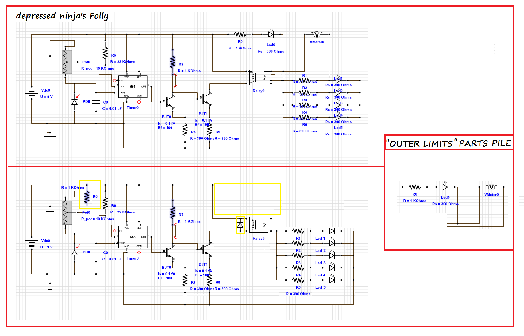

Hello, My name is Ethan
I am currently doing a B-TEC level 3 extended diploma in electrical/ electronic engineering at City College Coventry
I have my final project that I am doing which needs to be completed and handed in by Friday 27th May.
I am building a circuit that is an LED cube (Lamp) That turns on due to it being dark (using an LDR)
I wanted to know if anyone could see if the circuit I am doing is even feasible. or whether I am completely screwed.
https://gyazo.com/6b5bc9c539c2fb2e94a32b4d36793861 That is a screenshot of the circuit drawing its kinda bad quality and there's an image of the drawing.

Apart from design issues with your light detector, 555 circuit, transistors and relay, the left side looks fine.
The right hand side looks fine other than it won't work.
How long have you had to do this?
When did you start?
What testing have you done?
You can fix all of these things, but I hope you haven't got much else to do for the next couple of days.
Do you need to do a write-up on this as well?
I would probably start with just the 555. What do you want it to do? Can you find a circuit that does it? What are the input requirements and the output capabilities?
Then look at how I could drive the relay -- what is actually required?
Next, can I use the photodiode to provide the required input? Is another component more suited to this?
Finally, how can I use the relay to turn the LEDs on and off?

That is some creative circuitry.
I especially like the way the relay shorts the power, and the power and ground for the 555 and sensor circuit are routed through reverse biased LEDs. I would have never thought of either of those.
Also, honorable mention for the two redundant inverters between the 555 output and the relay coil.

Ahhhhhh so . . . .Most honnnable depressed_ninja. . . . . . . . . . . .
Circuit . . . circuit . . . how thou doth not work . . . . let me count the ways . . . . . ( Shakespeare . . . . or Confucius . . . . .or Plato . . . .or Pepe Rodriguez and the Tijuana Pimps . . .or someone ? )
I wonder of you did not smell the odor of burnt carbon at one extreme of the left top corners pot in its adjustment, HOWEVER on a 10 K units resistance slurry mix, there just might? be enough series resistance between the short path that either resistance elements end, takes in getting to its companion end terminal, so as to not have that low of a resistance value.
If you burned out one ends connectivity, install the current limiting / range limiting resistor R0 as shown in the YELLOW box for preventing another future boo-boo..
Strip off some parts to make the right end circuitry as is being shown, on the lower plan.
Add in an EMF kickback supression diode as shown in another YELLOW box.
(1N4001 thru1N4007 series . . . . . or 1N914 . . . . or 1N4148 . . .what have you. )
The relay will probably be activated and the LEDS lit unless your left circuitry might actually be working and engaged.
If not, jumper across BJT #1's emitter resistor . . . R9 to ground . . . with a jumper clip.
I'm standing by to see your results . . . . . for an upcoming branch in the thought process road.
With the idea being to to initially establish a working circuit on that right side and then progressively work towards the left side circuitry.
