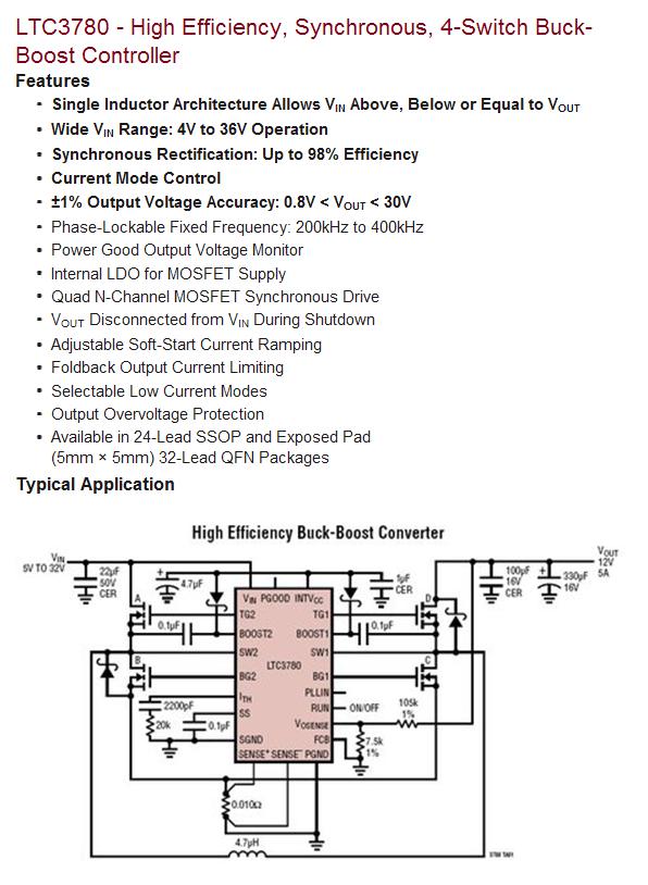

Someone on another forum suggested this:
eKretz
Apr 8, 2013
251
Apr 8, 2013
251
Well, that looks better than the first, but it says right on the schematic it's only good for 12V, 5A (60W) on the output, and if your NUC is pulling 65W it's going to use more than 5A at 12V all by itself.
