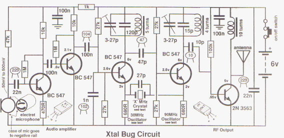

Hi,
I have built a few FM Transmitter kits - all using coils. These tend to not be stable in terms of frequency.
I'm interested in building a crystal-locked FM tracking transmitter using one of the more readily available crystals - e.g. a 10Mhz in a third overtone mode to get to the normal FM band.
With a tracking transmitter I mean a circuit that will produce a beep or continuous tone at a certain frequency.
Has anyone built something like this and can someone tell me which approaches works well?

I found this circuit (from http://www.talkingelectronics.com/):
Can someone please have a look and tell me if the design seems sound?
It uses a 10MHz crystal.
This is not a circuit for a tracking transmitter - it's a normal FM transmitter - but I thought it's a good place to start.

Hi Steve,
The first circuit diagram is from this page:
http://www.talkingelectronics.com/projects/CrystalLockedBug/CrystalLockedBug-1.html
The second circuit diagram I cannot link to directly - the site has some kind of frame detection that disallows direct links - its at http://www.gw1tdv.co.cc/, under the menu item "AJP Circuits", labelled "300mW VHF Tracking Transmitter"

The second one won't work for a normal FM transmitter because it's not actually frequency modulating the signal. I can't actually get to the site, I am basing this on the explanation you have copied.
The first one seems to be a better option.

Thanks Steve,
I will attempt the first design.
what you really mean is a Beacon transmitter... tracking transmitter.... strange termimology
the second cct as steve said isnt Freq modulated, in fact applying modulation to the final stage is more similar to Audio Modulation
the tone output from the 555 cct needs to be applied to the crystal osc via a varicap diode
remove the 22pF variable cap and replace with a varicap a BB102 or similar and apply the tone (via a 10k trimpot for level adj) to the junction of the diode and the crystal.
then you have a FM TX :)
see modified cct below ....

Hey Dave,
Tracking transmitter - must've picked that up from some of the sites I've been to trying to get more info.
Let me try and understand - I remove the 22pF variable cap - put the diode in there (polarity? anode towards the crystal?).
Which pin from the 555 produces the tone output?

In terms of the first circuit then - it's supposed to be a low-power FM transmitter (not a beacon transmitter) in the normal FM band at 90MHz.
Do you think the design looks sound?
