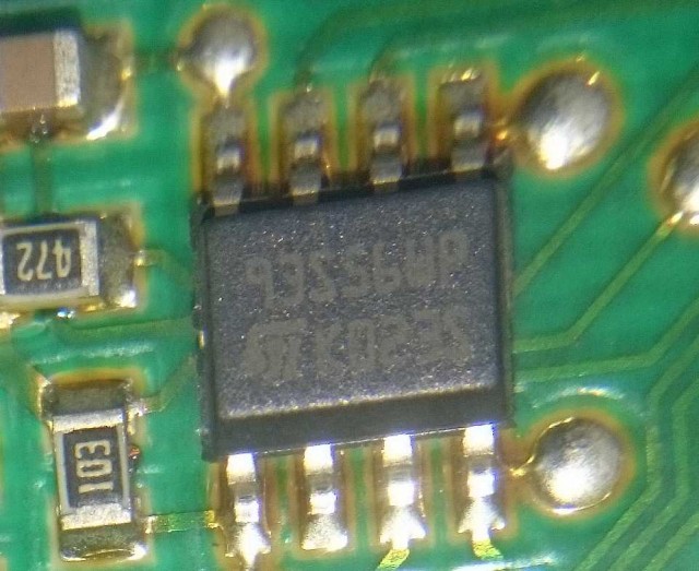

datasheet for this IC
pharaon
Oct 28, 2014
458
Oct 28, 2014
458
i wonder if anyone got datasheet for this IC , also want to know if it's possible to reprogram it
i also wonder if such PIC PROGRAMMER USB SMD can reprogram it
or does this one able to reprogram it K150 USB PIC Microcontroller Programmer

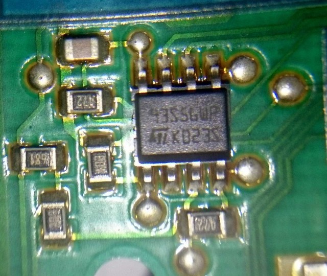

This is a ST 93S56 EEPROM. A PIC programmer is imho not suitable for programming this chip. It is, however, easy to program such a chip via its serial interface from most any microcontroller (arduino, raspberry, ...). For most of them you will find ready to use libraries (e.g. for arduino here) to program such a chip.
You will have to remove the chip from the board - otherwise you risk not being able to program the chip due to interference from other circuit parts on the pcb.
Where do you get the contents from that you want to program into the chip?

the file from the link is m93s46-w, is it the same?
The file shows data for M93S46-W M93S56-W and M93S66-W. The difference is in the memory size.

the memory of M93S56-W is 2k bit
