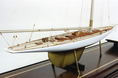

Hi friends, I want to present an important project that has come up during my project of building from scratch a sailboat model. I use this project as the platform to engage in the most diverse fields and here is one of my babies!
I started with my sailboat project when it started to get evident that I would not get hired for any new job and so I searched for a project that would not demand much cash and that would help me to have my days filled with activity and by keeping my brain active to succeed to master this difficult condition! I used to build sailplane models as a kid and during my time at the university, but those crash and that implies the need for money. Ships do not crash, worst case sink in a pod at a close lake and so are recoverable. I had very little knowledge about sailboats and so i purchased a plan and start to build from scratch. here a picture that shows how that boat is going to look like some day in the future:

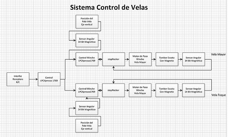

This second picture shows the sheet implementation as I want to make it happen on my sailboat Model!. In this model the technique used in the original sailboat, the Endeavour, is only fake as the sheet that goes from the deck to the boom at the very rear is what really controls the sail. In my model I need to be able to support 8400 mm of sheet length change so that what the next picture shows is achieved!
So this kind of "winch" capable to handle a sheet length change of 8400 mm in a sailboat were the hull is just 1650 mm long builds around electronics to establish a control scheme that uses a stepper motor as actuator. I have created a block diagram while trying to enable others to understand what the hack I was talking about!
Sorry for the text the drawing being in Spanish, but allow me to explain to get the picture!
This sailboat model, I will call it from now on Carina, is radio controlled. So some place at the border of a lake am I with a R/C transmitter. This used to be i.e. a 40 MHz R/C transmitter that poled the status of its controls and send them to a receiver in the model which received this 40 MHz signal and delivered at its 8 ports, called channels, a PWM signal that had a duty cycle of approx. 1 to 2 ms...
