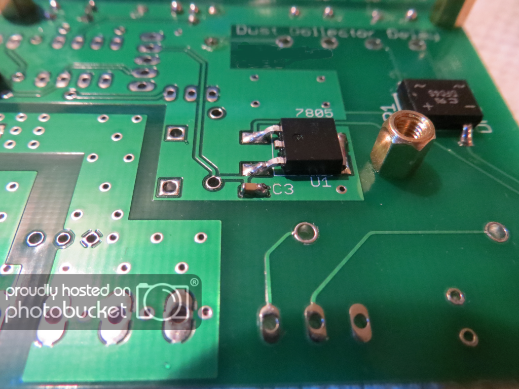

* Hardware: Refer to schematic or board. Power will come into the circuit via a rocker switch mounted through the 4" steel electrical box wall (not shown in
* schematic). The circuit is protected by an inline, 160mA slow blow fuse and comes on-board at connector CN1. From there, AC power travels through
* a transformer, providing isolation from mains as well as a secondary fuse (transformer is self limiting). The stepped down power gets rectified via
* BR1, full wave bridge rectifier. This is then filtered via C1 and C2 electrolytic caps before entering U1, a 7805 LDO voltage regulator and exiting,
* filtered by C3 at +5V DC. R1 provides a constant current for a power-on LED indicator via jumper J1.

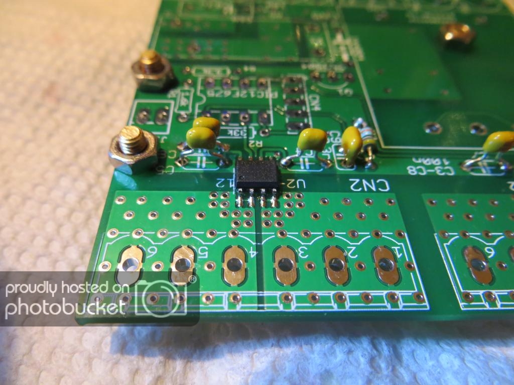

* The +5V output continues and feeds 4 more areas: the PIC microcontroller (PIC12F675), Allegro Hall Effect ACS712 chips, Q1 2n3904 power amplifier
* and the coil K1.
* When current is sensed in either Allegro chip, (this would be from an outlet in series with the chip via connectors CN2 or CN3, one for 120v and
* one for 240v) pin 7 will send out an analog signal (amplitude varies with current). This signal enters the PIC at pins 3 and 5 - one for each sensor chip.
* C4 and C6 are filter & C5 and C7 are bypass caps for the Allegro chips. I believe R2 pulls down the master clear (MCLR) Pin 4 so it's not left floating
* (R2 allows for 0.15mA of current to pass). R3 limits current, but allows mains frequency to to reach pin 2 of the PIC (CKLIN), while C9 filters the signal.
* Pins 1 & 8 are V+ and V- or ground with C8 filtering between. Pin 7 is the output, which will trigger the coil via R4 and Q1. D1 prevents backfeeding the
* circuit when the magnetic field collapses. R5 and C10 help to dissipate power as the field collapses. K1 will the relay separating power from our switched
* device.
