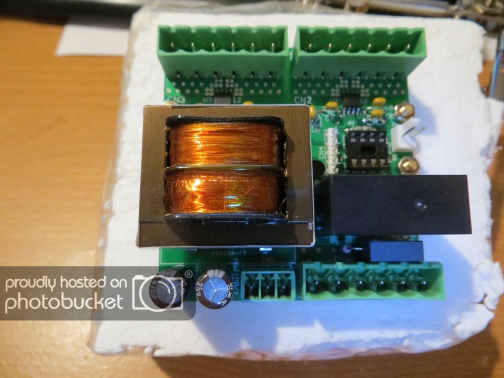

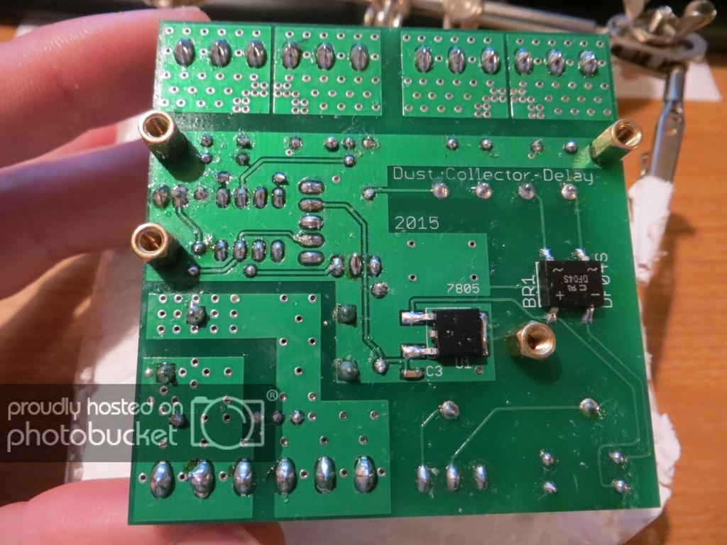

Just to bring everyone up to speed on where John is with this project, below is the "final" schematic with power supply, two Allegro chips, a PIC, and a relay. And below that are two images of the finished product. You can find all this on page 17 of this thread, post #340 for the schematic and post #334 for the photos. No need to read the entire thread.
upload_2015-1-4_23-56-16-png.17967
As Kris said in his post #334, "just" add some software to control it. :cool:

The hardware was essentially complete as of January 3, 2015. John has been learning how to program PICs since then. I offered to do the programming, but he refused to accept my offer. How is the man going to learn anything if someone else hands him a canned solution? IMHO, it was a good decision on John's part to do his own programming. The power tools and dust collection system still have on/off switches John can manually operate, so it's not like completion of this project is a pressing priority.
One problem might be he is uncomfortable with assembly language, preferring C. Compared to C, Microchip ASM is rather arcane and very specific to a particular piece of hardware. It takes careful reading of the datasheet to learn how to "bit bang" various bits in various registers to get the PIC to do what you want it to do. It isn't necessary here, but John has not yet had to operate against timing constraints and satisfy real-time response to events signaled by hardware interrupts. I suppose it is possible to do those things in C with an optimizing compiler and careful attention to the code generated by the compiler, but I wouldn't attempt it. For this project, C seems to be an acceptable higher-level programming language. I sometimes wish I were more comfortable using it.

Back on the hardware side of things, I successfully energized the circuit with no magic smoke! ;)
I was able to verify that the 7805 was doing its job via the J1 and J2 pins to a LED. LED lights when power is on. Only odd thing I noticed is that as soon as I powered up, the relay clicked... I didn't think that this was possible since Q1's base is currently not connected to anything since there is no pic chip in place. So after some sleuthing, it turns out the model I used in Eagle was an ECB instead of an EBC like the physical part I ordered.... :mad::mad::mad: and I thought I had cross checked all of my layout vs. physical components :oops:
Anybody know the part number or the fastest way to search for a ECB style 2N3904?
