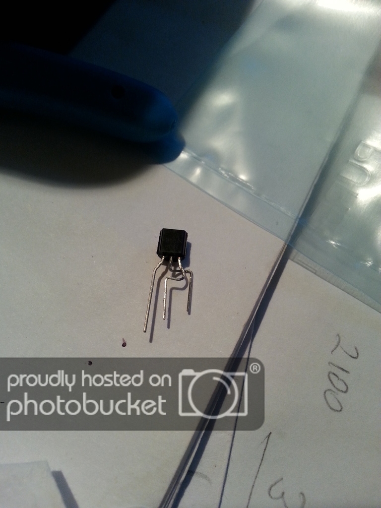

Trevor, my Fairchild 2N3904 datasheet shows EBC for the TO-92 package only. The only other pin-outs shown apply to their SMD packages.
When I'm declared King of the world EBC pin-out will be one of my first decrees. :D
Chris
Thanks Chris, I think I will follow the simple route and unsolder the existing part and fit in a new one with the legs bent to make it to the crossed holes. A little bending with pliers and perhaps some heat shrink tube for added protection and we're off again ;)

Believe it or not, it took three hours to desolder three legs.... I had a solder sucker, solder wick, flux gel and had to use them all as well as some other tricks like retinning the area, using another lead to super heat and push through, etc. I give much credit to the board manufacturer, the board held up like a pro. No damage, no lifting of the trace, etc. Tomorrow I will bend the leads and fit in the replacement and do another test power up.

@CDRIVE - that is brilliant Chris, well done. I wish I had thought of that!! I will have to pickup a soldering gun on the cheap to make into your desoldering idea ;)
Success, board saved, new transistor fitted into place. I did a little foldma-gami on the pins :rolleyes: and it popped right in. Tested and seems to be working.
Hop had mentioned to prototype by attaching small wires to the allegro chips, but as I looked at the board without the pic installed I realized that I can access the output of the Allegro from the pic socket! Pins 3 and 5 are the Allegro chips outputs so I can use this to mockup a current draw to give me an alternating AC to test out the software!!

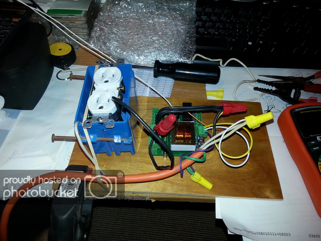

Back to software..
I have a test rig set up now to make life easier :D
yes, very ghetto, but it works and keeps things safe.
@hevans1944 - check it out Hop :D
:cool::D:cool::D

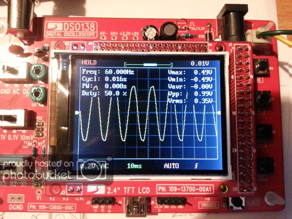

I used the wife's hair dryer plugged into that outlet in the test rig to give me a 4A draw through the run delay board circuitry, I used a jumper from the empty pic socket pin 6 to be my output to the scope. Nice readout, eh? My DMM gave me 0.363VAC so I guess that is close enough.
The next thing I tried was putting that jumper over to my pic dev board 2.0 on pin 6 and removing the on board jumper to disable the pot that was on that line. I fired up the run delay board with latest code (see below) and got..... nada - the light that was supposed to turn on when current was running was turned on as soon as the programming was done! I thought three things - a timing issue in the code, I tell it to turn on in the code, but the code is wrapped in a forever loop - while (1)? The port needs to be told to start in the off position? There is a flaw in the logic leading to a true condition outside of the parameters specified (well duh, right!) <sigh>
Does anything strike anyone in the code as to why I should be getting a light on condition on GP5 before even hooking up anything to AN1?
Thanks in advance!

Nah, that's not ghetto. That's a typical and functional test fixture.;)
