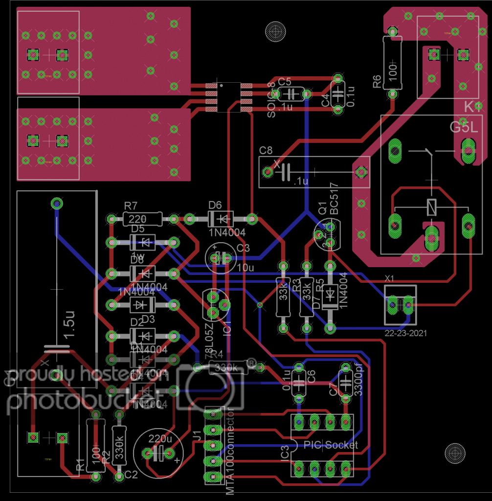

That's a lot better. I would avoid the track from pin 6 on the top side. I can't see the copper on the bottom layer but I assume it duplicates the copper on the top.
It's a number of years since I did any PCB layout so I'm pretty rusty on the details. I'm working on my own layout for the Allegro chip area which I may upload sometime.
What size are the via holes in that area? 30 thou would be fine; probably 24 would be no problem too. You could find out in advance from your intended PCB manufacturer.
Personally I use 15 thou tracks and 10 thou clearances for general signal routing unless the layout is tight, and this gives a very manufacturable board.
Changed pin 6 and yes the top and bottom layers are identical.
I would be interested to see what you come up with!
The via holes are 50 thou per your instruction in post# 53, I changed it to a 27 thou drill size - it was one of the standard Eagle presets. I went to upload the board to Seeed Studios, but I got an error - apparently the CAM is looking for layers that are not offered in the free version of Eagle! Doh :-( I may have to restart the whole process in another software.
Good to know, ty - I will keep the power traces at the larger size 26 thou if I recall and the rest are set for 16 thou - another preset from Eagle.
I meant the via size, not the hole size!
Cool.
Does Seeed Studios have a FAQ to advise you what software they support and recommend? And what settings to use?
16 thou is fine for the signal tracks, but the high-current connections to the relay contact should be as fat as possible, i.e. fills on both sides, like you did for the Allegro chip.

Hahaha - I was wondering why so large of a hole, thanks for clearing that up :) I fixed that on the board. I am looking at another manufacturer currently, Elecrow. Very reasonable for a hobbyist!
I tried to work out the area around the relay, but I had to violate a previous rule of not crossing under the relay. I think I understand why not to, inductance when the coil triggers. I have enclosed the most recent layout, let me know if you see a way of not crossing under from the emitter of the darlington to the relay coil.
Thanks!

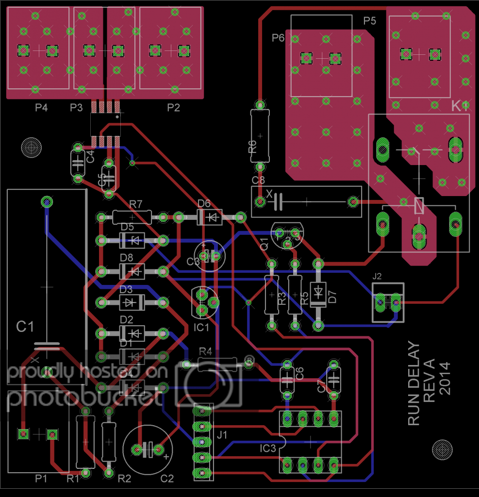

Re your layout in post #64.
Change the track from the relay's common pin so it runs directly upwards (under the relay) to the connector. The two coil tracks can then come straight out the bottom.
The normally closed pin is not connected but can be connected to the common pin to ease the layout. I would also rotate C8 90 degrees and move Q1 to the left.
Both of the tracks from the connector to the relay can and should be fatter.
Edit: There's no problem with having tracks running underneath the relay. You need to worry about clearance distances and track widths for high-current paths.

Awesome observation, thank you!
Moving the cap and res closer to the left allowed me to center the connector giving more room to create a larger plane. It's also stitched together pretty well I believe. I will download the other companies DRU and run it through the program to see if the clearances check out.
Are the pads for the relay adequate now?

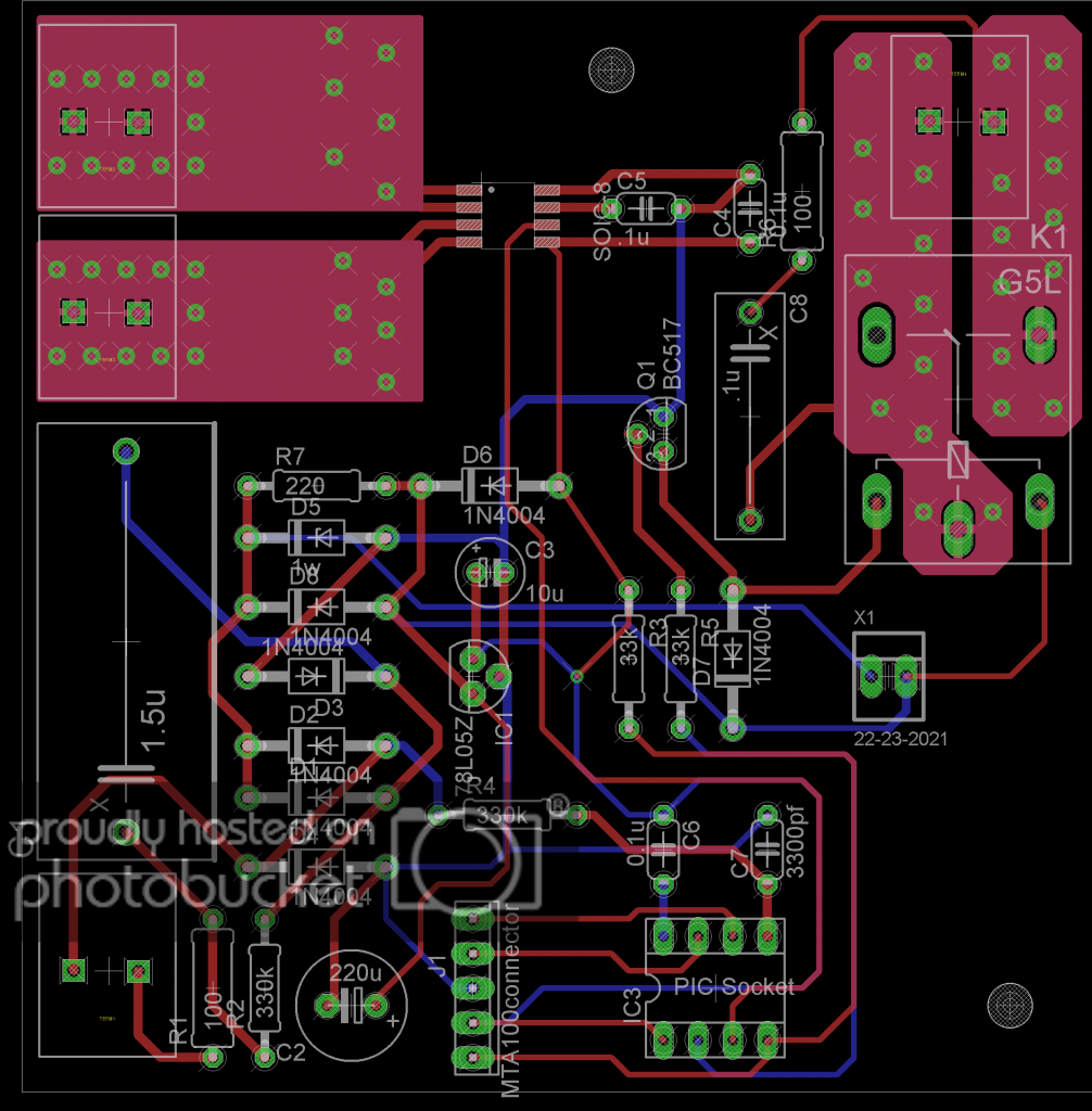

I was able to squeeze in another 2 connectors! I didn't think it would be possible :) Couple of questions: What prevents arcing between the pads of P3 and P2? or for that matter the small space between the soic pins? Also, if I wanted to upgrade the board in the future for 220v use on the switched side - Would the R6/C8 values have to change?
Arcing won't happen because there's no significant voltage between those points. Lots of current will flow through the Allegro chip but the voltage across it will only be millivolts. The clue to this is the fact that pins 1,2 and pins 3,4 are connected together internally by a section of metal. Current is forced to flow through this metal, which produces a magnetic field which is detected by the other part of the chip, but the voltage that appears across it is tiny.
On the other hand, the relay contact is different. When the relay is open, the whole 110VAC voltage for the controlled motor appears across the contacts, so, you need to maintain good clearances between the two tracks.
No, no change needed there. They're only approximate anyway.

The spacing between the narrowest spots of the relay pads is 100 thou. Do you think this is adequate? I did have the board checked for manufacturability and it passed :)
Yes, adequate.

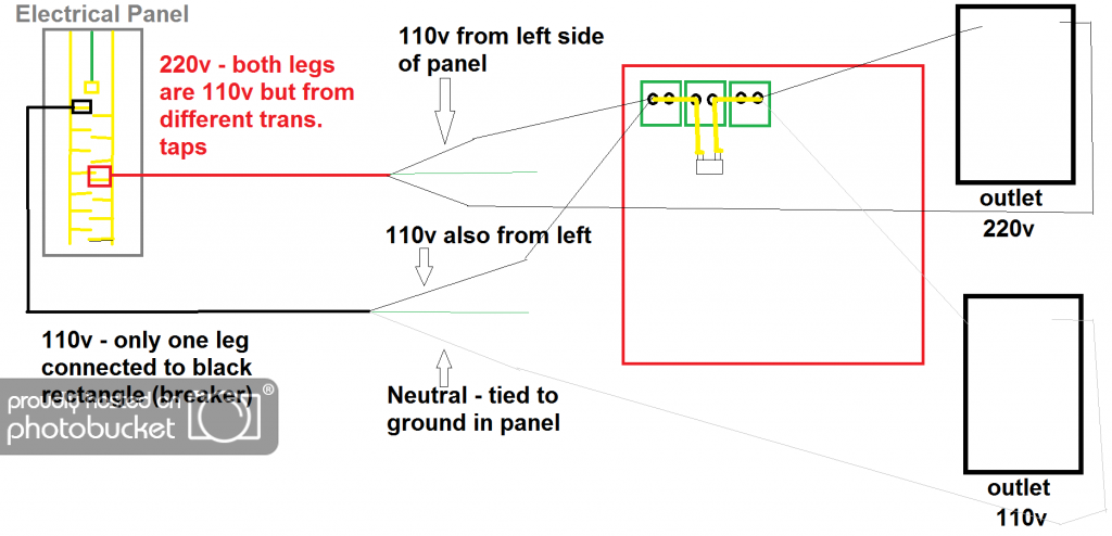

OK. I'm with you so far... So each wall-mounted box, with power receptacles for your equipment, will have one of these circuits mounted permanently inside it? I had already assumed that.
Yes sir!
OK, you've lost me here!
Are you planning to put two of these boards in each box, so each box will have two sensed outlets and two switched outlets and they work independently? Or would the sensed outlets be connected together, and ditto for the switched outlets? If the latter, then when power is being drawn through either (or both) of the sensed outlets, both switched outlets would power up. Can you dumb it down for me? I think I don't understand yet.
I'm sorry, I didn't give enough information. Let me elaborate further:
Because of space constraints I am only going to be able to fit one board in that box and have enough room for wiring and receptacles. Yes, I would like each box to have one 110 and 220 sensed outlet and one 110 or 220 switched outlet (the switched device will always (at least in the current thinking) be a singular entity so only one switched outlet needed - I can change voltages easily if I change machine types in the future).
I was thinking that I would be able to wire in series from the sensed outlets one leg of both the 220v and 110v. I would have to make sure the leg of 220 used was the same side of the panel as the 110 leg - our 220v is called split phase, the 220 is really two legs of 110 - each leg from a different tap off of the power pole. What gave me pause here was that I might have an accident where I might energize two sensed devices (one 110 and one 220) simultaneously exceeding the Allegro's capacity. This is where I thought I might need to switch the incoming currents.
With the wiring landing under the same terminals, if I use the same leg of 110 as the one hot lead of 220 shouldn't I still have 110v potential to ground on the 110v line and 220v on the other or will I end up with 220v on the 110v line? I see the 220v side becoming 220v when the circuit is energized and both 110v legs connect through the device giving 220v pot. to ground. I am concerned for the potential of 220v coming through the 110v receptacle.

Looking with fresh eyes, I would have to say that the diagram shows the bottom leg of the 220 circuit will cross over to the 110 circuit. The only way I see of making this work would be to either some how switch the incoming sources (110 and 220 separately) or forgo that and use two boards. I am not sure if I have room for two boards or for that matter a switch that could handle that kind of current.
You mentioned having the sensed outlets connected together in your question to me for clarification - do you see a way of connecting the two different voltage level sensed outlets?

I have one more update for the current version of the design.
Updated schematic:
A layout suggestion:
Paler tracks are on the underside. I think I went a bit overboard on the vias!
I'll respond to your other questions soon.

I thought you said your PCB skills were rusty!!! Wow, you got me beat and in one take, well done! I love how you were able to resolve many of the connections into common planes - I tried to work that out, but was getting tied up in the rat's nest too often. I like how you cheated some space, orienting the fusible resistors vertically. Nice move as those are pretty large resistors. :) One more addition, I was going to pull out the LED via a 2 pin connector so I can remotely mount the LED on the face plate of the outlet.
What connectors where you using in your layout for CN2 and 3? They look a bit narrow in perspective. My guess at the size of the overall board is about 10cm by 6.5cm?
Never too many vias when you don't have to hand drill them ;-)
You lost me on the positioning of the decoupling caps: I thought C4&5 were decoupling the Allegro chip, while C6&7 were decoupling the PIC
Are we still using the PIC12F675 or going back to F1571?

Sorry for the really slow reply!
So are you saying that your 110VAC and your 220VAC supplies have one side in common? So you plan to put the current sensing device in series with that common wire?
From your drawing it looks like you have neutral/ground, and two 110VAC phase busses, and there's 110VAC between each buss and neutral/ground, and 220VAC between the two phase busses, ignoring neutral/ground.
If that's the case, then I think your idea will work, but I can't comment on the safety or the legality of it. I'd suggest you ask a registered electrician with experience of industrial installations. I would be concerned that by commoning the wires at the board, you are forcing a requirement for connections at the electrical panel. Normally, an electrician would be free to move loads around. But with them commoned like that, if he changed the wires round at the electrical panel, he could short out a phase.
As for the choice of relay, it's up to you. Personally I would use one with the coil at one end and the contacts on the other, simply because it's more direct. But it's not a big deal.
I guess the best solution would be to have two independent current detecting circuits on the board. That would require two Allegro chips. The signal from the second Allegro chip could feed into pin 2 of the micro, and R5 could move to pin 6 or pin 7, so the only extra components would be the connector(s), one Allegro chip and two capacitors.
The connectors on my layout are Phoenix Combicon types. I gave links in post #55.
The board is exactly 4 inches horizontally, and 2 inches vertically, between the mounting holes. My PCB CAD package does both metric and imperial, but it's best to use one or the other, and all of the other components were imperial, so I used imperial spacing for the mounting holes as well.
C4 is the decoupler for U2.
C5 is a filter capacitor for the signal inside U2.
C6 is the decoupler for U3.
C7 is a filter capacitor for the mains frequency signal that feeds into U3.
Either the PIC12F675 or the PIC12F1571 can be used, with a slight change in the firmware.
