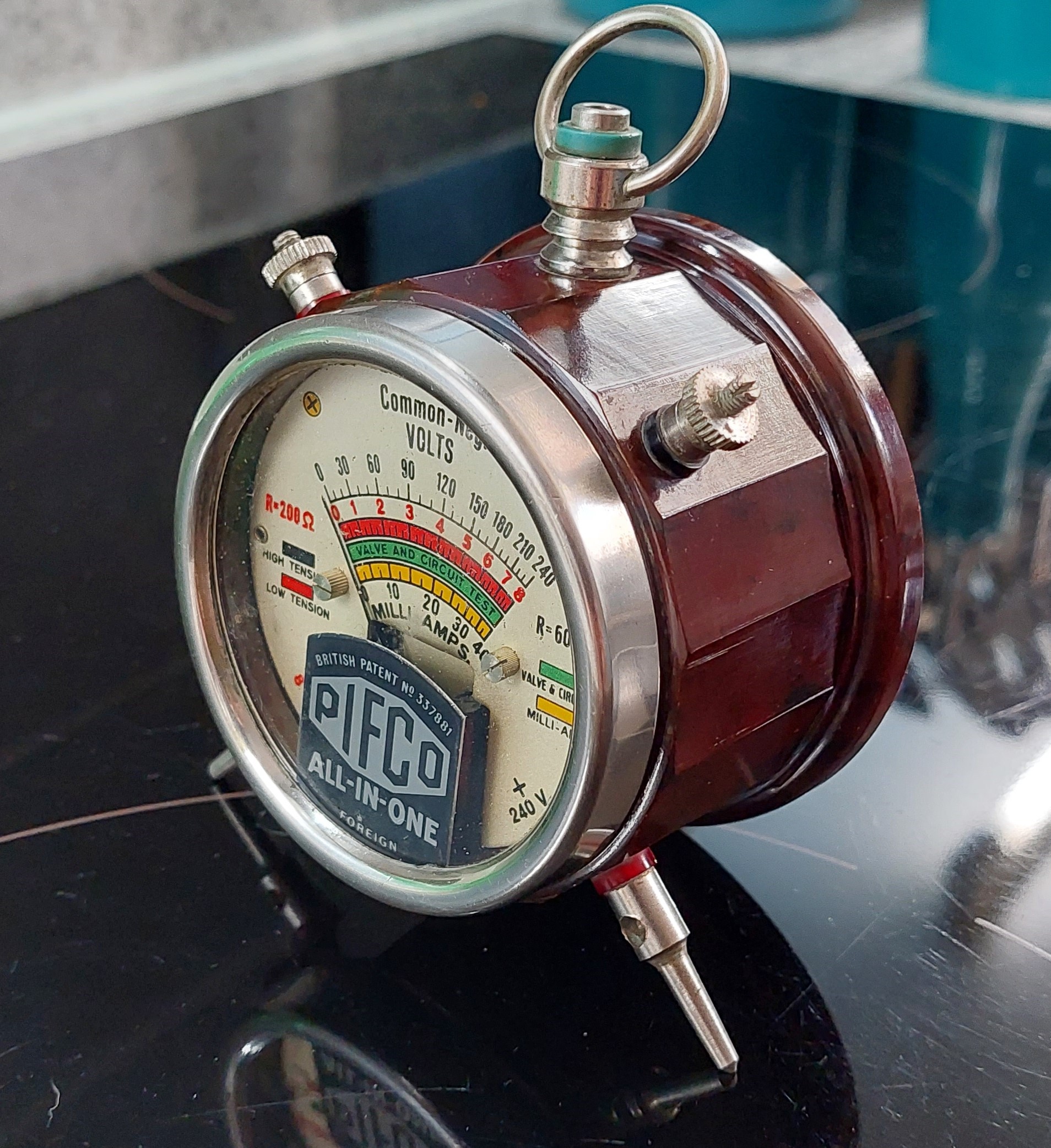

Hi,
I have this beautiful, Bakelite, c. 1930s, all-in-one multimeter built by PIFCO.
I'd like to display it, but I'd also like it do something!
The specific something barely matters :) maybe a CPU usage indicator, maybe internet bandwidth, maybe soil humidity for my greenhouse.

Limitations:
  • I cannot see any way to open the device without damaging it, so I'm not going to do this. Needs to work "as-is"
  • Guage needs to cover the range 0 - 8v DC or 0 - 240v AC
  • Raspberry Pi can produce only 0 - 3.3v
  • Single, concealable, slender power wire to supply both controller (Rasp Pi) and any additional circuitry
  • Raspbery Pi can also simultaneously supply a constant 5v (no programmatic control)
  • £50 GBP (approx $60 USD) budget for additional components
  • I have the knowledge of 2 weeks electronics at school 25 years ago! Basically an idiot!

Send the Raspi output to a simple op-amp configured non-inverting multiplier (x2.4-ish) to get 0-8V. Don't bother with the 240V option as it requires dangerous voltage levels at aren't actually required for your application.

The meter shown in your image shows "R = 200 Ω" for the 8 V range. This means any amplifier you use needs to be able to drive this load which translates to >= 40 mA. The ones from the filtered list in my link should be good.

Let me propose this idea:
  1. Use an adjustable boost converter (example) to create 8 V from the 5 V you have available.
  2. Create a 3.3 V PWM signal by the Raspberry Pi (I think this is what the Rasberry Pi does anyway when creating an "analog" output).
  3. Use a logic level MOSFET (examples) to convert the 3.3 V PWM signal to a 8 V PWM signal to drive the gauge
Like so:
At a duty cycle of the PWM of 0 % the MOSFET will be permanently off, output to the Gauge will be 0 V.
At a duty cycle of 100 % the MOSFET will be permanently on, output to the Gauge will be 8 V.
For any duty cycle in between the output of the MOSFET will switch rapidly between 0 V and 8 V with a mean voltage of 8 V × duty_cycle
With the PWM frequency above 1 kHz (for example) the gauge will average the switched waveform and indicate an analog value between 0 and 8.
No opamp required.
