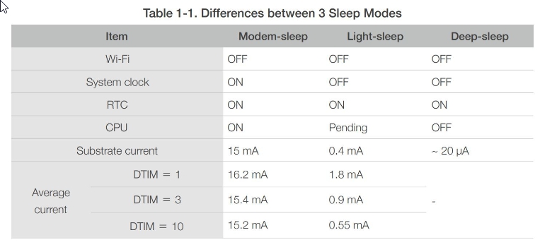

Hey all I am trying to see how long I can possibly have a ESP8266 ESP-07 operate with only 1 or 2 of the Lithium Ion Battery 18650 Cell which claims to have 2600mAh.
I am making a window alarm sensor and I'm looking to incorporate a window reed switch in order to check it's status via the ESP8266 and if its opened (meaning the window is not closed) then send something via WIFI to a REST service. Likewise, if the reed switch is not opened (meaning the window is fully shut) then sleep.

It would seem that using the ESP8266 along side an ATTiny85 would make it last longer since I could check the status of the reed switch via the ATTiny85 and if it see the window closed then pause and check it again in 1 minute. If the ATTiny85 does see the reed switch opened then start up the ESP8266 and send the info via WIFI then go back into deep sleep. However, I am not sure how this would be on the battery side of things - if it would be less or same or more.
I'm looking to see how long 1 and/or 2 of the Lithium Ion Battery's would last (in days) with using just the ESP-07 and also using both the ESP-07 and the ATTiny85 as explained above.
I've done some googling and found a few websites that show how to put the ESP-07 into deep sleep mode but really wouldn't say how long it would take with my setup above. Most were using standard AA or AAA batteries.
The overall goal is: Have the window alarm power last at least 1 year.

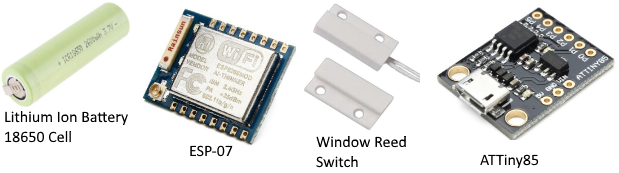

The items:
The battery ESP-07 consumption chart I found:
Datasheets:
ATTiny85
Window Reed Switch (Generic) or Mouser (Generic)
ESP8266 ESP-07

You may be able to completely remove power from the ESP module when it's not needed. The attiny could switch a MOSFET to turn it on.
