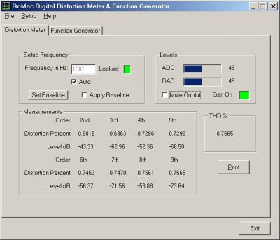

I also found these free evaluation programs that uses your PC sound card as a distortion analyzer. This may help you to adjust the triangle to sine stage for minimum distortion if you don't have access to a distortion meter.
http://romacsoftware.com/MeterDefault.asp
or http://shmelyoff.nm.ru/
