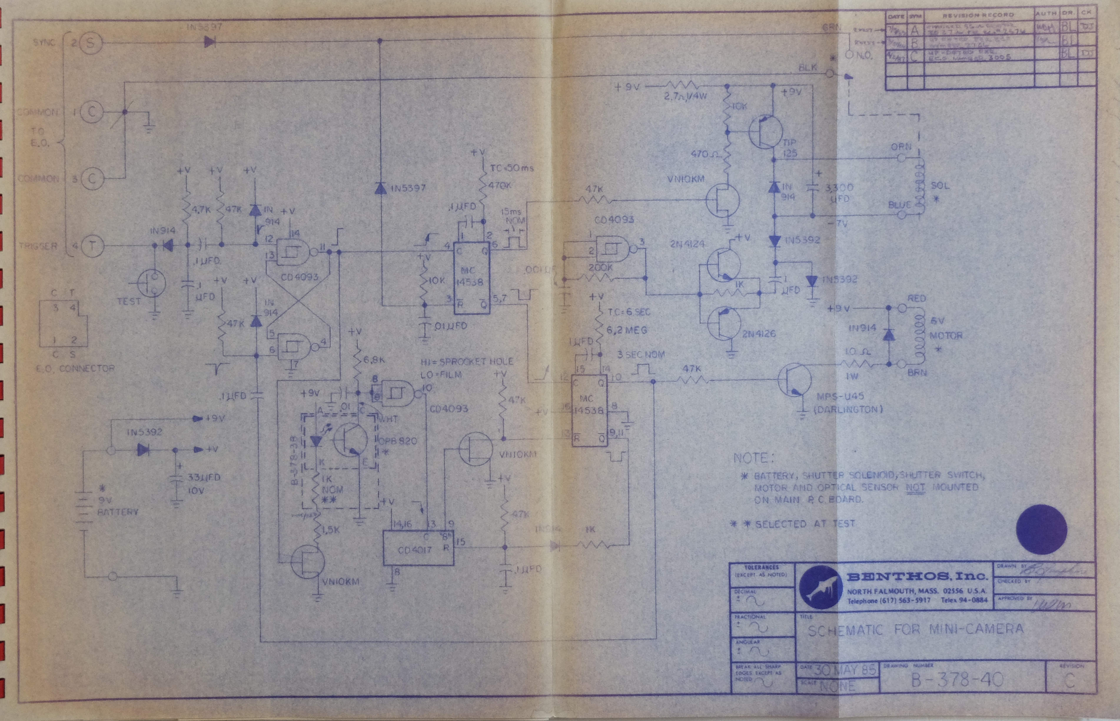

Hi shrtnd, thanks for the quick reply. I reached out to the manufacturer but they have not been very helpful because they stopped producing this camera 10+ years ago.
I photographed the schematic from the manual and have posted it below (direct link- http://content.vickysabourin.com/DSCF4120.JPG)

In post 4 you mention short pins 3 and 4 together to trigger the camera. Looking at the circuit it will supply a short trigger pulse at the front end. I guess this is how it should work?

There is already a TEST push-button switch that is part of the camera circuitry. This switch shorts pins 3 and 4 together when it is pressed. Try pressing this switch to see if there is anything wrong with the circuit before adding a few hundred feet of cable.

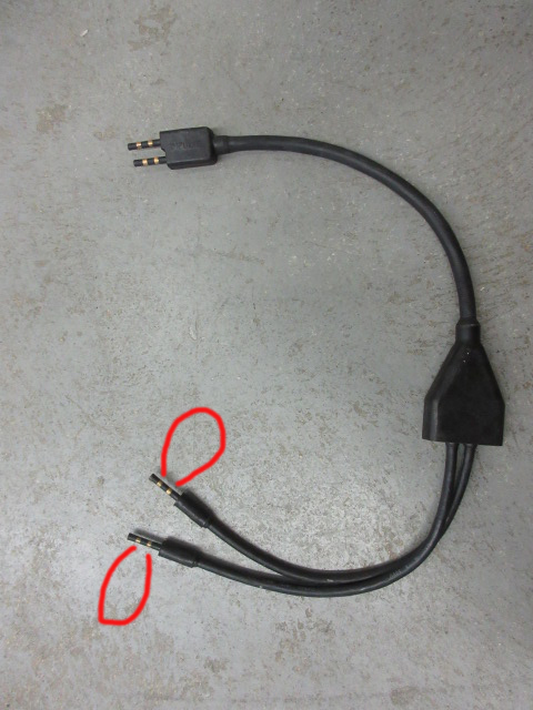

hello Hevans1944. Thank-you for responding. I have used the test button and the camera operates properly.
I just tried shorting pins 3 and 4 using a small bit of wire like this-
With the top double connector attached to the camera. No luck. I could not get the camera to operate.
Any other suggestions? Did I go about shorting the pins correctly?

Providing all conductors in the cable are intact (have you checked with a meter?), and the contacts on the plugs and sockets are clean, then shorting the contacts that go to pins 3 and 4 should trigger the camera.

Hi Alec_t - I can confirm that the conductors in the cable are intact. It is difficult to check the contacts in the socket but I have tried my best to clean them. I am still not able to get the camera to trigger via the cable.
I hate to be dense, and I appreciate your patience. But can you please confirm that 'shorting the contacts' simply means touching the two contacts together? I do not need to add an additional power supply or anything else? Somehow it seems strange to me that the power from that little 9-volt battery could travel 200 meters up a tether be shorted.
I may be grasping at straws here but I am hoping there is some other piece of the puzzle!

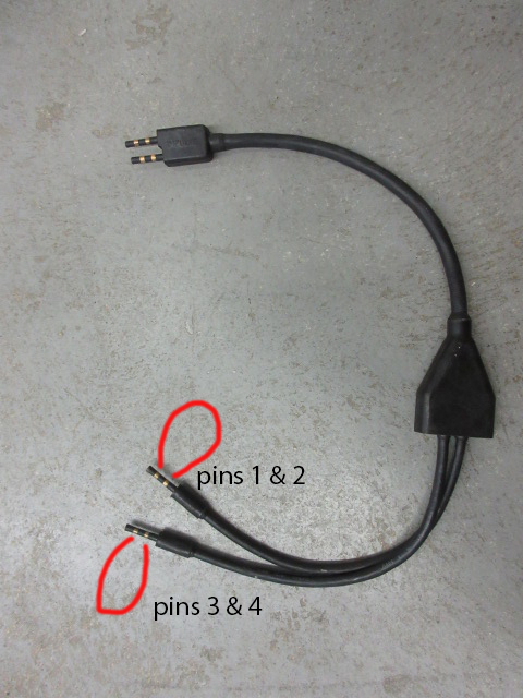

I wonder if the part in bold below may be the problem-
3.1.2 BULKHEAD CONNECTOR PINS
A four pin underwater mateable connector is used to control the operation of the camera. Pins 1 and 2 are the sunc connections for firing the strobe light. Pin 1 is common, while pin 2 is connected to the strobe's positive lead. Check the strobe polarity as reversing the sync leads will cause faulty camera operation.
Pins 3 and 4 are the input trigger connections, 3 being common and pin 4 the trigger. To trigger the camera, pin 4 must be shorted to pin 3.
The camera is designed to be used with strobe lighting. I wonder if the problem is that I am not using it with strobe lighting. Is there some relationship between having "pin 2 connected to the strobe's positive lead" and the camera operating properly?
Nothing else. Just bridging the two contacts on that lower plug with a piece of wire should do it. If it doesn't, then it looks like there's a problem with the camera [Edit: or its connector].

The schematic indicates that leaving the strobe disconnected won't affect the camera triggering.
Check with your meter that pins 1 and 3 show permanent connectivity with the cable connected.
