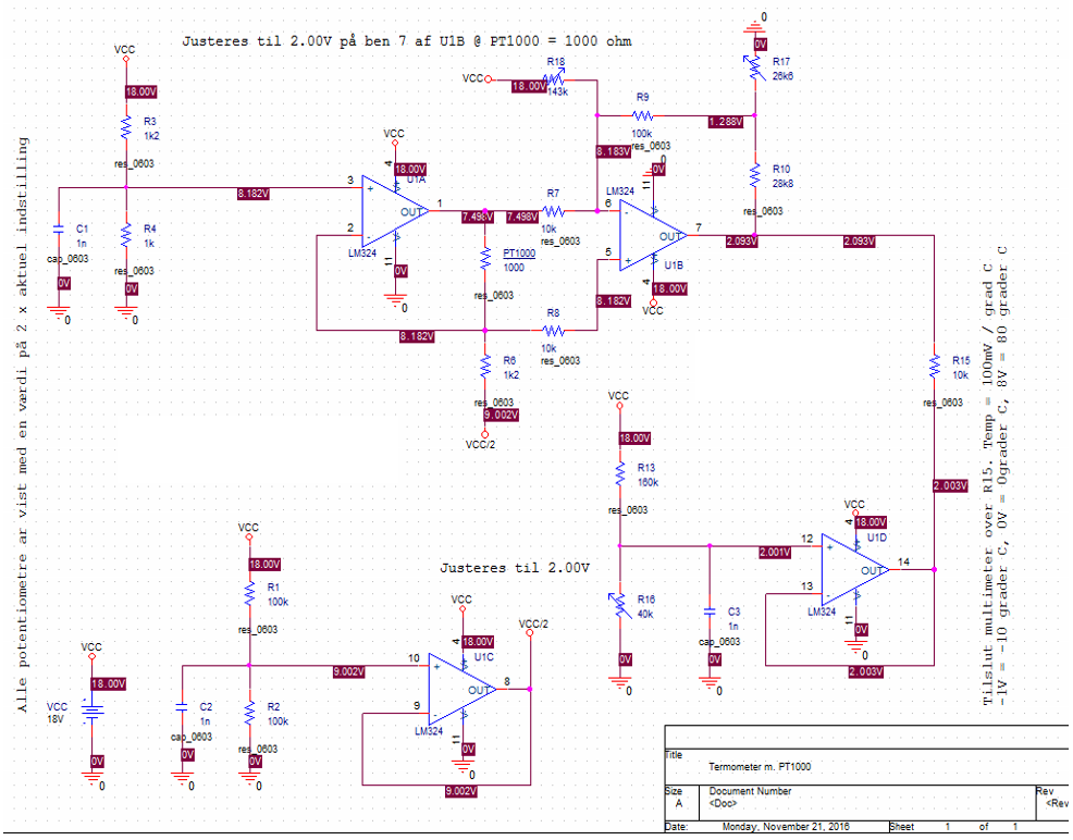

Help me design a water heater circuit that automatically turns off when the heater reaches a bouling point of 100 degrees centigrade and automatically turns-on when it cooled down about 80 degrees centigrade, include a potentiometer to calibrate the temperature

Use a SSR to control the immersion htr and a thermostat in the low voltage side.
Alternatively you could use a relay in place of the SSR.

You need to be very careful about setting the upper temperature to 100°C. If inaccuracies or drift cause it to increase, you may have the problem of it not turning off.
Setting the upper limit to (say) 95°C can save you headaches and energy.
Heating water is not exactly exotic, you may be able to find a mechanical thermostat which will do what you want relatively cheaply and certainly more easily.

All electric Kettles I have seen have a thermal switch above the water. This does not switch off untjl it is heated by steam thus a temperature setting of about 95C is good enough.
The switch is an overcentre type and needs to be reset. This is to allow a fast contact break. The one I use now will only reset in mains is present.
I would not play with a switch immersed in water or steam.

I made this thermometer circuit in the previous years school term, you could quite easily modify/add stuff to do what you want..
