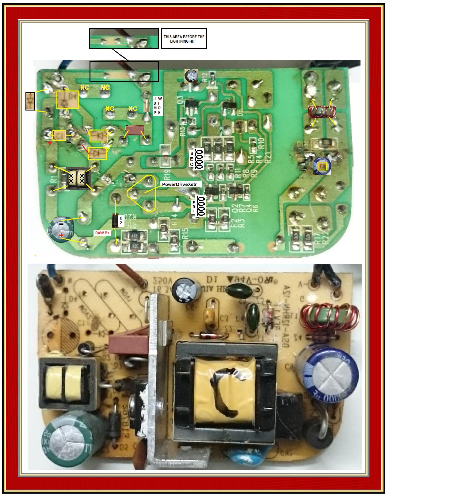

Check the diodes, and also the mosfet.
I'm not sure if there's an on-board fuse, but the failure of a rectifier diode is something that can cause catastrophic failure of the 400V capacitor -- and this one did not die a slow death. This sort of failure often results in a fuse (sooner or later -- depending on the topology) blowing.
What does that brown rectangular component between the dead cap and the heatsink have printed on it?
And did you remove the MOVs?

Sir pharaon . . . . . . .
The MJE13005 is a high voltage, hi speed switching, NPN bipolar transistor .
Looking at the AC power half of the board at at D7 and D8 diodes, over towards the smaller ferrite cored transformer . . . .do I seem some carbonization deposit ?
Also under very bright lighting and magnified examination . . . are there any floating solder ring joints in the power transistor area ?
Seeing the way the 5.6 was used in the units circuitry , I would also suggest subbing in another cap, in place of the mentioned green one.
I see board marked provisions for two unused MOV1 and MOV2, but at the BROWN wire AC line input, isn't there a foam blob covering up your AC line input fuse ?
yes i was soldering the capacitor legs to the board
no there is not
you want me to change the green cap" 10uf 400v"?
yes but it's just wire

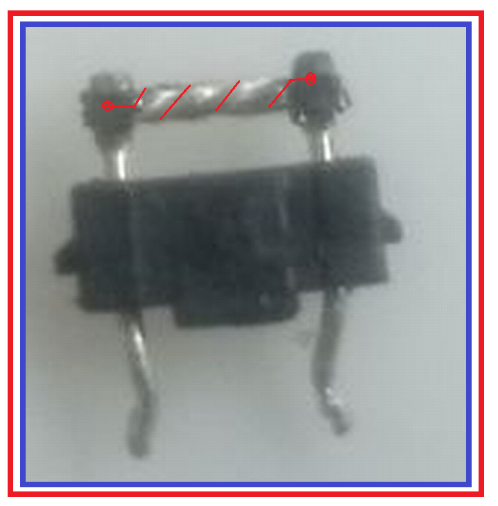

Confirm if 2AL. 250 might be a blown 2A slow blow chemical fuse, since the other was a jumper wire.
Can you "remote" that new PHYSICALLY LARGER electrolytic with leads or use another full leaded length one temporarily.
You have 2 diode leads now pressed right up against its 5 mil insulative film . . .then they are susceptible to making contact with the aluminum outer shell of the electrolytic .
Typically you would suspect those four diodes as being the raw DC power source to that blown cap that you replaced.
Taking out any series fuse . . . . as is being described.
  • THE FUSE:
What are the chances of that being some polypropylene "rope" being affixed between the opposing posts and some fusing wire having been routed in its furrows as shown in RED.
Which now has vaporized . . .excepting some possible remaining wire tip blobs.
Since you provide GOOD photos, how about just almost completely filling up a screen with a straight top on and straight bottom on shot of the component and the foil side of that board .
I want to confirm either:
Its being either Power oscillator related / or / symmetrical AC power line choke function . . .for that smaller ferrite cored transformer.
Currently . . . . I'm HEAVILY leaning towards it being the latter.
Are you almost ready to get the test ball rolling with the sub in of a 60W incandescent lamp, connected in circuit with use of test leads , to shunt that pulled fuses solder in terminals.
Then do an ac power up test.
Expecting a short dim activation of the lamp on turn on.
And if it was working expect there to be a residual, declining DC voltage at the other half of the boards output section.
Just now noticed your RED CIRCLED diode with its lower forward voltage , don't worry, that is being on the "cold" / AC isolated side of the PCB and is working at HIGH switching speeds . . .thus the use of a Schottkey family of diodes in that application . . . . which have that lower forward voltage characteristic.

Using your supplied photos for this back / front board markup:
I see you finding 2 of the four diodes used in the main power supplys Full Wave Bridge circuitry as bad units .
In my finding of that situation I always get four of a kind of the same diodes and replace all four . So that they will be matched to each other.
If they are readily available to you, I would use four 1N4007 diodes. Save the two old diodes that are good and you can use them in the future, in circuitry where only one diode is used.
When you test with the lamp in place of the RED fuse there is a good possibility that during that dull red glow of the lamp that enough power activated the power transistor that it started
to generate some voltage for the secondary large filter capacitor. Measure to see if there is still a little charge on that capacitor,whereas there would have been NO voltage on it before.
I would then attempt power up with a conventional 1-2 amp used in place of the special RED fuse .
Looking at all of your board, and now knowing of some of its failed parts, I think that your power line experienced a lightning strike VERY near to your house and popped these parts.
Hopefully . . . . none of the somewhat more isolated parts on the secondary circuitry were affected .
Your boards F / B markups:
Around your already replaced parts and parts to be replaced:
Can you use some denatured alcohol and a brush to clean the area that you are going to solder on, use a drop of Rosin flux on the joint that you are going to solder and be sure that your soldering iron tip is well tinned and shiny every time before making a solder joint.
Then you use the denatured alcohol again after soldering to immaculately clean up that soldered joint. Then you will have done a PERFECT job.
