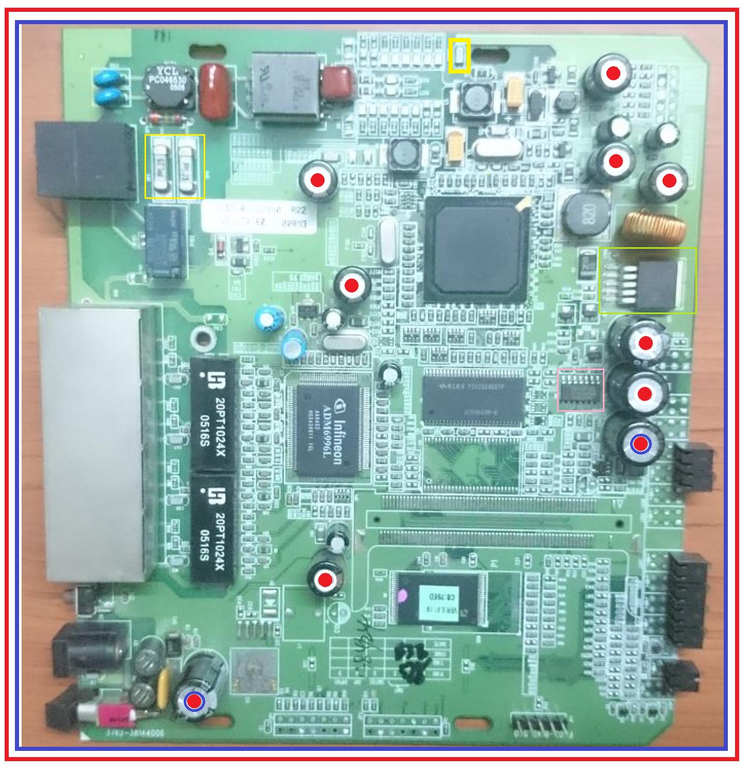

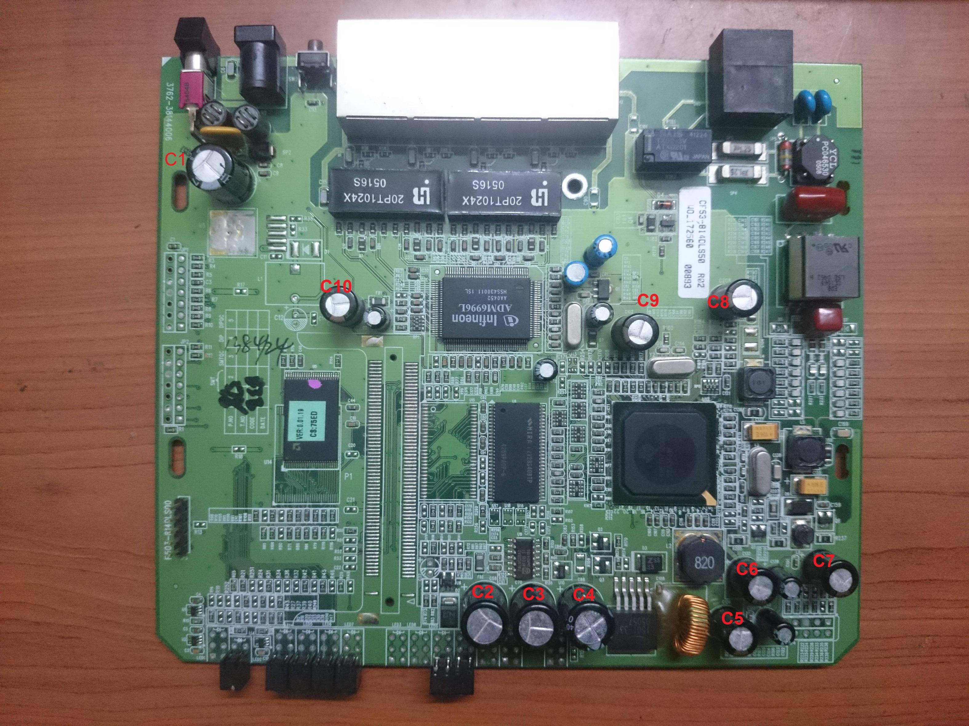

help repair router..no respond for power
pharaon
Oct 28, 2014
458
Oct 28, 2014
458
no respond for power the front led dos not light at all...i tried to re-solder those tow blue capacitors in hope it will work but nothing..hope you can guide me to find out the issue and fix it

I don't see any physical faults.
Have you confirmed the AC-DC Adaptor is working properly?

Sir pharaon . . . . . . .
This one may be bordering upon the impossible, unless its power generation / distributiion related.
Seems to be about a 2005 vintage unit . . .right ?
First check the white ceramic cased rectangular fuses within the left YELLOW rectangle.
Confirm, if I am correct,that the other YELLOW box is being a smaller fuse . . . . .could, instead, be a monolithic block capacitor instead . . . . since this is not being your usual excellent picture.
Isn't this a 1 in and out loop, providing 4 drops for distribution ?
Pass us the Mystical Magical Power converter numbers on the case of the LIME GREEN box and its associated IC in the PINK box.
Power up the unit and expect your power pack input DC voltage to read also at the first RED-BLUE electrolytic capacitor.
Also see if, or how many of the RED circlecapacitors read a DC voltage being across them.
That's being a start for now.

pharaon
Oct 28, 2014
458
Oct 28, 2014
458

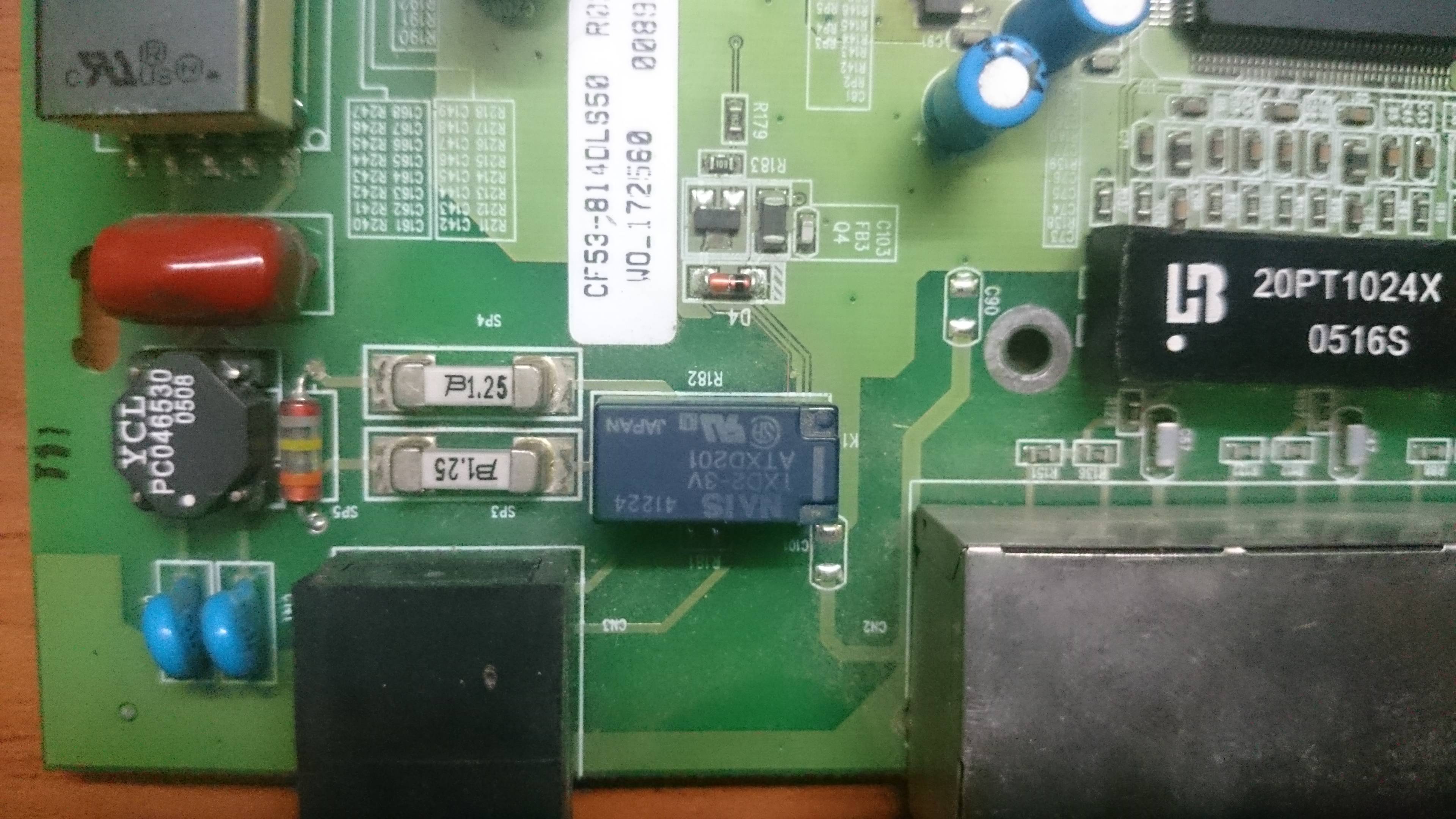

they are working fine
it's capacitor
what do you mean?
i don't know which LIME GREEN box or how to get the Mystical Magical Power converter numbers..i toke more pic hope it will help

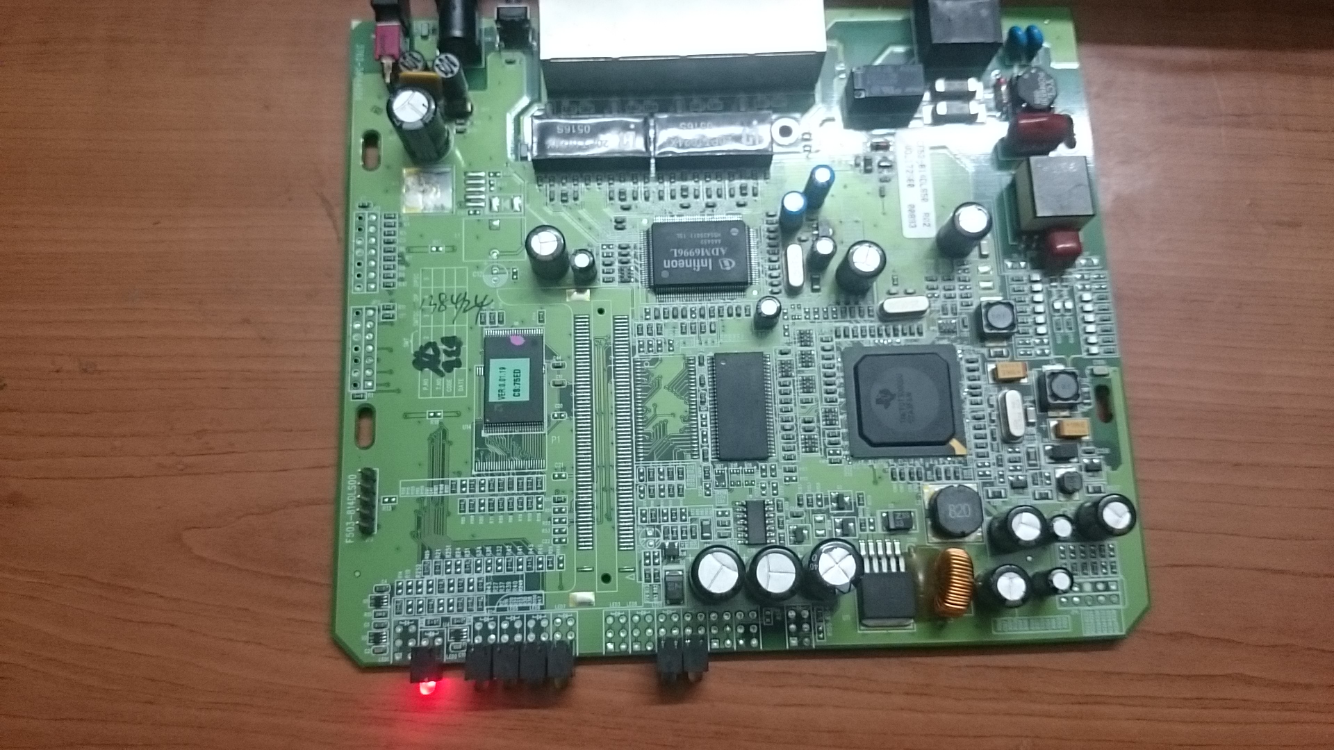

i notice some thing
when i turn it on the power led light in red instead of green for little period of time before it get off and this thing inside the red circle get extremely hot and smell like burning
C1 = ±4.2
C2 = ±3.7
C3 = ±4
C4 = ±4
C5 = ±3
C6 = ±1.4
C7 = ±3
C8 = ±3
C9 = ±1.4
C10 = ±2.9
the last image for the red light that last for few seconds before it dim

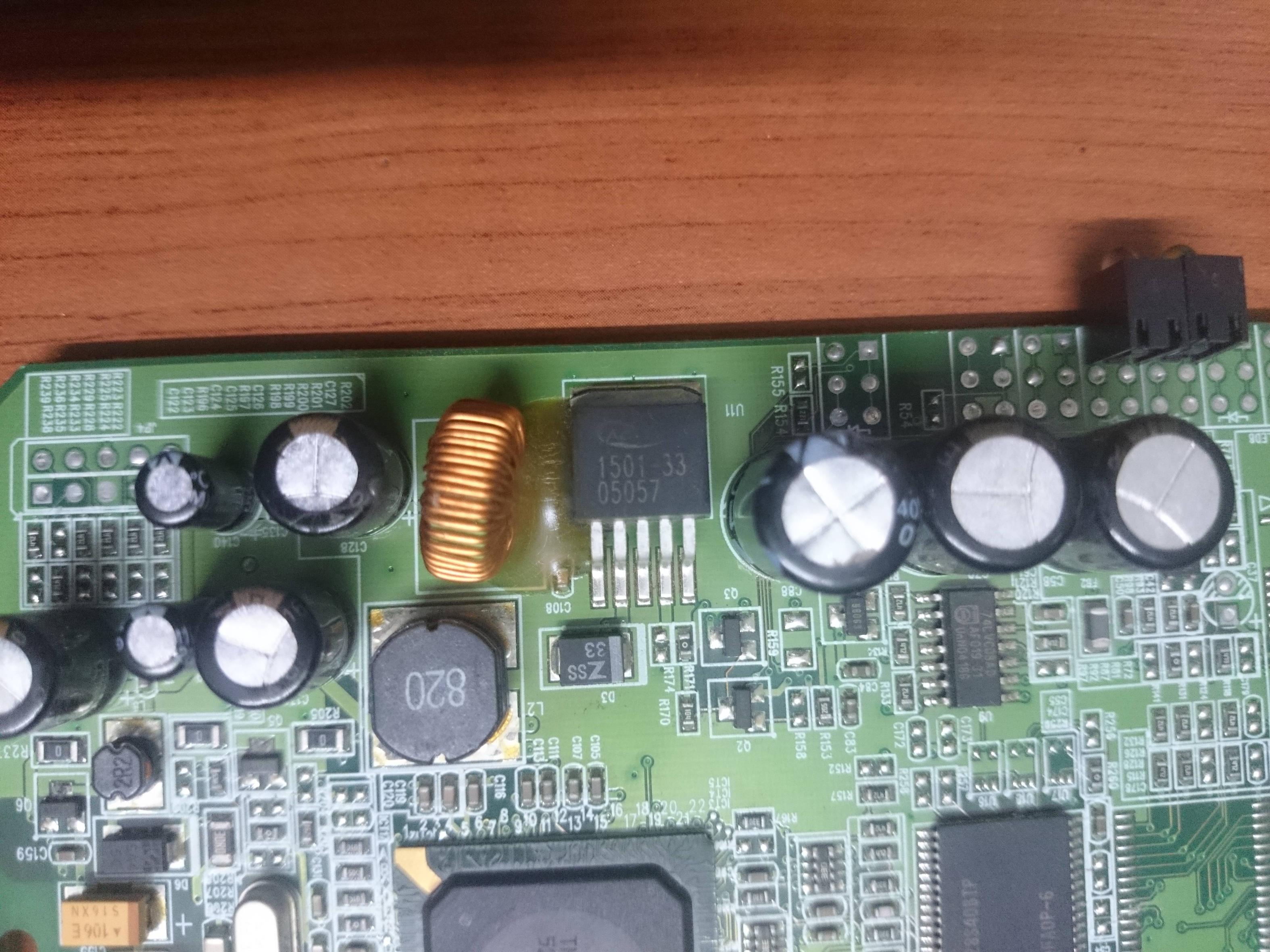

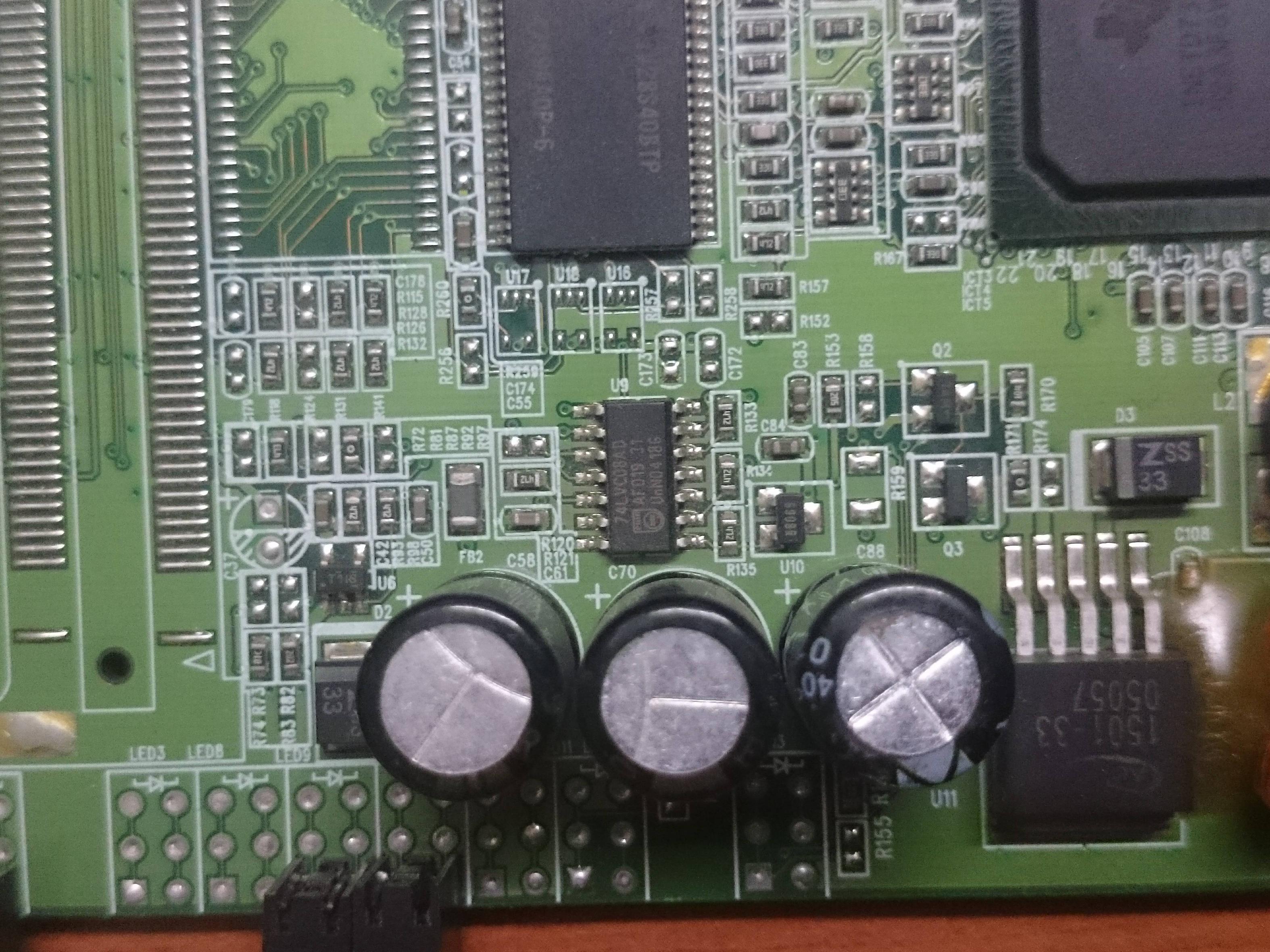

I can see it better now, using your added pictures . . . . . what I meant, is that there is either a DSL or CAT-5 connector that comes into and out of connector CN3. While your router makes its 4 outputs on connector CN2.
Your good set of pictures revealed a lot for the "reading" of the board this time around.
Your 12----13 Vdc power supply voltage comes into the board at the power connector and is supposed to be initially, further filtered by the C1 E-cap, with the supply then routed down to the the C2-C3-C4 area.
I can now read the number on the 5 leg power IC I queried about, with it being an AP 1501 33.
That would be a 3.3 V @ 3 A buck converter power IC, which should be OK, as its just not presently receiving its minimum DC voltage input.
Looks like the lightning hit that damaged the power supply block, which you just repaired, ALSO carried itself into this board and "crunched " the black, surface mount, surge protector . . . . .item SP2.
It is a metal oxide varistor that originally was rated in the 18-20 volt range, but the lightning hit has damaged it, and it now THINKS, that it is being a 4 volt ZENER diode.
Here is info on that product, so that you can further Edd-i cate yourself on the device.
http://www.tawelectronics.com/sfi/sfi-catalogue2005-1.pdf
You will need to replace SP2, to get a same type of protection, in the FUTURE.
For the present, I think that you just might look outside to see that no storm clouds are being overhead and then come in and unsolder that defective SP2 unit from the board.
If you then power up the board again, I suspect that all voltages will come up to normal, and with input at your CN3 connector, you will see all of the winky-dinky-blinky LED activity lights.

AP 1501 33.
Meaning, when you pull that bad part to get a FULL 12 VDC into the AP1501 it should work.
As it is, the mere 4 VDC now available, is not being enough to let the part work..

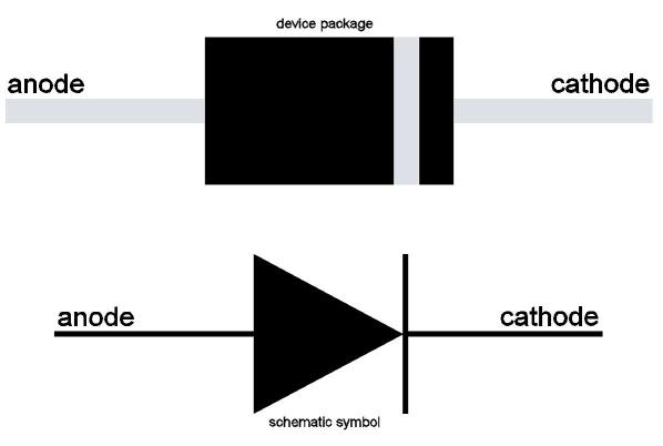

I think thaat we are on the same thought but just worded it differently with your use of "strip" instead of stripe.
In a diode the striped end is the identifier for the cathode with the unmarked end, left to be the anode.
As I mentioned, just have the striped end of the diode going to the power supply connection, and the anode going to the ground on the right side.
If the incoming voltage never exceeds 18 Volts nothing happens, it it meets or exceeds that voltage the diode starts conducting and bleeds down the voltage up to certain threshold where the Zener diode usually shorts out.

you told me the opposite in your previous share
If you can't get the same part, you would have to go old school . . . .before these devices ever came on the scene . . . . .and use an 18V 1 watt Zener diode .
Negative terminal to the ground plane and + terminal to the supply voltage side
so i think i put it in wrong way like this..the stripe side to the right which is the cathode the the ground side and the anode side to the left which is the power supply side
should i reverse the position of it and make the stripe side to the left?

I seriously doubt that this is a diode of any sort in this position
SP will not refer to a diode .. it's supposed to be an overvoltage protection device ... spark gap etc
putting a zener diode in there will be pointless

YES. . . .it is installed backwards.
Sir Dave must not have tuned in, back on page 1. Nor, being familiar on the parts supply in Cairo.
