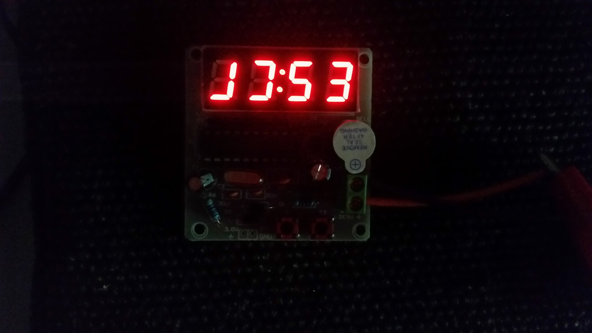

Hello all,
I put together this quite simple LED clock kit I got from ebay. When I powered it up it all works apart from 'D' segment being permanently lit.
I'm no stranger to hand soldering but circuits do confuse me a bit.
Any help would be great

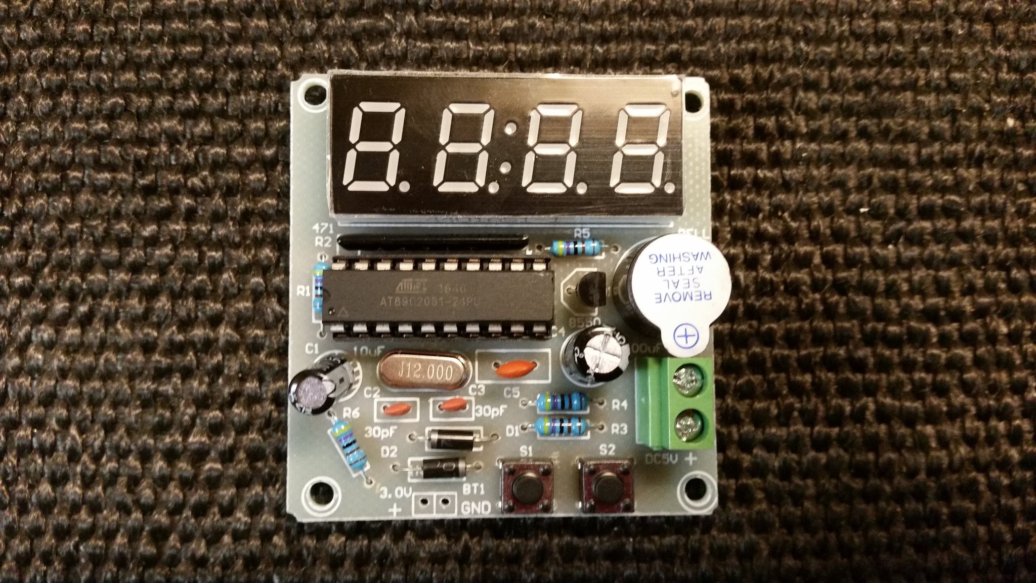

Welcome to the forum :)

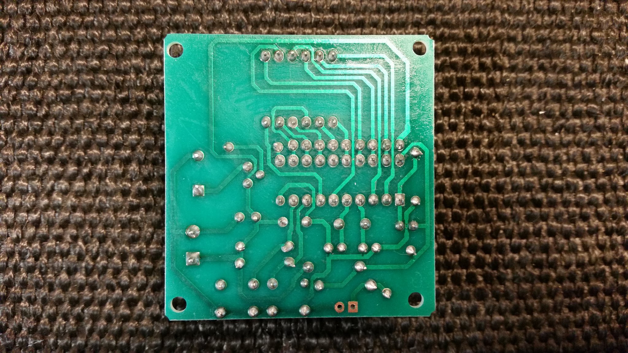

It looks to me as if there is a defect in the PCB provided.
Maybe Google for others who have had the same problem with your board. I reckon there must be a lot of other dissatisfied customers out there.
Pin 15 of the Atmel 89C2051 chip should connect to segment D of the display, but does not.
See how pins 11 to 19 all have a PCB trace to the resistor pack except pin 15...
If you are feeling brave, solder a tiny wire link pin 15 of the 89C2051 to the resistor pack pin just above.
(or return the unit as faulty if you prefer not to take any risks)
Hope I got it right - follow my advice at your own risk - I will not resolve any issues if I turn out to be wrong. Maybe wait to see if others reply either agreeing or disagreeing before making any changes.
Good luck..

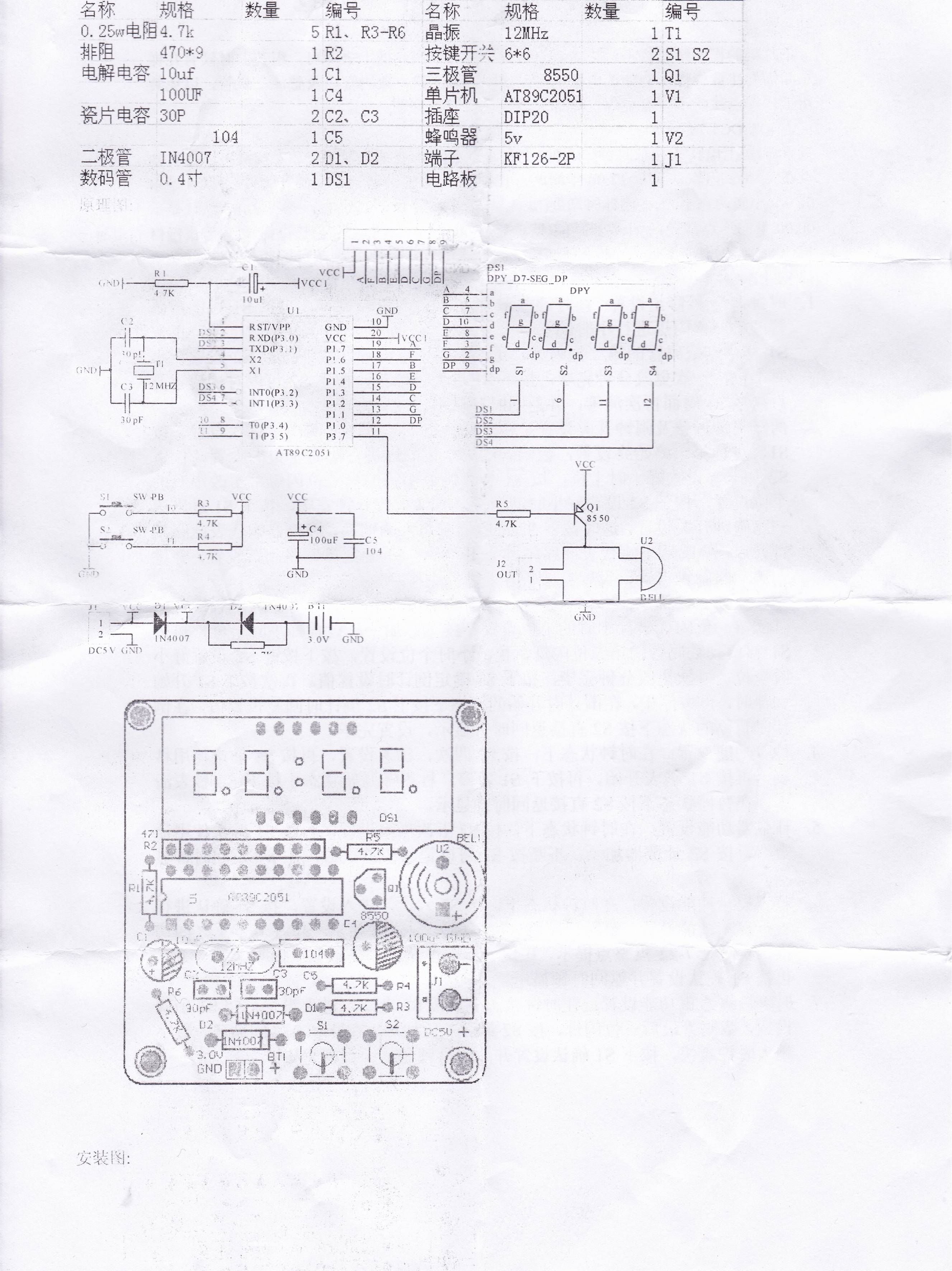

Please post something: the schematic, a link to the assembly manual, whatever.
ak
AnalogKid
Jun 10, 2015
3,056
Jun 10, 2015
3,056
The display pinouts in posts 4 and 5 are not the same.
Thank you hexreader, perfect advice.
Just added a blob of solder between the two pins and the clock is working perfect. Not sure how to set the different functions, but I am sure to work that out.

No sign of that intereconnecting foil link path having EVER been there.
Not being so chancy, I would have gone for an intermediate current limiting resistor initially.
The piezo needs its cover peeled off.
73's de Edd
It goes to a resistor, and keeping the sticker on is a old way of limiting the volume.
It all works, I'm happy.
