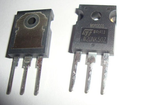

do you think its
W20NK50Z N-CHANNEL 500V -0.23 OHM - 17A

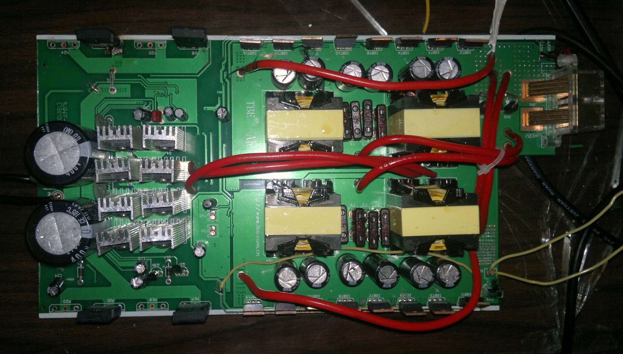

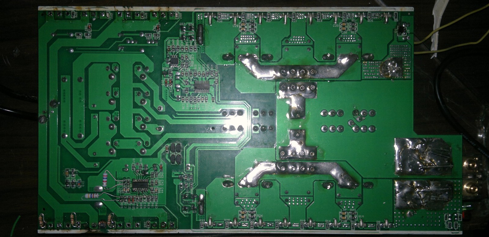

Are all the gate connections (I would have thought there would be 4) connected to just 1 pin?
The gate connections are hard to see on the board images because they're in the painted region at the side of the board, or because they go through vias.

I have no idea if it's a W20NK50Z or not. Nor, at this stage do I know if it's a suitable replacement.
I suggest the chip that's blown is the immediate concern. If we can figure out what that is, its datasheet might tell us what ratings are required for the mosfets.

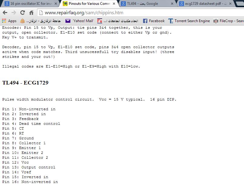

Hi everybody I think I got it
what is unique about this ship that its 16 pin and after a good look on the board i found that GND was pin 7 and power was pin 12 !! and I am nor sure about other things, I googled the pin outs of famous ICs in this website http://www.repairfaq.org/sam/chippins.htm
then I found this:
I downloaded the datasheet of TL494 and It happened to be PWM IC used in power supplies
what is more that I found that the CMD version is exactly the same as the ship we are looking for with a unique bevel in one side of the IC not in the other side.
what do you think could it be the one????
It could be. Perhaps if you followed my suggestion of tracing back the gates to the chip we would have a better understanding. SO fat you've only come up with 1 pin. That is very unlikely to be right considering that there are 4 pairs of mosfets. There will be either 2 or 4 pins on the chip used.
A TL494 is an option perhaps, so after you've confirmed whether or not that gates connect to sensible pins for the TL494, you can look at some of the other surrounding circuit to see if that too makes sense.
After that, if it is indeed a TL494 we can look to see what other components might have been at risk.

Thank you *steve* you know its difficult to trace the connections with tiny components and a board printed on both sides I will give it a harder trial trying to trans-illuminate the board to have a better look at the connections and come back to you.

One option is to use your multimeter to check if a long and winding trace ends up where you think it does.
It's possible there may be drivers or level shifters along the way, but from what I could see there wasn't much.

I got it now:
for sure the driving pins are 11 and 8, pin 11 is connected to 2 fits at one side and 8 to the other 2 at the same side, the other four fits on the other side are controlled by a two diodes each connected to the the AC output, I used my multimeter as you suggested, I think we are on the right track, Thanks *steve*

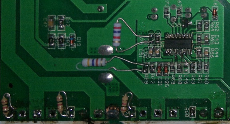

Update 1
I managed to get the TL494 I fixed it in place checked the surrounding components, there was a couple of resistors needed to be replaced, I also removed all the mosfets (7 of them) 2 turned to be shorted and one completely cutout, and I was left with 4 working mosfets, I decided to fix each of the 4 at each arm of the H bridge, and replaced 3 of the resistors at the gates and Its working again, I tested the inverter with a phone charger and its working with the green light on, the multimeter red 240 volts AC, I didn't try to load it as the heat sinks still not fixed waiting for the rest of mosfets to arrive.
and here are the pictures

Sounds good. Are you going to get some smd capacitors tho replace the through hole ones you have used there?
