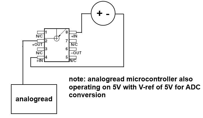

This is probably going to sound weird but, this has been bugging me the past week. In my senior engineering class, we are designing a pressure sensor circuit that will measure the changes in air bladder pressure when more force is acting on it. The theory behind it is, when more pressure is applied, the higher the voltage output on the sensor, where less pressure applied yields a smaller voltage output.
I have a pressure sensor circuit (SM5420C) that we are using a maximum voltage supply of 5V. at its base pressure for the device, the voltage output of the sensor goes to 2.55V. When more pressure is applied to the device, the voltage changes to become 2.57V. This is a very small change in voltage (20mV), and I need to see that change from a 0V to 5V range (where no/smallest pressure applied is 0 volts, and highest pressure applied is 5 volts).
I went on the approach of using a non-inverting Op Amp circuit:https://upload.wikimedia.org/wikipe.../300px-Op-Amp_Non-Inverting_Amplifier.svg.png but am having trouble dealing with keeping constant gain.
if the voltage did not start off at 2.55 volts (maxing at 2.57V), and instead just started right at 0V (maxing at 0.02V) so we see the 0 to 20mV range only, then the gain for a 0 to 5V range of desired output would be approximately 250.
getting the resistors for that based on the picture shouldnt be the issue. The issue is because of the fact that the pressure sensors voltage output, always levels out at 2.55 volts when no pressure is applied.
Is there a way to reduce the voltage output of the pressure sensor by 2.55 volts so we focus only on that 20 mV change? Would resistors be the trick to do so? Or would that also affect that 20mV range we are looking at too? What would be the recommendation of approach?

You are using the sensor incorrectly ;)
I looked at a datasheet, and I see 4 pins that must be used.
Which ones are you using?
(Look into how you need to use a wheatstone bridge. The datasheet, in addition to properly reading from a wheatstone bridge should fill in the missing puzzle piece for you)

I guess I could be wrong but it was my understanding that the +in and -in corresponded to the voltage supply, where the +out indicated that when pressure became applied, we would get a higher voltage, and for -out when pressure is applied, we get lower voltage.
Take a look at the sample image here :
Then take a peek at the datasheet for your sensor here :
http://www.si-micro.com/upload/product/pdf/SM5420C_40SP3551.pdf
Page 3. Pinout section. It should look similar to the above ;)
What ends up happening, is that sensor has a built-in wheatstone bridge.
What you are doing is measuring voltage at the + output, which will almost ALWAYS be very close to half the Voltage you apply because the 4 sides of the bridge will be closely balanced.
What ends up happening, is the + and - outputs need to be combined... the 'difference' between these two outputs is what will be useful.
eg... take a volt-meter or multi-meter and put the black probe on the sensor -, and the red probe on the sensor + and you will get a very small voltage on your meter!
You can do the same thing with an opamp ;)
Just find the difference between the two, then amplify and you are home free.

wow, this really helps a lot, (and made me feel like an idiot for forgetting about this haha, but ill work on that later). Thank you so much! Ill follow up tomorrow on if it has worked. Thank you again!

You didn't provide the complete part number for this Wheatstone-bridge piezo-resistive absolute pressure transducer. According to the Silicon Microsructures Incorporated datasheet this transducer is available in four full-scale ranges: 15, 30, 60, and 100 psi with 100 mV full-scale output.
The differential output is nominally zero with a ±35 mV tolerance using 5 V excitation when the applied pressure is zero. Note this is an absolute pressure transducer, so "zero" pressure is actually occurs when a good vacuum applied to the input pressure port. A full-scale range above atmospheric pressure (about 14.7 psi) is required to linearly measure your air bladder pressure, which starts at atmospheric pressure and increases from there. A full-scale range of 30 psi would seem to be appropriate. That would produce half of the full-scale output when the input pressure port is at atmospheric pressure.
The internal Wheatstone bridge configuration is not particularly well-balanced, so you will have to add an external offset adjustment to produce zero output with no pressure applied. Once the offset is zeroed out with the pressure port exposed to atmospheric pressure, the differential output must be amplified by a factor of 50 to produced a full-scale output signal of 5 V. Note the full-scale output is only 100 mV no matter which pressure range your transducer happens to accommodate. Fortunately it is "proof tested" to three times the rated full-scale pressure, so there is some room for gain calibration error without destroying the piezo-resistive strain-gage elements inside the transducer.
There are many different circuits available for bridge conditioning, which is the appropriate term to use for the offset and gain circuitry. Your transducer has rather high-valued piezo-resistors (5 kΩ), and moderate sensitivity. The "quick and dirty" way to compensate for offset is to parallel one of the bridge arms with a variable resistance that is much larger the arm resistance. A "quick and dirty" way to obtain the x50 gain is with two op-amps to produce a differential amplified output followed by a single op-amp to convert the differential output to a single-ended output. See image below.
images
You can often get by without an offset adjustment at the bridge if the gain of the differential input stage is set to a low value, say x2 or x10, so that the op-amp outputs remain in their linear range even after the offset voltage is amplified. The output op-amp would then require a gain of x25 or x5 to produce an overall gain of x50. The offset is then removed by injecting a small voltage in series with the "grounded" resistor of the output op-amp.
Read up on strain-gauge bridge amplifiers here. Commercial products are available but tend to be a bit pricey. I've always "rolled my own" unless a customer insisted on a fancy commercial product.

This explains a lot, sorry forgot to mention one using. We are using a 15 psi (Absolute) sensor. I did some initial testing again this morning and found that there would be about 50mV change in voltage, depending on the pressure applied (at least for when i connected the + and -Sig to a voltmeter).
But as you mentioned there is still an offset of about 0.17 volts that would need to be corrected.
i looked up into those strain-gauge bridge amplifiers. I came across a signal conditioning report by texas instruments that mentions the three op amp amplifier you mentioned as well as a single op amp differential amplifier. The single one though probably doesnt correct for that small voltage offset.
http://www.ti.com/lit/an/sloa034/sloa034.pdf
The three op amp instrumentation amplifier would correct for the offset?
So say that I want the output voltage at 5 volts, so in the form under the three op amp instrumentation amplifier, it mentions Vo = (Sig+ - Sig-)(R4/R2)((2Rf/Rg)+1). Say in the case that sig+ - Sig- is about 50mV when Vo is at 5V. then theoretically i can use that to find what resistor values for this gain.
You mentioned that one way to correct for the offset is paralleling one of the bridge arms with a variable resistance, would it be possible to correct for the offset within the Op Amp itself, rather just in one of the op amps in any case?
Thank you also very much for explaining all this to me! This has been bugging me all week.
