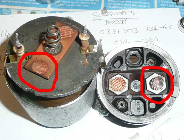

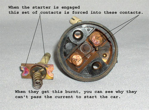

I would think that a FET solution would be cheaper than a solenoid but the car makers use a solenoid. There must be a reason for this.
A dismantled solenoid will show how severe the duty is.
Here you can see a dismantled solenoid switch.

Reason you have problems is the solenoid is completely shagged. Along with the fact that Chinese GY6 is an elcheapo pos. Note zero contact coating, just bare copper which has discoloured from the heat and likewise effect on the release spring. Cleaning contacts like shown in the video might get you mobile one time but it definetely will never last or be looked at as a "repair that avoids buying a replacement". Youtube has many good aspects but there is a lot of bs displayed there as well. With all this though, fit a new one. You will find a $5 solenoid much more economical than an array of suitable mosfets let alone the cost of your finding out the realism of how many you actually will need.

Almost all the solenoids available does not have special contact coating. Even the most expensive one has the bare copper plate which gets discolored because of arcing. I provided these pics and videos because Davenn wanted to see the dismantled solenoid otherwise, I am concerned about the winding of the solenoid which draws about 3A and get burned after sometime. Therefore, I was looking for some solid state replacement of the solenoid relay.
