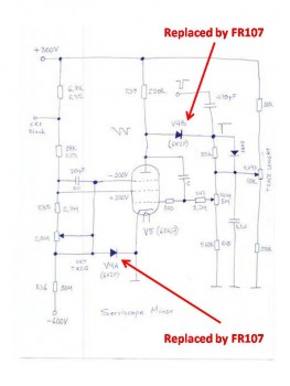

- Vacuum diodes from the sweep generator are now replaced by FR107 S-S diodes. (this is a betrayal to the Gods of Vacuum Electronics too, I'm a heretic)

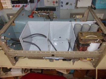

The first problem to solve was induced noise. To solve this I built a steel chassis, with shielded compartment for the diferent sections. Y amplifier, X Sweep, and Transformer-rectifier-filter are in the upper part of the chassis, shielded from each other by a steel wall.
PSUs and multipliers are bellow the chassis. This chassis is made using 1mm thick steel sheet. The parts are riveted. Here a picture of the chassis.

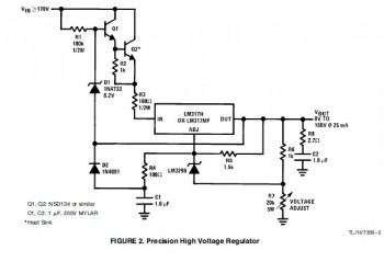

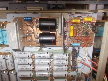

This is the basic circuit that I used for the HT PSU. I did some changes. Instead of LM317, I used LM7815, and instead of LM329, I used a 15V Zener diode with a 1N4007 in series, for temperature compensating.
Resistors are adjusted for my purposes. The circuit is supplied with 340 to 355V DC and it delivers 290V DC regulated. Two MOSFETs are connected to the output. one for the Y amplifier, and the other for the sweep generator. A voltage divider with suitable resistors and another MOSFET at their junction, provides the 150V which are also required for the Y amplifier.
http://www.imagebam.com/image/e3df6c350675235
This circuit is from National Semiconductor Linear Brief 47 (1995)

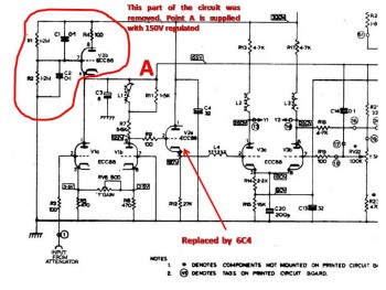

So, the Y amplifier, as said, is that of the Telequipment S51 oscilloscope, with minor changes. Here the circuit with the changes in red.
http://www.imagebam.com/image/bf919a350660473

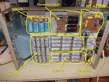

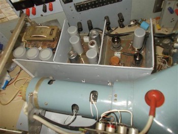

The mains transformer is mounted at the last compartment of the chassis; while the other two are intended for the Y amplifier and X sweep generator. The transformer is a Soviet TCA-70 core with factory-made primary and several home-made secondaries.
The three big capacitors seen behind the transformer are 220uF/500V and they are the filter at the rectifier output. 100 ohm resistors connect the capacitors to each other. Bridge rectifier is made with 1N4007.
The black cables that you can see on the first and second compartment are for the Y and X shift potentiometers.

Miguel, I should show you some of the construction work I'm proud of. It almost makes me cry in shame after looking at yours.
I'm interested in why you don't have a reverse biased diode across the 317, or indeed the entire high voltage precision regulator to protect the base-emitter junctions from a sudden loss of the high voltage input?
I suspect the load may not be highly capacitive, but even your small output capacitance could cause damage to these junctions.
I assume that it's for radiated noise reasons that you don't employ a switching pre-regulator.

I didn't used the diode cause it is not on the original schematic. Now, I see that you're right and a reverse voltage could damage the regulator. I will include the diode. Thanks. I thought that the Zener would be enough for this, but I understand that this Zeners do not stand too much current. To include the diode is not a big deal, so I will.
By the way, I found the original circuit among a lot of Application Notes sent to me by some guy who lives Mid way between Beijing and the Ronne Ice Shelf. If you see him someday, please thank him for me.
I do not use a switching regulator by several reasons.
- Noise surely is one of them, but not the most important.
- Lack of parts
- Lack of knowledge.
- Simplicity.

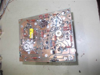

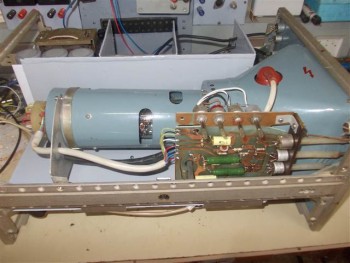

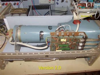

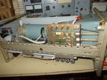

Well, the Version 1.0 of the scope was a mess regarding the CRT wiring. That is something I corrected this time, using a PCB. I placed all of the CRT circuit on a PCB located besides the mu-metal cone. I placed directly on it the brightness, focus and astigmatism potentiometers that were point-to-point wired on the previous version. The four potentiometer to control several aspects of the CRT: i.e: curvature, amplitude, etc are now placed on the same PCB and the wiring to the CRT socket is more neat.

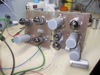

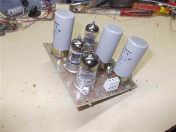

The next step is the X amplifier and sweep generator. As said before I used the Telequipment Serviscope Minor circuit with minor changes.
The X sweep generator is to the left. Sorry, I took no pictures of the X section alone.

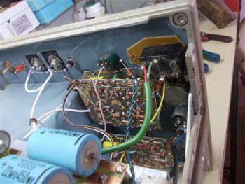

Now a picture of the scope with both the Y and X circuits on their respective places. Finally I removed one of the valves of the PCB cause X output doesn't need to be simmetric.

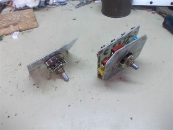

With PSU, CRT, X sweep generator and Y amplifier on their respective places, there's nothing else to do but adjust both time and voltage ranges. On Version 1.0 I used point-to-point wiring and there was a lot of wires eager to get induced noise on them, so this time in order to reduce that mess, I used PCB too for the range selection.
The better way I found, it was to attach the PCB directle to the selector pins. (see the picture). The Y ranges (voltage) requires just one PCB as I just need to change resistors for the voltage divider. It is not frequency compensated cause I do not intend this scope to be a standard, maybe for a Version 3.0...........
The X range selector requires two PCBs as I need to change resistors and capacitors, so you can see in the picture the way I found to do this. Very simple, one PCB on each section of the selector, and the use of small caps to fit between the two PCBs.
Step selectors with attached PCBs
http://www.imagebam.com/image/e75df7350683733

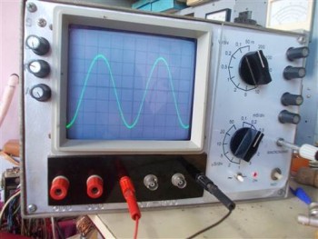

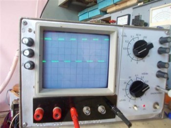

Here is the front panel. I used the same as in Version 1.0. The markings are made of a photograph, designed in Photoshop and then covered by a transparent plastic piece.
Ranges in voltage are [V/div]:
50m, 0.1 0.2 0.5 1.0 2.0 5.0 10 20 50 100 and 200; plus two adittional fixed ranges of 300 and 500V/div. I intend to use this scope to work with vacuum circuits, so I need to measure high voltage.
Ranges in time are
[mS/div] 5 2 1 0,5 0,2 0,1
[uS/div] 50 20 10 5 2 1
The screen is covered by a blue piece from the original C1-99 scope.
