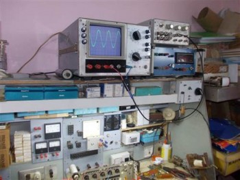

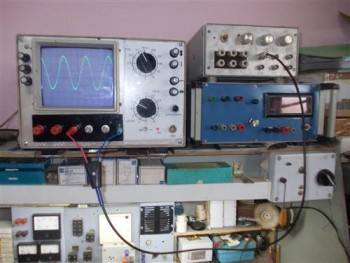

That's a fine bit of work you've done there.
I notice a slight rotation of the display. Is the tube not quite straight or is there some other reason?
Indeed it is rotated cause when I took that picture the correction coil was not connected yet. The mu-metal cone has a coil around the neck to correct the trace horizontality against deviations due to the CRT tolerances and the Earth magnetic field.
I connected this coil to the 18,9V for heater PSU, and it is adjusted via the small potentiometer above the three CRT controls (upper-left corner). This pot can only be screwdriver driven.
