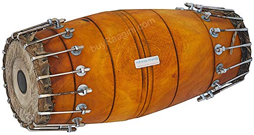

I plan on making a compact version of a musical instrument called Mridangam (an Indian musical instrument). The original instrument is pretty huge and there are different variants of it to produce different kinds of sounds. Hence, I want to make a miniature version of it and also want to change the functionality of the instrument from one variant to another by using a switch. I want to be able to control the sound of the instrument based on the force exerted. I plan on using an stm32 microcontroller. Can anyone give me an idea of how i can go about implementing this project? How can I produce the different sounds of this instrument and how to go about doing the signal processing?

You should start by making friends with a search engine called Google. Try visiting some of the links on this result page which popped up when I used the search string "electronic percussion instruments." Oh, and by the way, you failed to mention that a Mridangam is basically a double-ended drum:
So that begs the question: what will an electronic version look like? How does one play the electronic version? It appears that the drum heads are slapped by the open palm, or maybe hit with a closed fist, in the original version. An electronic version will likely require two (or more) percussion pad sensors, which are available in many types. If this were my project, I would start there and select a sensor before diving into electronic synthesis circuits.

More information on the Mridangam, for those of us here on EP not familiar with the instrument or the culture from which it is derived, can be found on this Wikipedia link.
