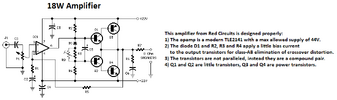

This is circuit diagram of powerful audio amplifier. This circuit is given by Emmanuel. In this circuit one ic 4558 and 4 Power transistors are used with some discrete components. Use 20v-to 60v for operating this circuit. This is a single channel audio amplifier circuit. Use capacitor of minimum 50v value. Positive supply voltage is given at the middle pin of both transistor TIP41C and D718. Negative supply is given at middle terminal of D688and TI42C Transistor. R1 is the variable resistor potentiometer for volume control. This vol. control may be value of 50k to 100k. Use Big size speaker with this circuit. 4558 Audio Amplifier Circuit Diagram.

The circuit shown is a block diagram, not a schematic. The inputs and outputs of the opamps are not shown and the collectors, emitters and bases of the transistors are not shown.
An important capacitor between the positive and negative power supply pins of the IC is missing.
Diodes or a transistor to bias the output transistors into class-AB is also missing then there is severe crossover distortion. The volume control is wired backwards and shorts the signal source. The transistors are not connected as a Darlington, they are simply paralleled, why?
Hey, the amplifier has no specifications about its output power or distortion, the impedance of the speaker is also missing.
The datasheet for the RC4558 by Texas Instruments recommends a maximum supply of plus and minus 15V then why does this circuit have supply voltages that are twice too high?
With a plus and minus 15V supply, the maximum output voltage swing of the opamps is plus and minus 12.5V and the output transistors reduce the amplifier output to plus and minus 11V which is 7.8V RMS. Then the output power is only 7.6W into 8 ohms or about 13.7W into 4 ohms.

I am showing a CORRECTED audio amplifier circuit and a CORRECTED simple inverter circuit:
